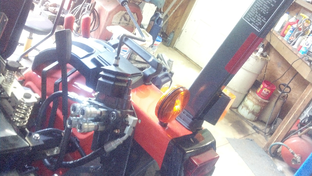

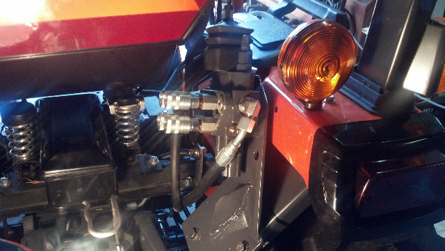

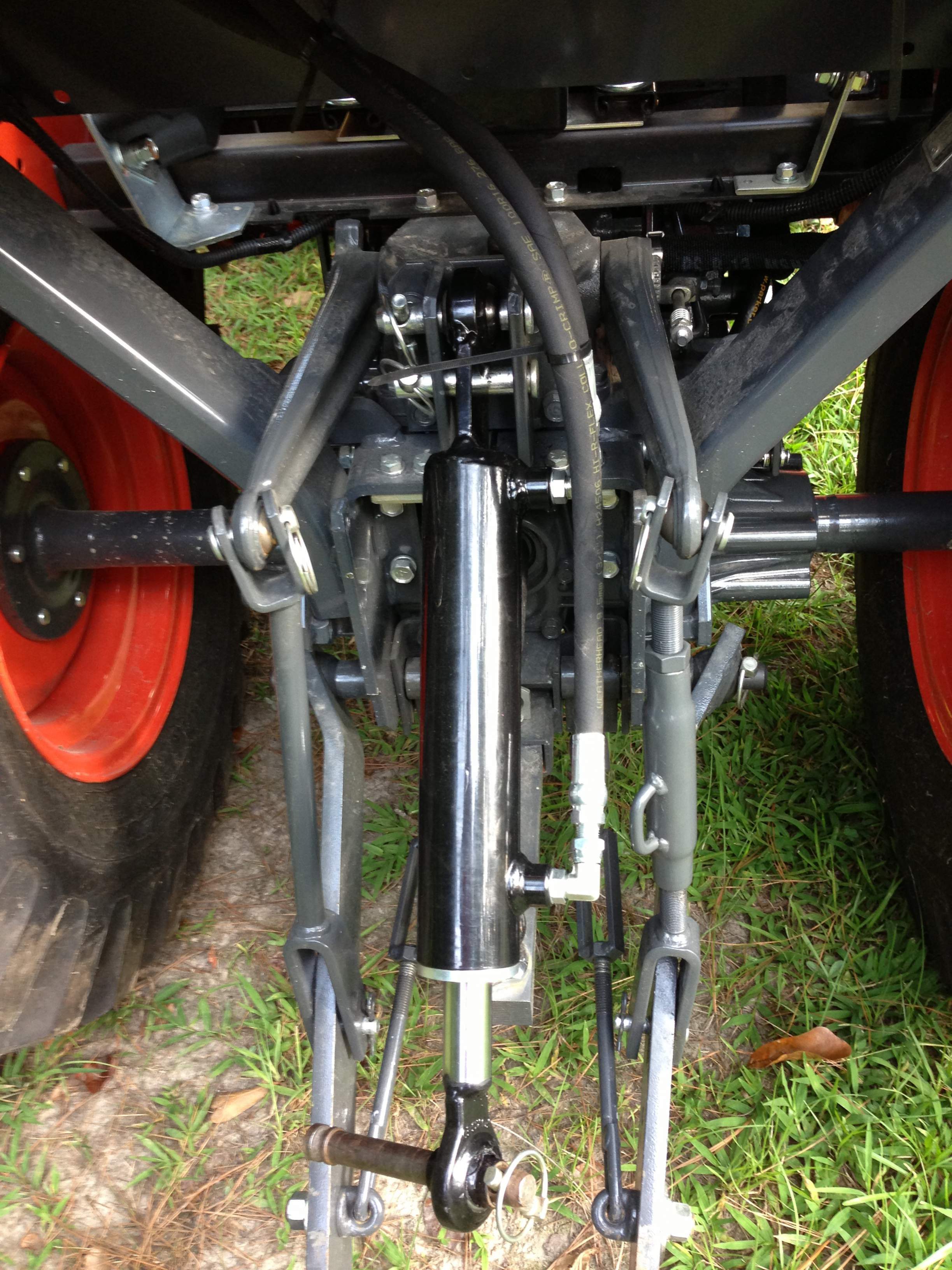

Here are some pics of the final setup.

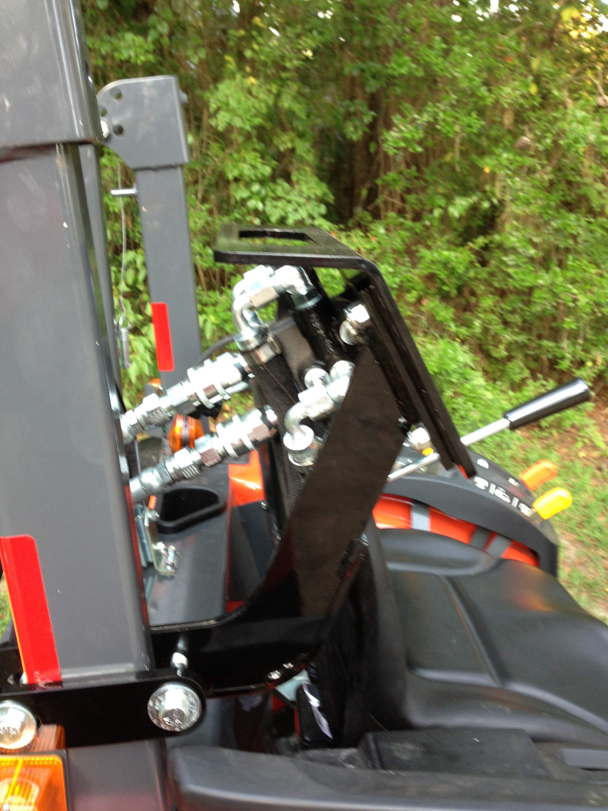

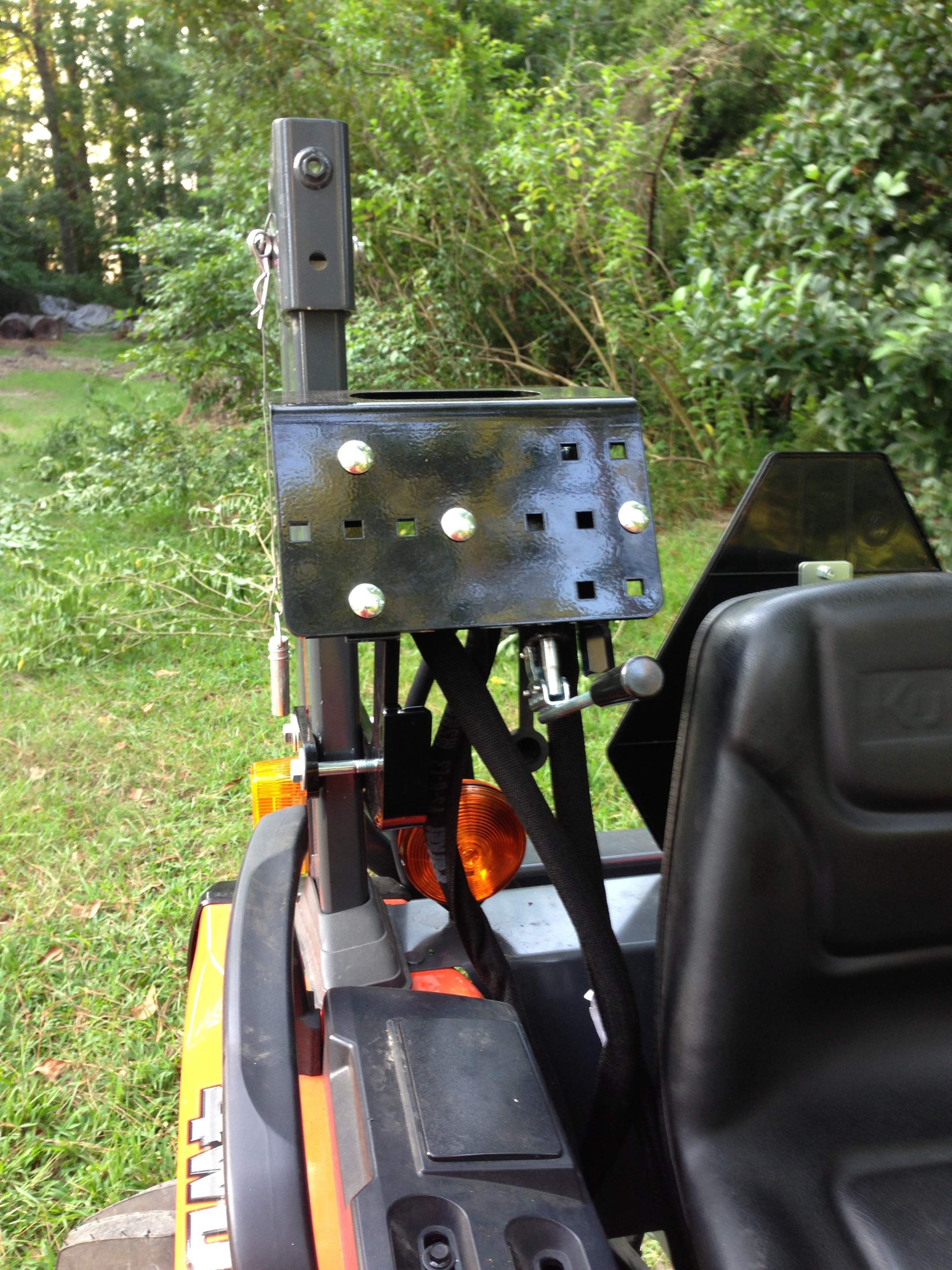

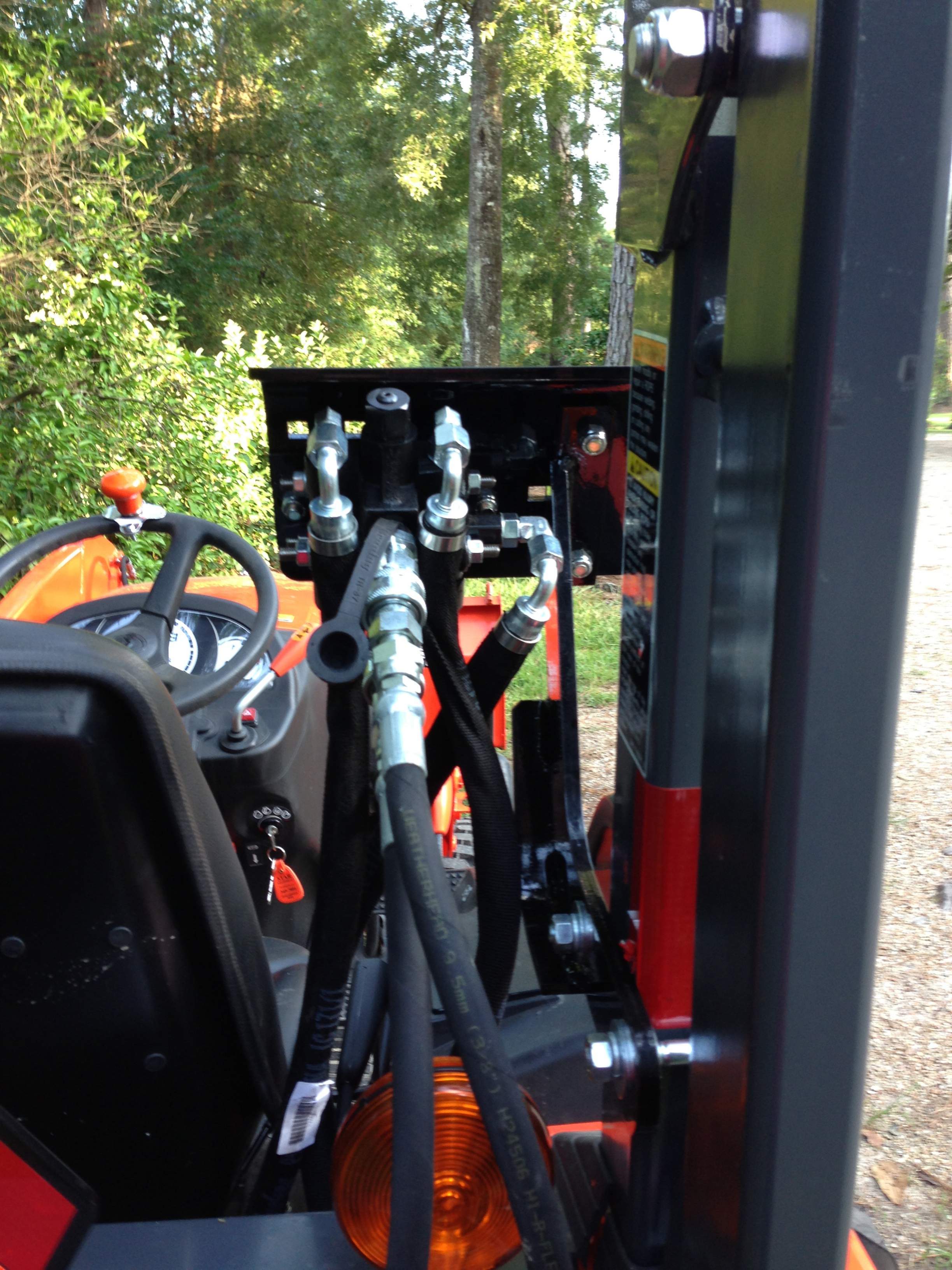

Is the loader valve down there where all the hoses are going to or is it hooked to the loader subframe? If it is hooked to the sub frame I'll show you some picture how I have mine. Maybe you can get ideals from it. Just maybe you might do it something like mine even if the loader valve is down under there.
   / Kubota B3200 Remote Hydraulics Kit #17
I had forgot about the picture in your 1st post and I see the valve isn't hooked to the sub frame. I'll post some pictures tonight and maybe you can get some ideals anyway.

Well I got my Kubota kit from a guy in Canada for a little over $ 300.00. With JJ's advice it took me 3 days & $ 100.00 in extra tools I bought. Anymore it takes me time to figure things out & do something, getting old is no fun. I still can not get it to raise my single hose sickle bar. Gave up on it for now, just chained the sickle bar & cut my creek banks. JJ, THANK YOU for your help. LOve my B3200 though.
   / Kubota B3200 Remote Hydraulics Kit #19
If the cyl on the sickle is a SA cyl, connect the hose to the B port and plug the A port.
You should be able to extend the cyl.

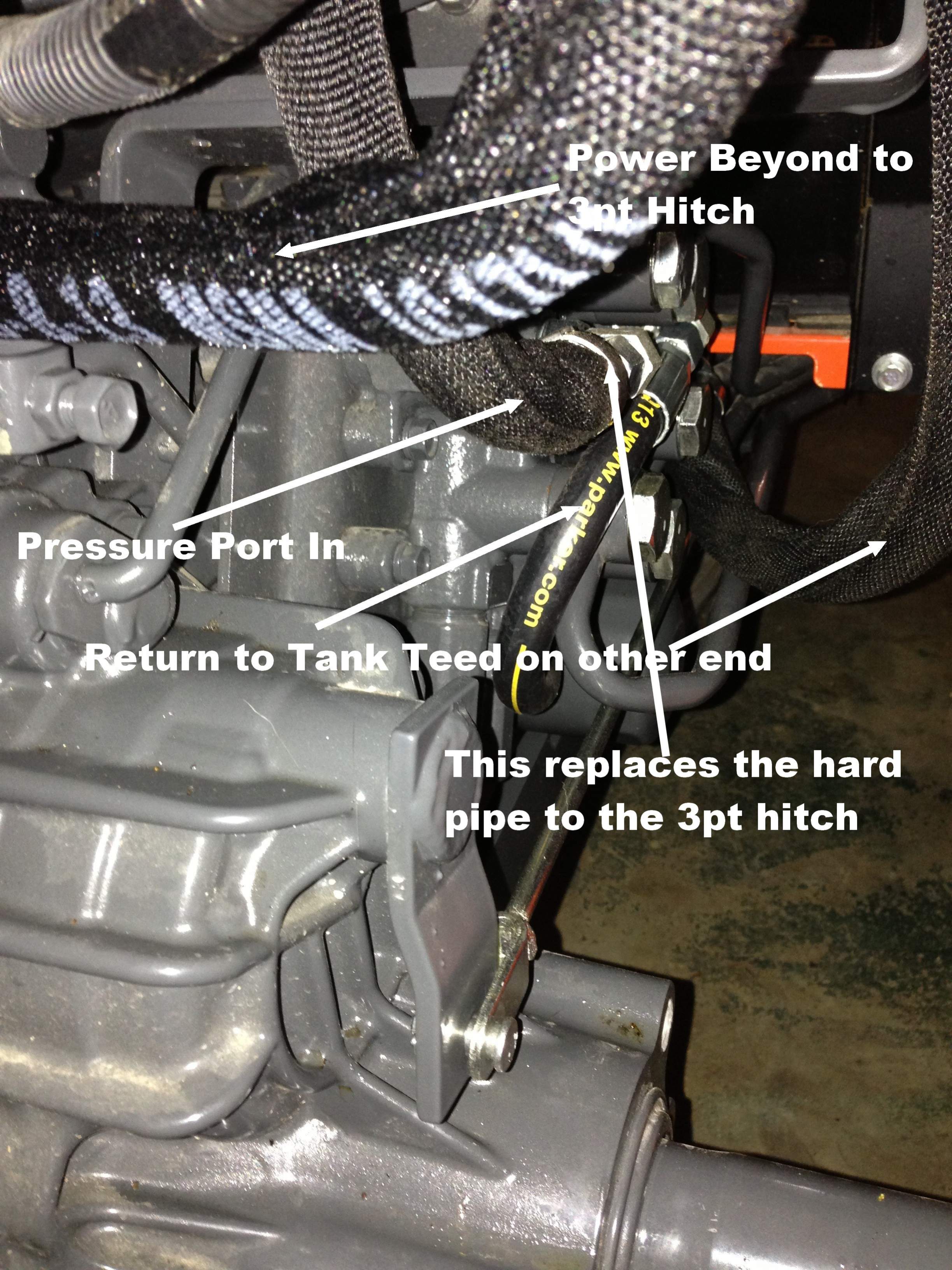

Here's how I did my b series
