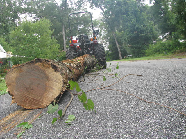

I have a couple of concerns? Fist of all can I use Turf Tires in the woods?The woods are leaf covered and mostly open with a few logs and of course has brush in some areas. I have a small hill on my property which is basically high and dry with no SWAMPS. Secondly, will the Kubota B3200 be able to pick up 16 inch to 24 inch diameter logs x 4 ft length. The reason that I ask this? I have noticed in your forum several had mentioned that the Kubota B-3200 is too lights and is only 1734Lbs w/O an FEL or loaded tires. the FEL. Will the Kubota B3200 be ok if had loaded had tires, and a 60 in box blade ( 500lbs) on the back. I also understand if I purchase new, competitors such as New Holland list their Boomer 30 Tractor weight at around 3100 Lbs and the Mahindra 3016 at around 2400 lbs. Once again thank you for your assistance.
You can use Turf Tires in the woods but R4 Industrial Tires would be my first choice. R4s have enough tread for traction, can be driven over dry lawns without turf damage and are highly puncture resistant. R4s are also a little wider than ag tires (R1s) to support full FEL loads. Punctures on tractor tires are a more miserable experience than on cars. Must of us consider puncture resistance pretty important.
Loaded Turfs on the tractor you looked at? Well, THAT is a FIRST here.

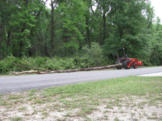

24" X 48" logs might be doable. 16" X 48" should be easy, with ballast and LA504 loader. You did not specify the loader on the B3200. The LA_ _ _ is Kubota's lift rating in kilograms. IE: My B3300SU has the LA504 loader, in theory can lift 504 Kilograms. You could have a LA504,LA364 or LA304 loader on the B3200. You would certainly want the box blade mounted on the 3-Pt. hitch for counterbalance before making a max FEL lift attempt.
You should price a new Kubota B3300SU package. Kubota sells this with FEL/LA504, 4-WD, HST.....all up. You may find the PACKAGE considerably cheaper than pricing a B3200 + multiple options.

I like the bucket that you have attached to your tractor. Are you satisfied with your tractor and if you did it all over again, would you buy the same one. Thank you for sharing your wisdom and insight. What ever tractor I buy, I will definitely have R-4 loaded tires.
Bucket came standard in B3300SU package. Bolt on chain grab hooks are from Ken's Bolt On Hooks in Maryland.
The aluminum, clamp-on Debris Forks are from Payne's Forks.
I have been happy with my B3300SU, which is mostly used in the woods. I had a loaned JD/Yanmar 750/20hp on which to learn for a year before buying the B3300SU.
I have R4s. I do not have them loaded. It seems tractor newbies think they must have 1) backhoe 2) loaded tires. I try to discourage both unless the buyer is sure, SURE, SURE.
Just do not wait long if you purchase new. Kubota is about out of the Tier 3 emissions compliant models, as are other marques. Soon only Tier 4 compliant tractors will be available new at considerably higher prices than the Tier 3 models.
