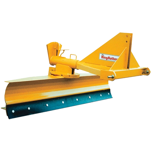

I'm not that familiar with the size/weight of a B3200; but could he not run an 84" Rear scraper like KK HD-RB-84? It looks like it's around 700#, offers tilt, pivot, (maybe side shift, but not tool free side shift?), for $2200, with a 32hp, 4x4 machine?

If not a 7 feet rear blade, how about a King Kutter 6' Heavy Duty Rear Blade, # HD-RB-72?

So, that appears to be a well made, heavy, rear blade with pivot and tilt. I "think" there are two bolts/nuts on the back, that can be loosened and the entire moldboard shifted left or right by about 12 inches; basically allowing offset work (such as cleaning a ditch). I can't 100% confirm just looking at the pic though. Found a picture on Northern Tool, and it doesn't appear it can shift the blade left or right; but at 72", I dont Think that will be an issue.
Iron Craft I think offers a similar set up for comparison; Looks like Ironcraft 4406 is the comparable; which offers side shift, But only weights 340 lbs vs whatever the KK weights.
I think you are correct, the KK does not seem to offer the offset adjustment.

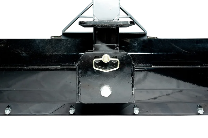

I see the offset pin on the Ironcraft and I can visualize how this adds more versality.

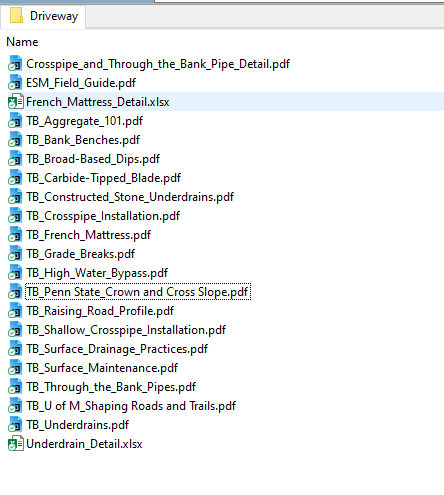

I'm several days late to this thread, but may I suggest the Center for Dirt and Gravel Road Studies as a how to resource?
materials estimator tool: https://dirtandgravel.psu.edu/general-resources/dglvr-materials-calculator/
They also have a number of technical bulletins all focused on common issues with building and maintaining gravel roads.
Actually yes! Someone linked a TB and from this TB I found the main program from PennState and it is very informative. The ESM Guide is comprehensive.
