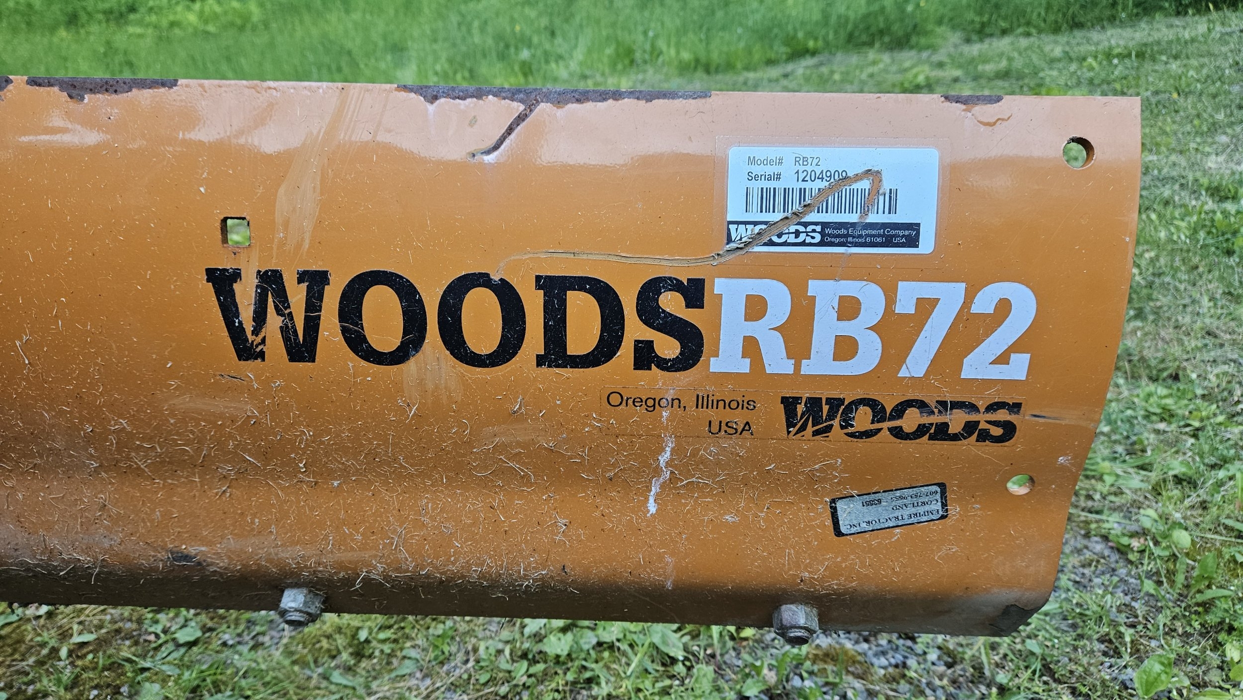

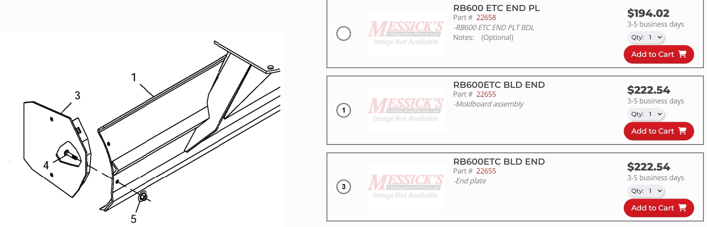

Today I bought a Woods RB72 Rear Blade. It looks pretty neat and for about $700. I tried locating the documentation for it, but Woods only lists RB72.50, which I suspect it is a newer release. I intend to purchase the blade end cap from Messicks, just need to figure out what's going on with their microfiche, something is wrong with the part numbers:
Thanks everyone for the feedback and recommendations. I am very happy and satisfied with the purchase. And glad that a few users highlighted the importance of getting a fully adjustable blade. Here is my new RB72:

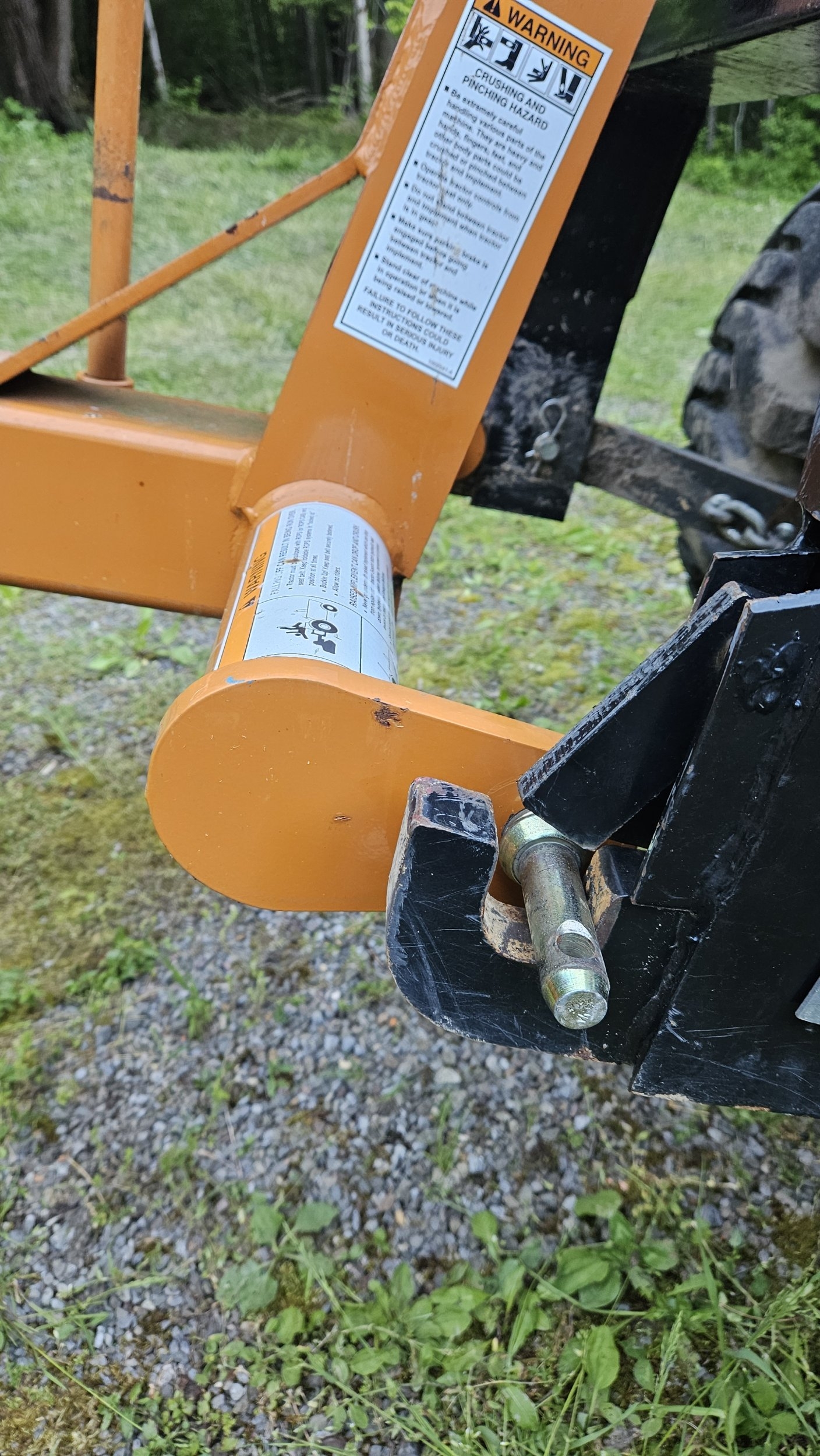

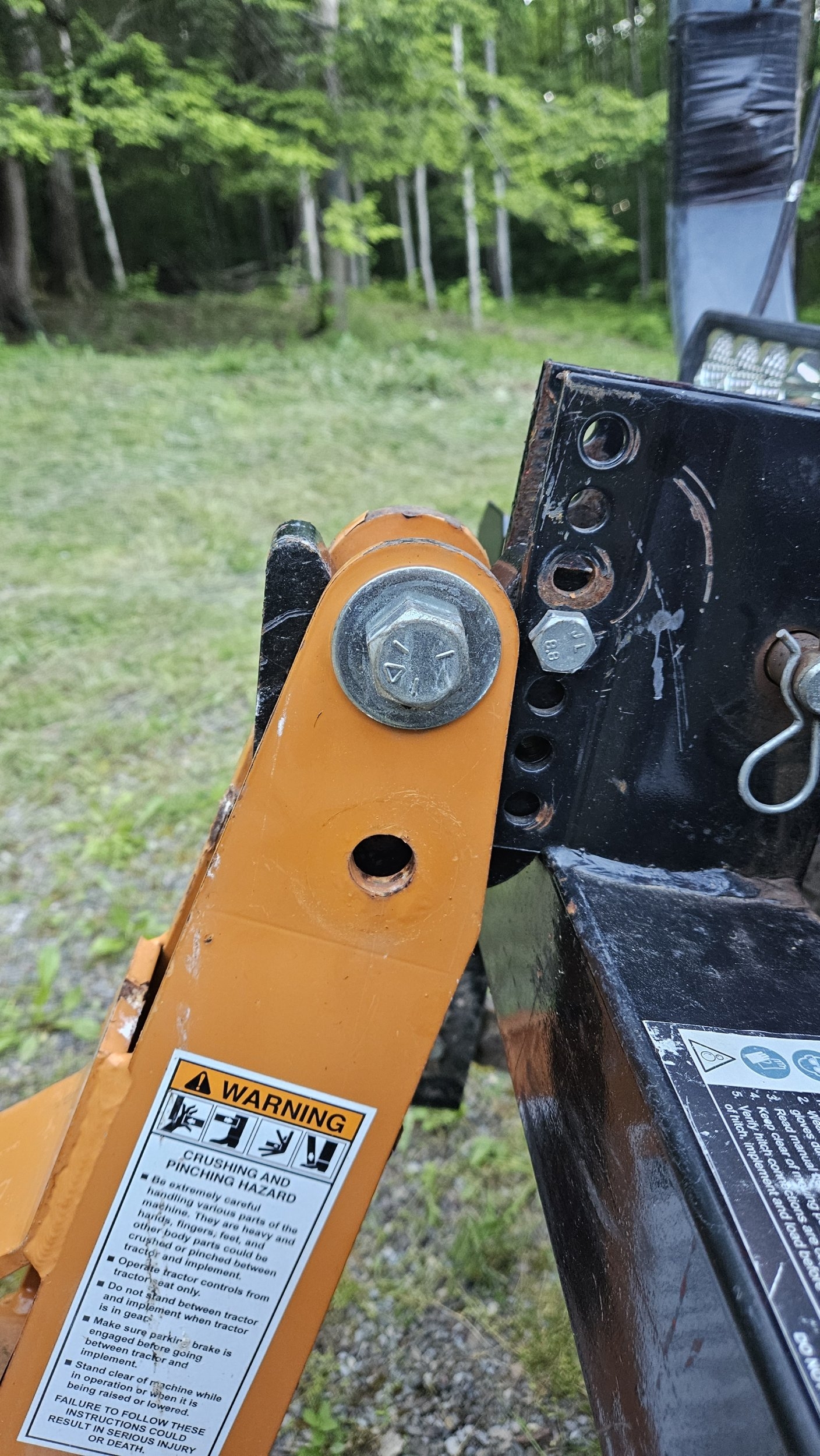

This is my very first time playing with the 3-point hitch and I need to confirm a few things:
1. currently I have NO pins locking the RB to the quick hitch. Is this correct, just locked in place by its 450 lbs?

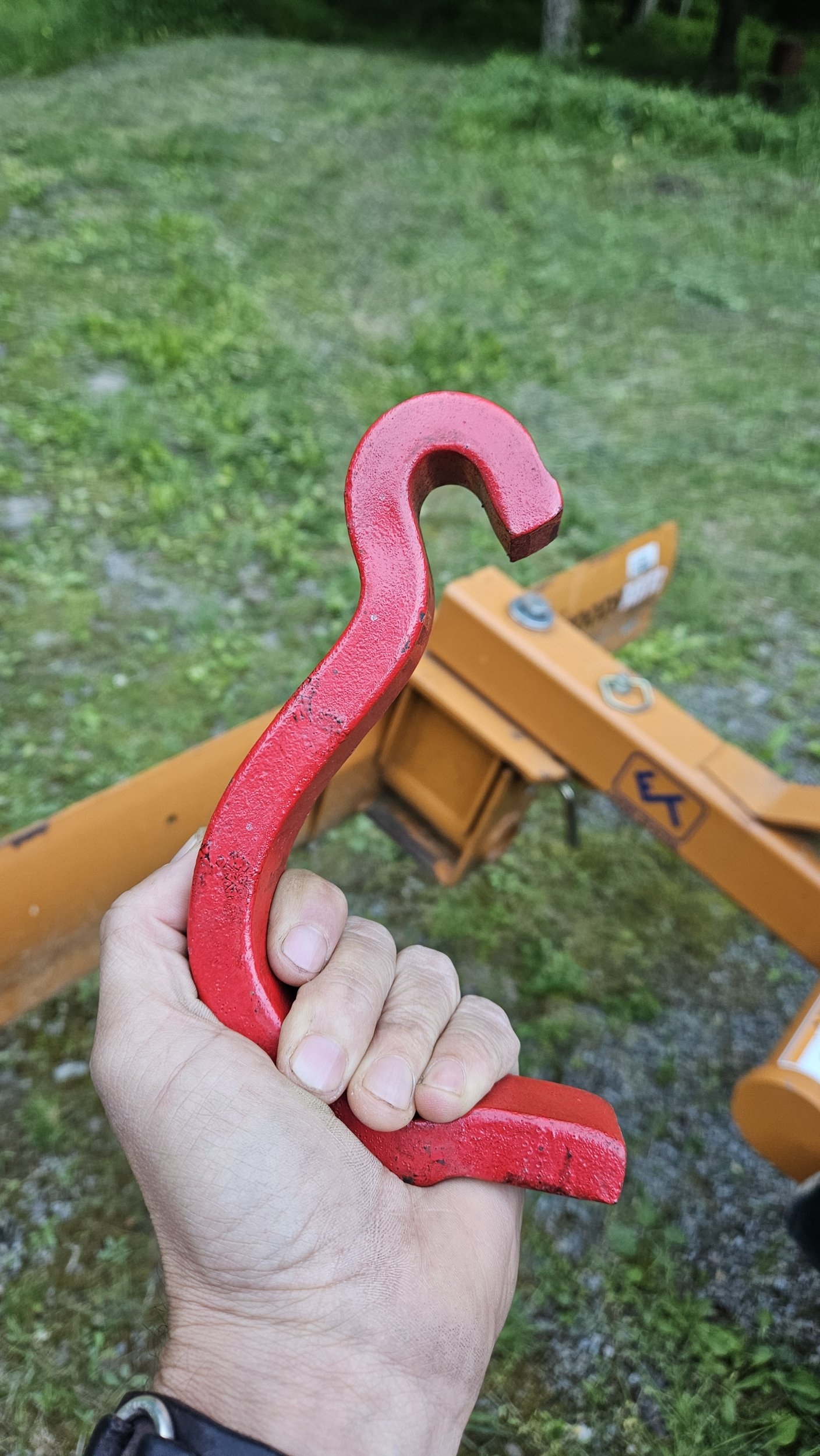

2. It came with a red metal hook that I can't figure out whether even belongs to the blade. Any idea what this could be or where it goes?
The red hook looks exactly like some pieces I've found on old RR beds, just painted; other than that, no idea.

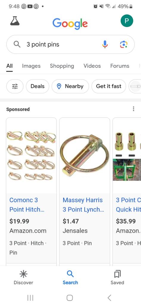

On the pin topic, get 2 (or 4, you'll set them down and loose them) standard snap pins from any farm supply store for the ends of the pins.
Moldboard end plates; Woods RB72 Rear Blade (Woods) Parts Diagrams
   / [KUBOTA B3200] Grader Blade / Box Blade Recommendation for Driveway Maintenance #110
Here is your parts diagram, it's grouped with the landscape rake two; but the top two diagrams are your blade
