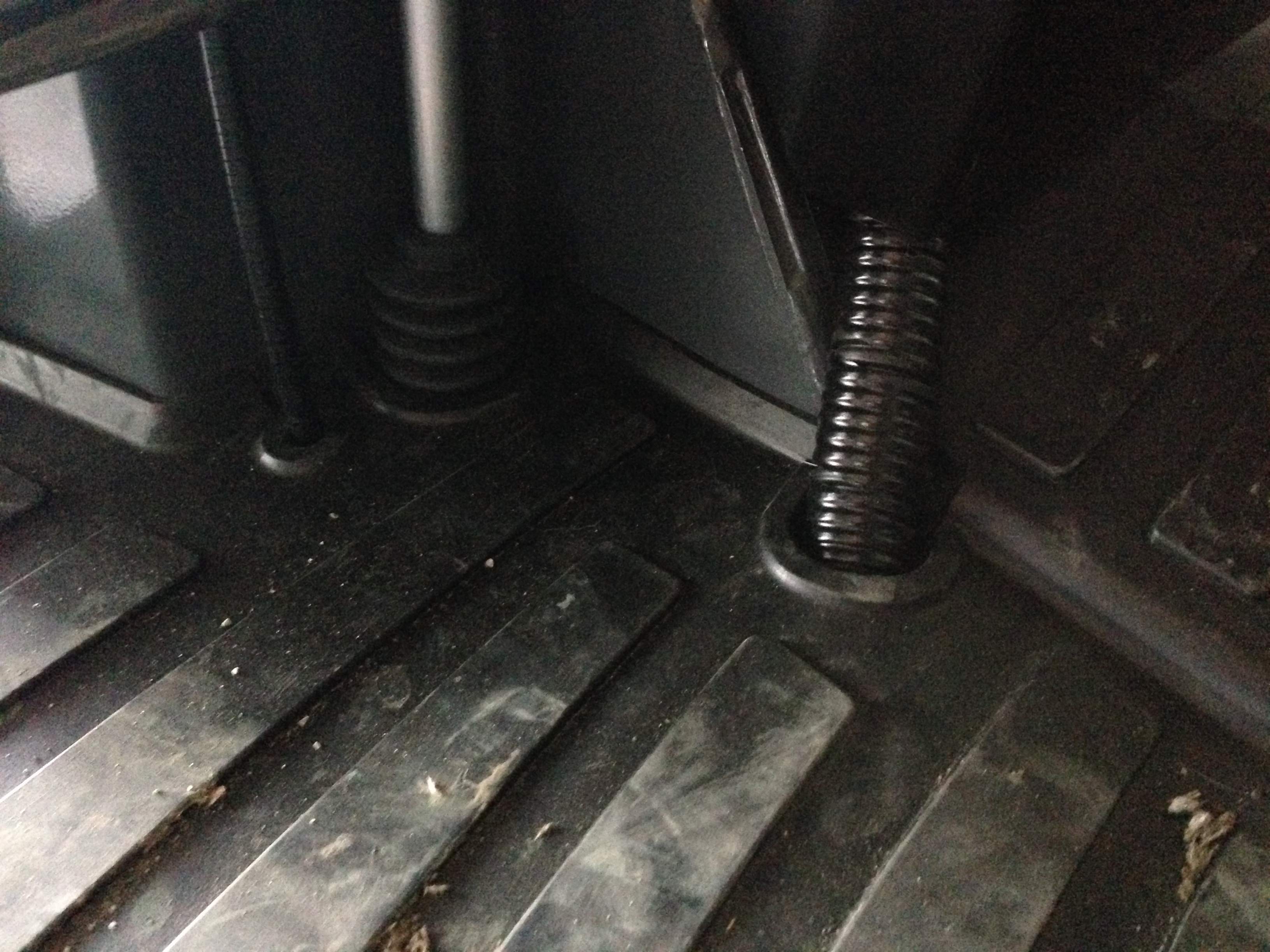

Has anyone run wires into the cab for snow blower control? Basic choices are thru the firewall or floor. I was just wondering if anyone had already done the investigation and found an easier way. I know cameras have been added to cabs but the wiring details aren't mentioned. I'm moving my snow blower from my L39 ( no cab) to my B3350. I ran the wires through orange 1/4 " air hose cut to length with magnets to hold the it to my frame for the L39. For control I have a 4 button pendent with magnets that I just clipped to the ROPS and it worked fine. The new cab is tight and the doors close tight so I have to come up with something else. Suggestions? thanks, rob
   / Kubota B2650 and B3350 info and hints
#100
Kubota installed the electric controlled 3rd function valve just ahead of the cab on the right side. Wiring goes back under the floorboard to a point near the inboard front edge of the fender, or a few inches to the right of the HST pedal and near it's aft edge. Looking under the fender from the outside, the wire goes up between the plastic fender well liner. Inside the cab, the wire runs up inside the void below the joystick, and then up the joystick to the button controls. (With the 3rd function option, the joystick is replaced with one that incorporates the control buttons).
If you want to get to the joystick area, this seems a good way to do it.
Otherwise, lift the floor mat and the sound insulation and see if you can't run your wires along with an existing wire run.
