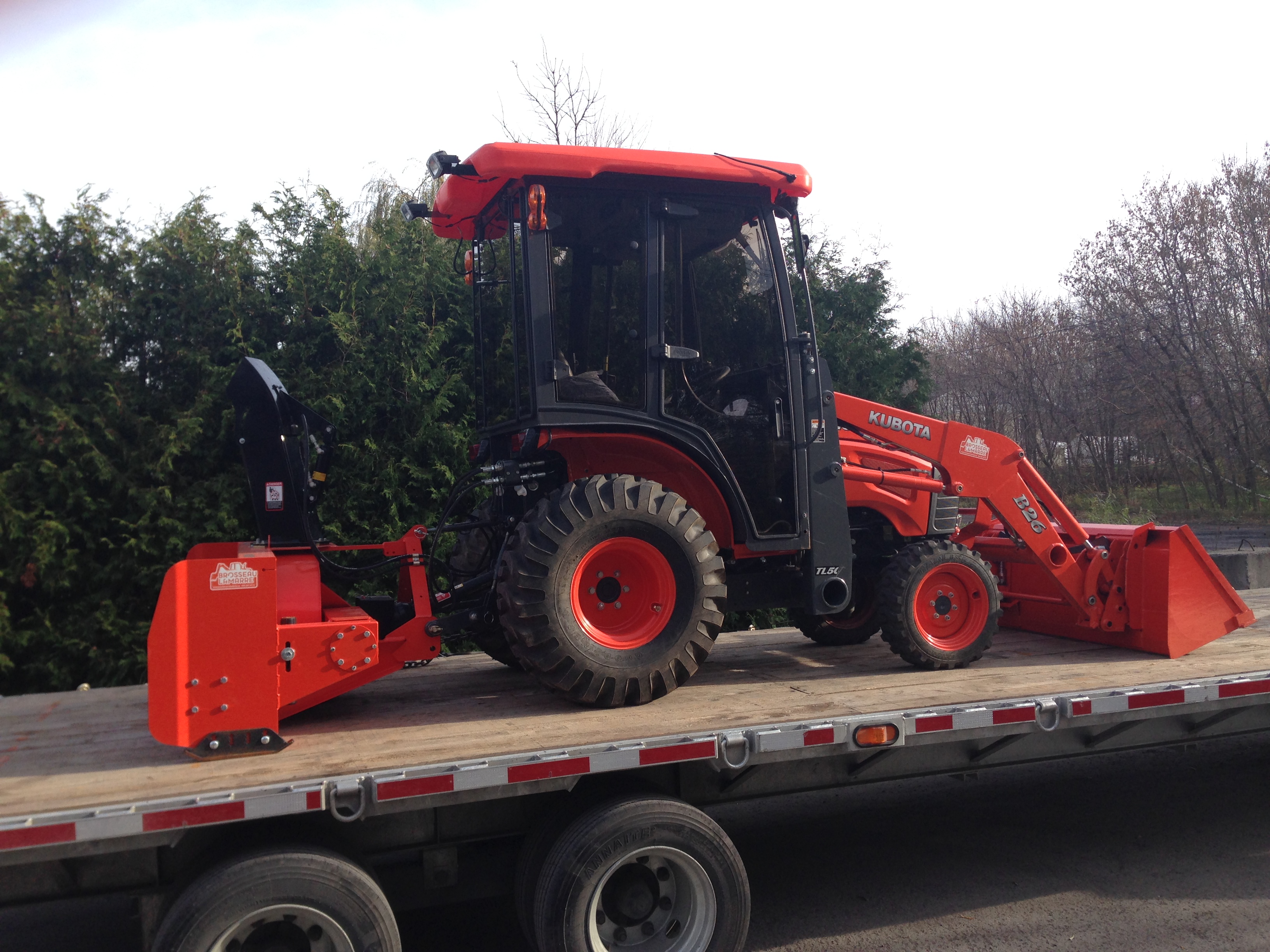

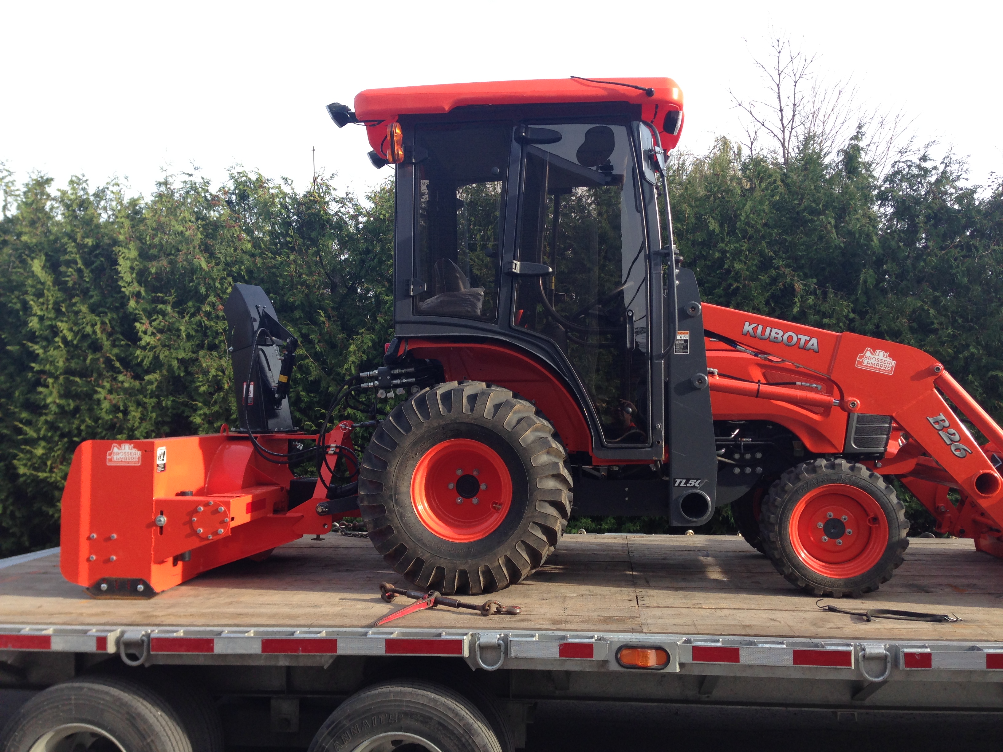

Has anyone put spacers on their b26?? If so size please..
I put laurin cab on my b26.and was thinking about wheel spacers..also I took bh off and put 64" blower on..which wasn't enough ballast for fel..also looking into ways to add more ballast to b26 with out taking blower off and adding ballast box.. IMG_2432.JPGIMG_2431.JPG

Cab looks good, are your rear tires already ballasted?

How does the backhoe work with the cab. It doesn't look like that is possible unless you remove the entire back panel.

Backhoe works just as good with or with out cab..just a little tight to maneuver from front to back..but doable..I tend to leave door open when working cause I forget about cab and,broke hinges twice...glad glass door didn't break.....if anyone is thinking about and have the means to get a cab..laurin cab ..works great..you won't be disappointed...heat is great..option is ac..they put big box on top...was ugly ..so I opted out...windows onsides open...ohh..they have to remove your rops also.but laurin cab is osha approved as a rops.....just so you know.!!

Nice looking cab, I'm envious of you on cold days however I'd be concerned about it being too restrictive the rest of the time. For snow removal I use a rear mount grading blade (250-300lbs) on my B26 with no additional weights or filled tires on a 1/3 mi. steep driveway. Everything is fine unless there's ice then its mandatory chains if I want to get back up to the top. For moving snow around I don't have any FEL issues, a full bucket of dirt could be a problem on anything but level ground. Your blower is probably closer to 400-500 lbs., you've got added weight of the cab (mostly over rear wheels) and you said you're on typically on level ground so other than chains for ice I wouldn't think you'd need to add anything else. I must admit I've been too cheap to buy chains yet (this is probably the year) but I'm pretty sure the R1's on the back have clearance for chains. I'm not where the tractor is currently so I'll have to check when I get back.
