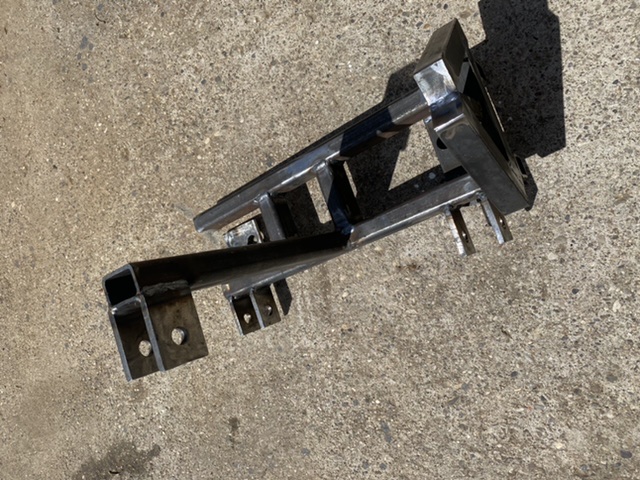

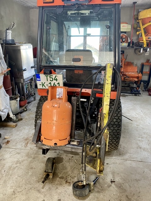

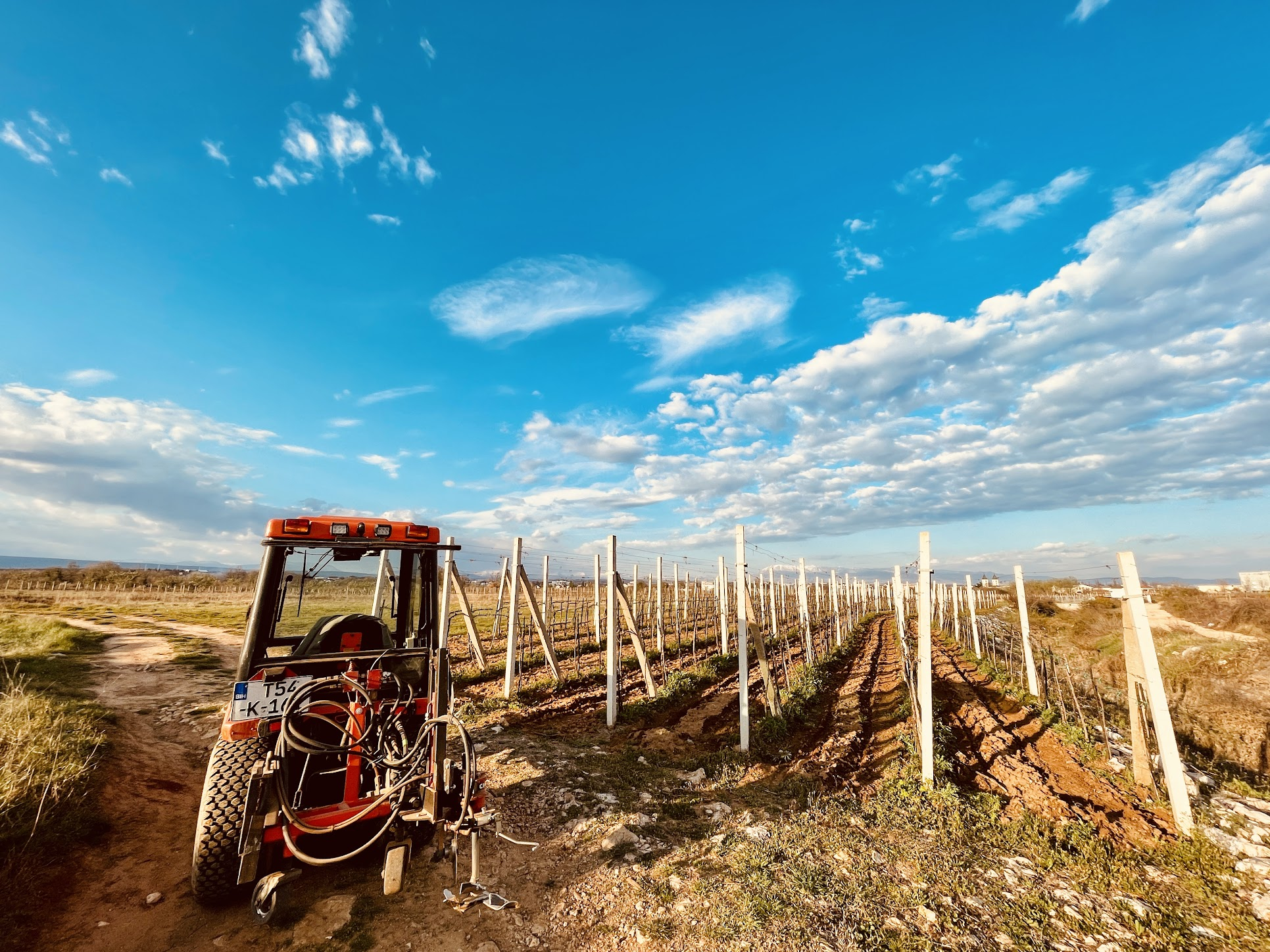

I致e been postponing this build for some time now, what better time to do it than world this lockdown time, something positive
I bought a used Clemens Radius blade, bare tool. Thisnis used to cut an inch or two under ground and pull the soil/weed, it opens the soil a bit and it kills the weed. Used mostly in vineyards but also in other orchards...
CLEMENS - RADIUS SL in heavy conditions - YouTube
I wanna use it as an under vine blade but also, remove the blade and use the hydro valve antenna to move the burner I am building to burn weed in the early vegetation... thus the propane cylinder...
This is my progress so far:
Video one
Video two
