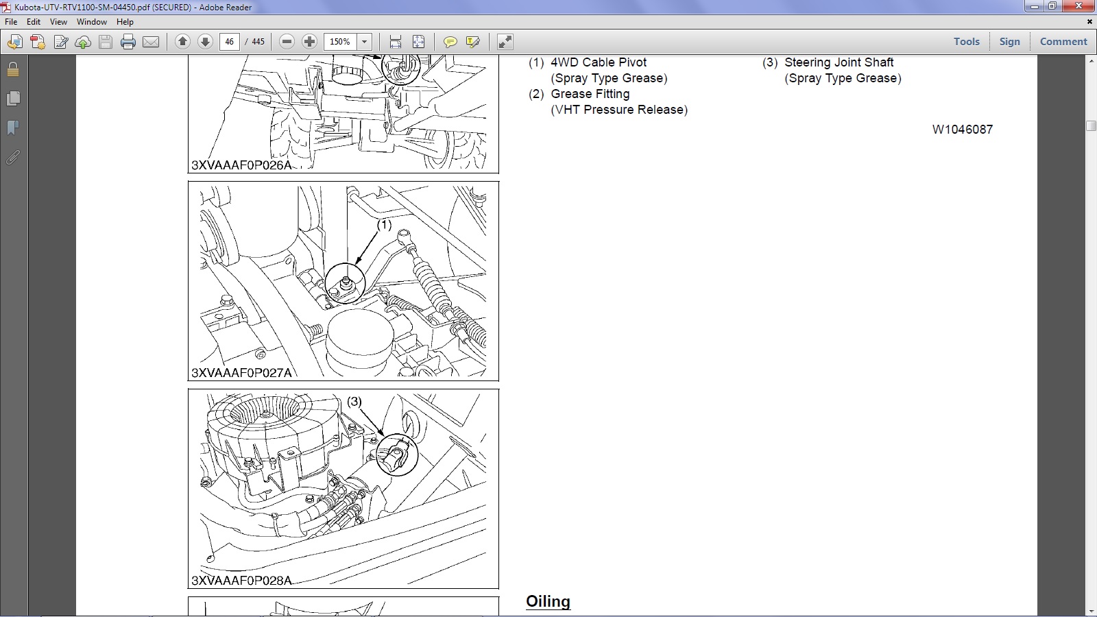

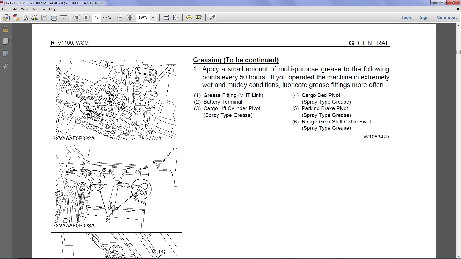

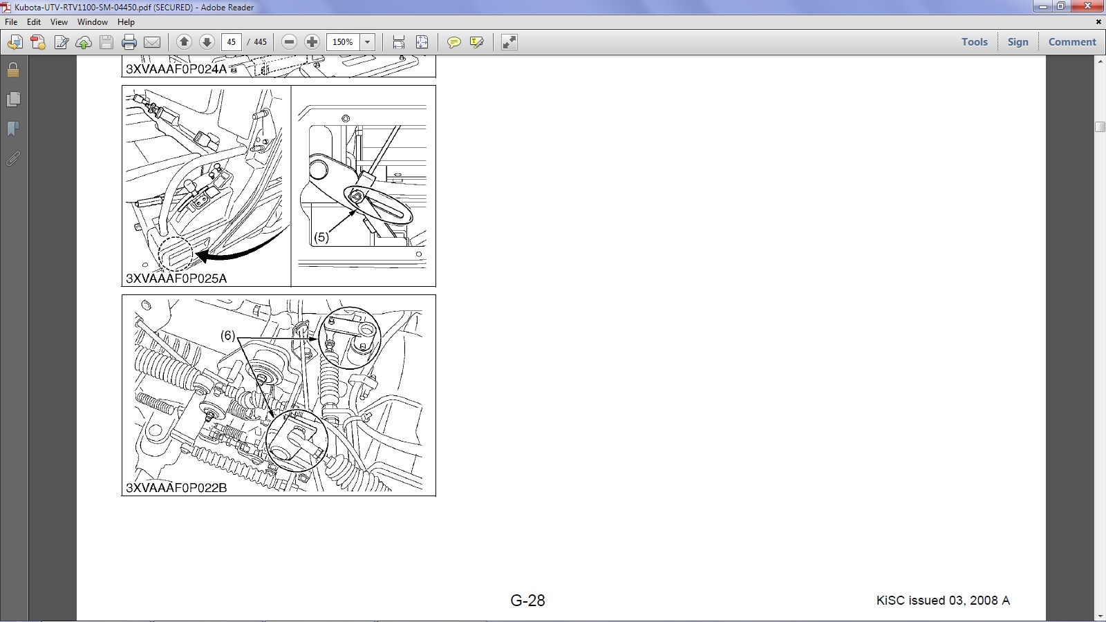

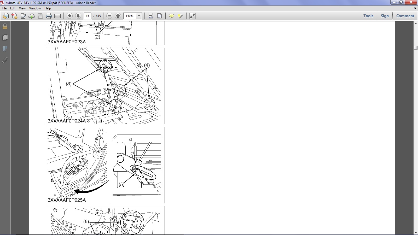

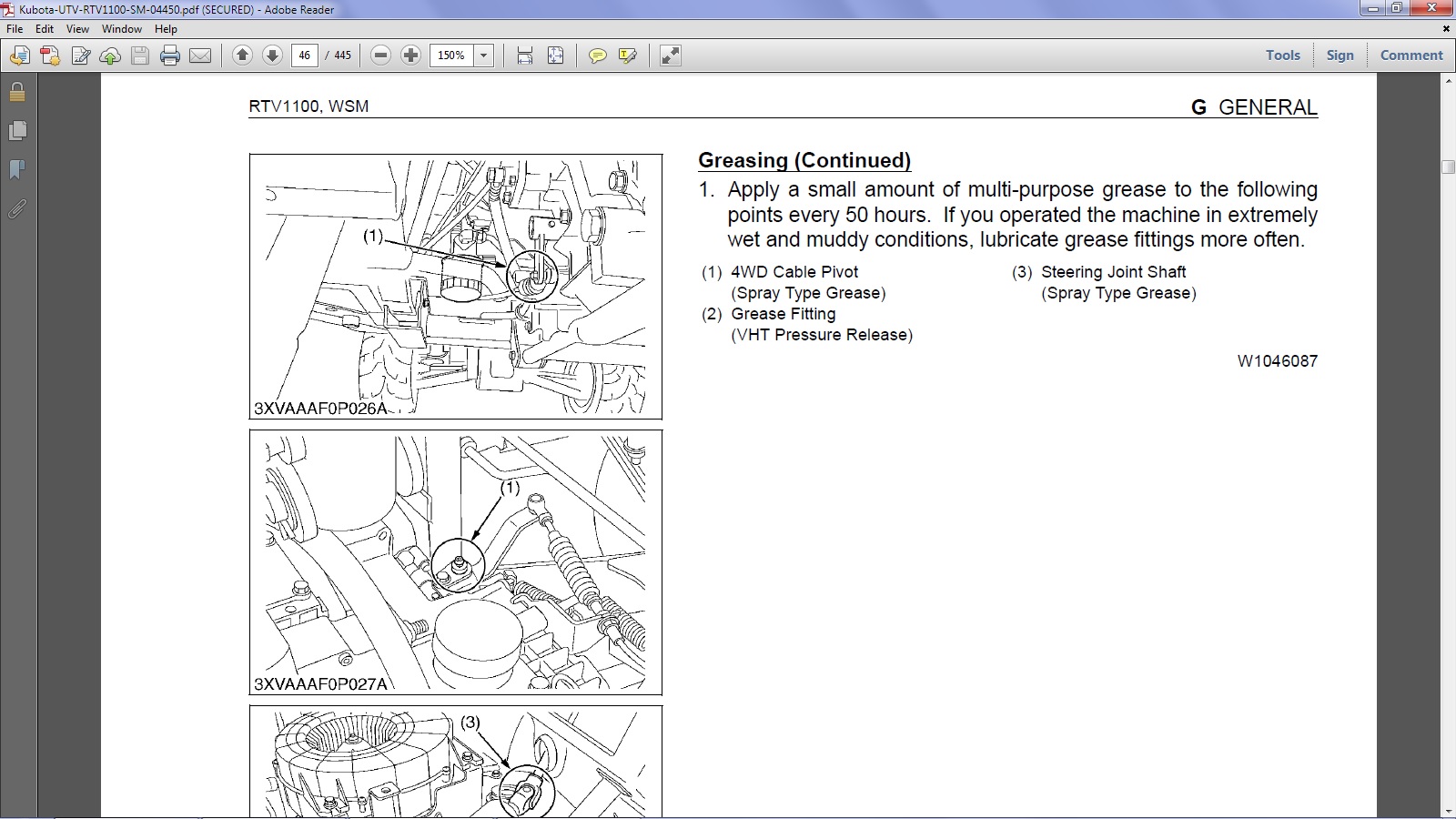

According to the RTV1100 manual, these points. And the 900 series is almost identical.

   / Kubota 900 #3
I didn't see the grease fittings in the universal joints (rear) of the RTV 900 among Spudhauler's images. They may be there, but I didn't see them.
Steve
   / Kubota 900 #4
Good point!
No my manual didn't show them either.
There is one grease nipple on the rear u-joint but nothing on the front of my RTV1100 2009.
