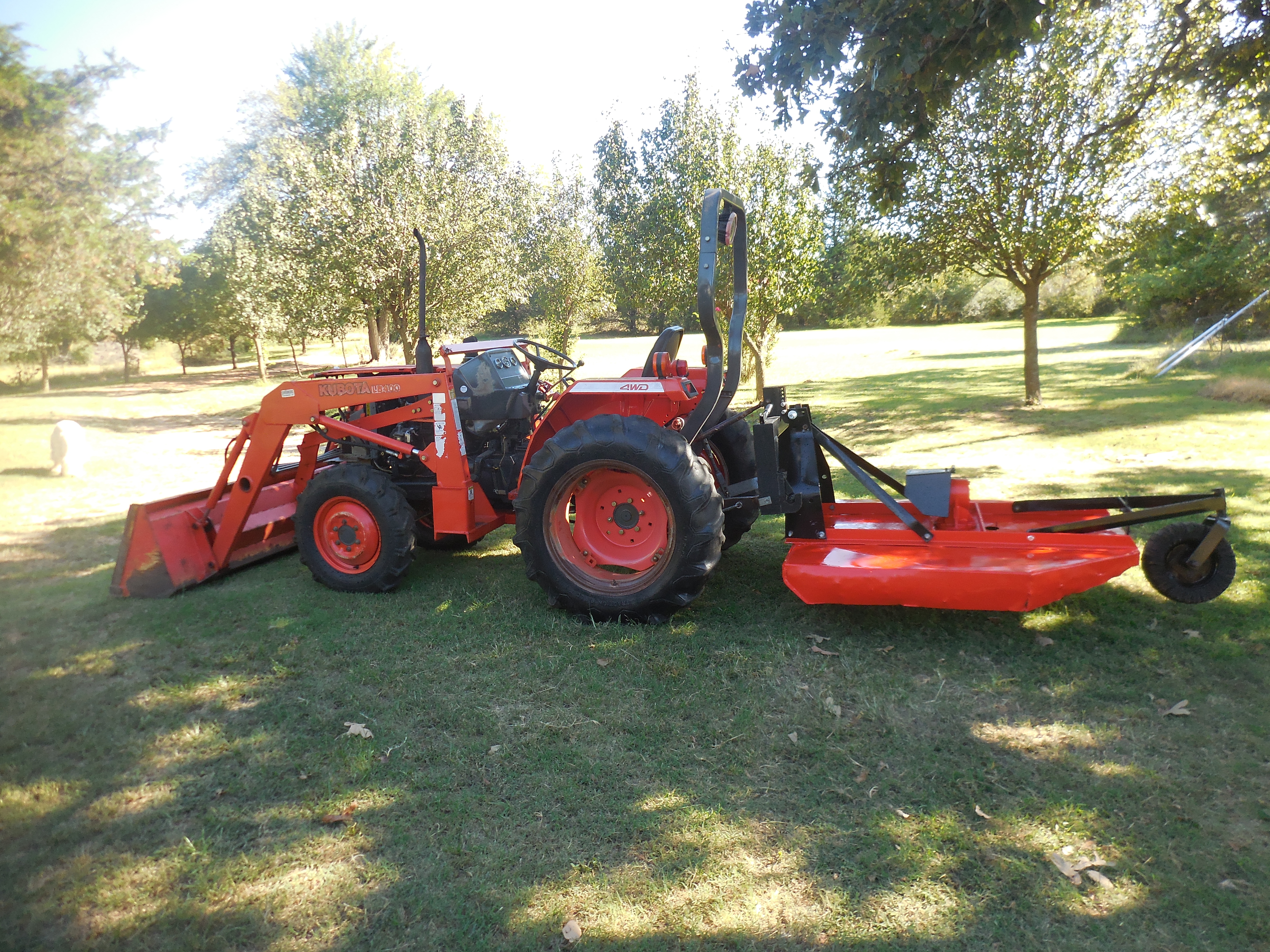

From being a teenager, I have always worked on my vehicles, motor replace, clutch work, etc. I have never worked on a tractor other than front seals, bearings on the 4 wheel drive. I have a shop building with plenty of space, plenty of tools, I don't have a clutch plate line up tool. I have a cherry picker, 2 floor jacks, air tools. 2000 Kubota L2500 with FEL, 850 hours on tractor, I bought it a year ago. I do not have a repair manual or parts catalog. I ordered throwout bearing and clutch from Messicks and got them today. clutch diameter is 8-3/8" which looks small, (I have not taken the tractor apart yet) so I don't know the diameter of the existing clutch. I read another post about securing the front bumper to a wall to keep it from turning, would jack stands under both sides of axel keep it from turning. Do I have to take the loader off?? Thank you

One thing to keep in mind while splitting the tractor, is that the front axle pivots. A lot of people miss it, then they go to split the tractor and the entire front half just tilts one way or another and makes for a very unpleasant experience.
To avoid this, get some wood wedges and jam them between the front axle and the frame of the tractor, on both sides.

Thank you, good idea. Do I need to take the fel off to split the tractor.
   / Kubota 2000 L2500 Clutch question #17
Yes, since you'll have to remove the loader mounts in order to split the tractor.
   / Kubota 2000 L2500 Clutch question #18
Jack stands under the axle won't help any differently than having the tires on the floor. The axle stays put either way. The problem is that a tractor has a single center axle pivot right in the middle of the front.
So as soon as you remove the last of the bolts that hold the bell housing, the whole front of the tractor& engine will immediately try to lean to one side all the way to the stops as it pivots around that single center axle pivot axle. As it leans, it can trap your fingers between the axle and front frame if you don't have those shims in place to stop the lean.
An alternative way to stop the front from leaning over to the stops lean is to hold the front up with the cherry picker. Anotheris to bolt the front fender to the wall. In either case, the front half stays put and you split the tractor by having a floor jack under the tranny before you split it. Then you can just wheel the rear away from the front.
Yes, you ought ot take the loader off. That's usually the first step.
Good luck.
