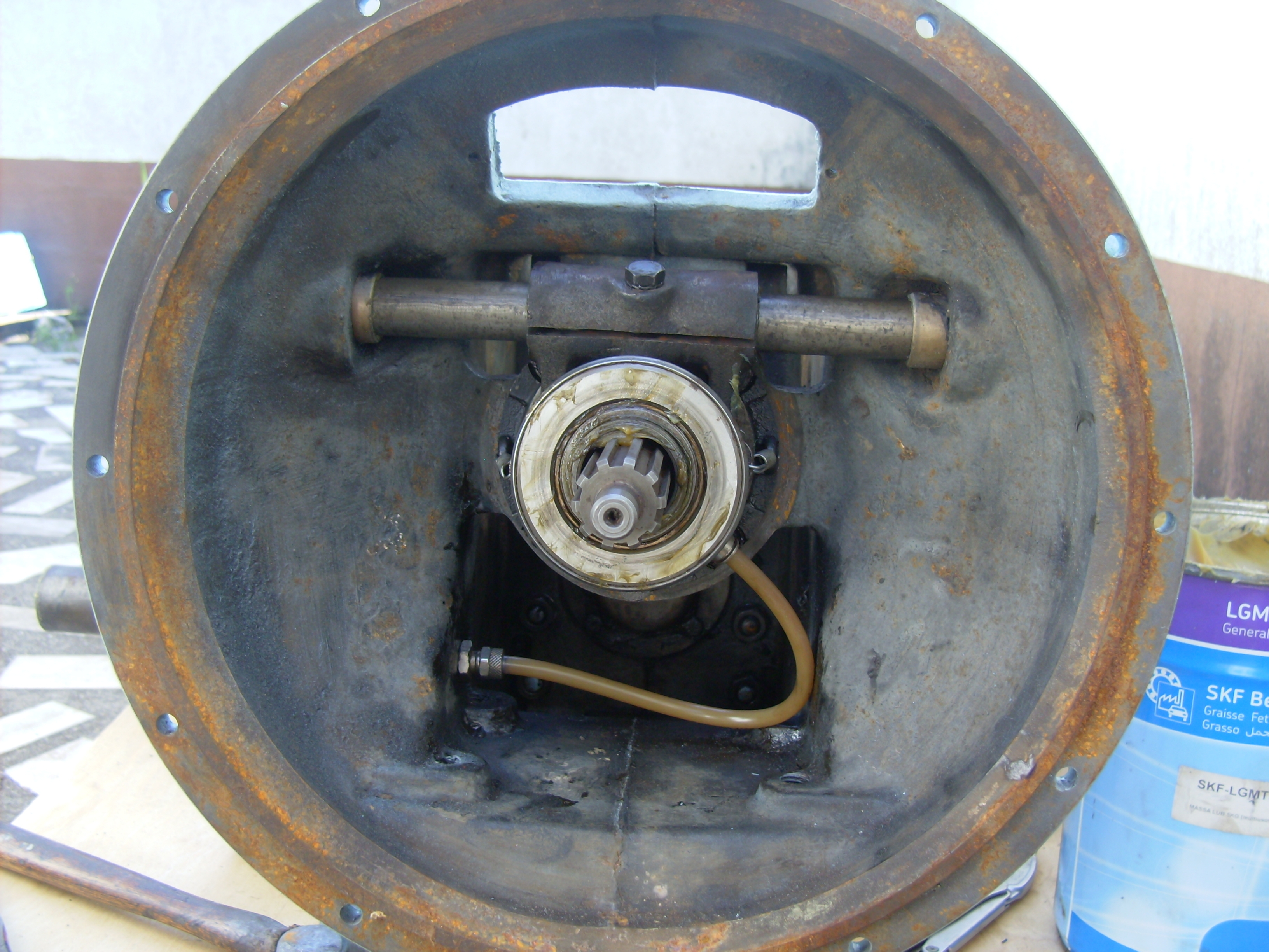

Throw out bearings are factory pre-lubed. You cannot lube them. Scotty
True most of the time. i recall on my '70 IH Scout (304) there was a zerk for the throw out bearing underneath the chassis.. the only one i've come across
OP: best of luck in the repair, regards
/ Kubota 2000 L2500 Clutch question #10
Yup, my 1962 Toselli crawler had a grease fitting for the throw-out bearing.
/ Kubota 2000 L2500 Clutch question #11
I hope you never drive with your foot on the clutch and if there is a retracting spring on the linkage to pull the bearing away from the pressure plate, be sure it is doing its job.
Monitor your clutch freeplay.
/ Kubota 2000 L2500 Clutch question #12
As you say and show, there's no reason to design the common throw out bearings so that they can't be lubed. That's just the way that most are.
And I bet every mechanic out there has tried some sort of trick to lube an "unlubeable" throw out bearing. I know I have. I'll probably try it again, too......Don't recall it ever working though.
rScotty
