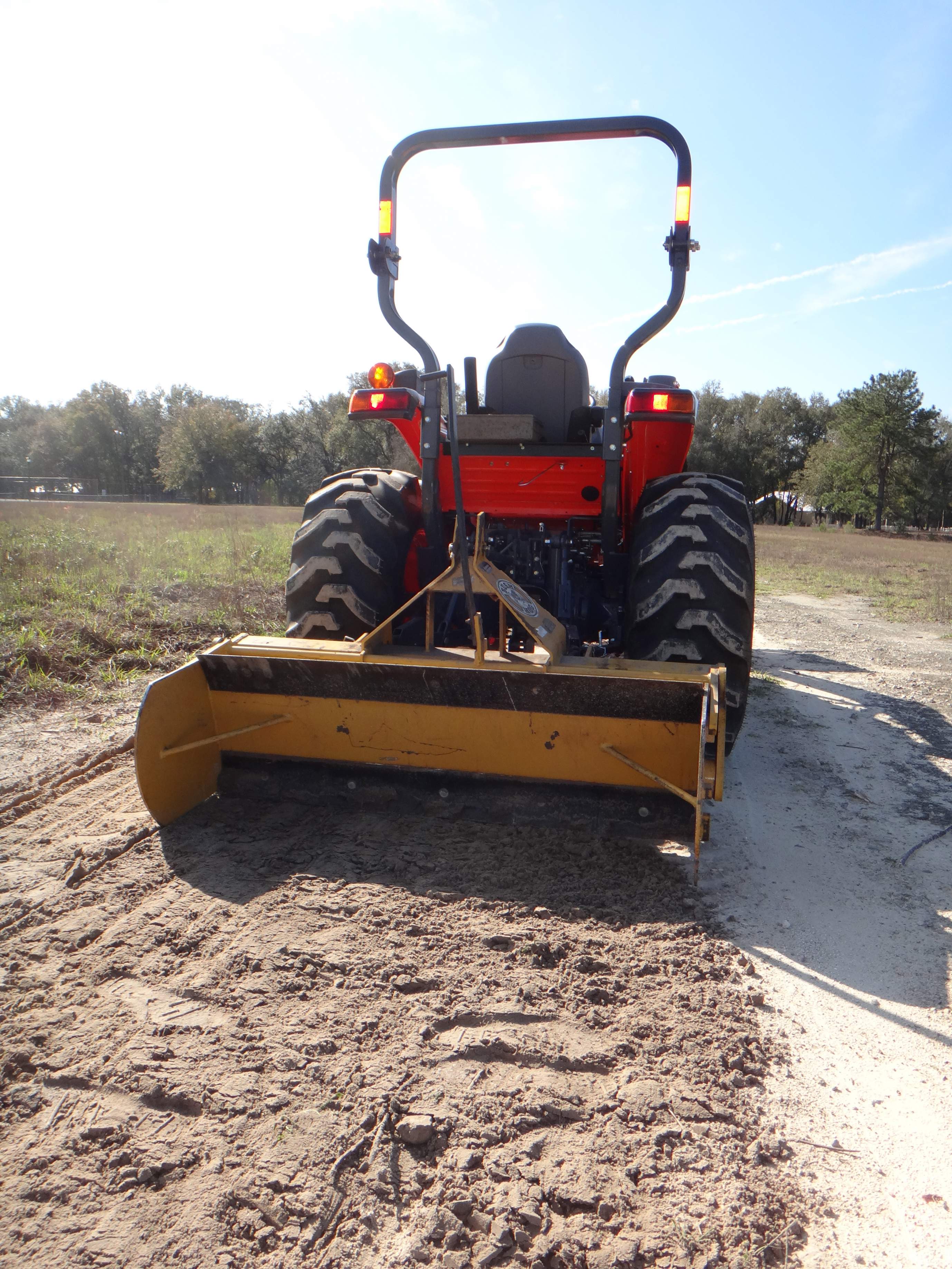

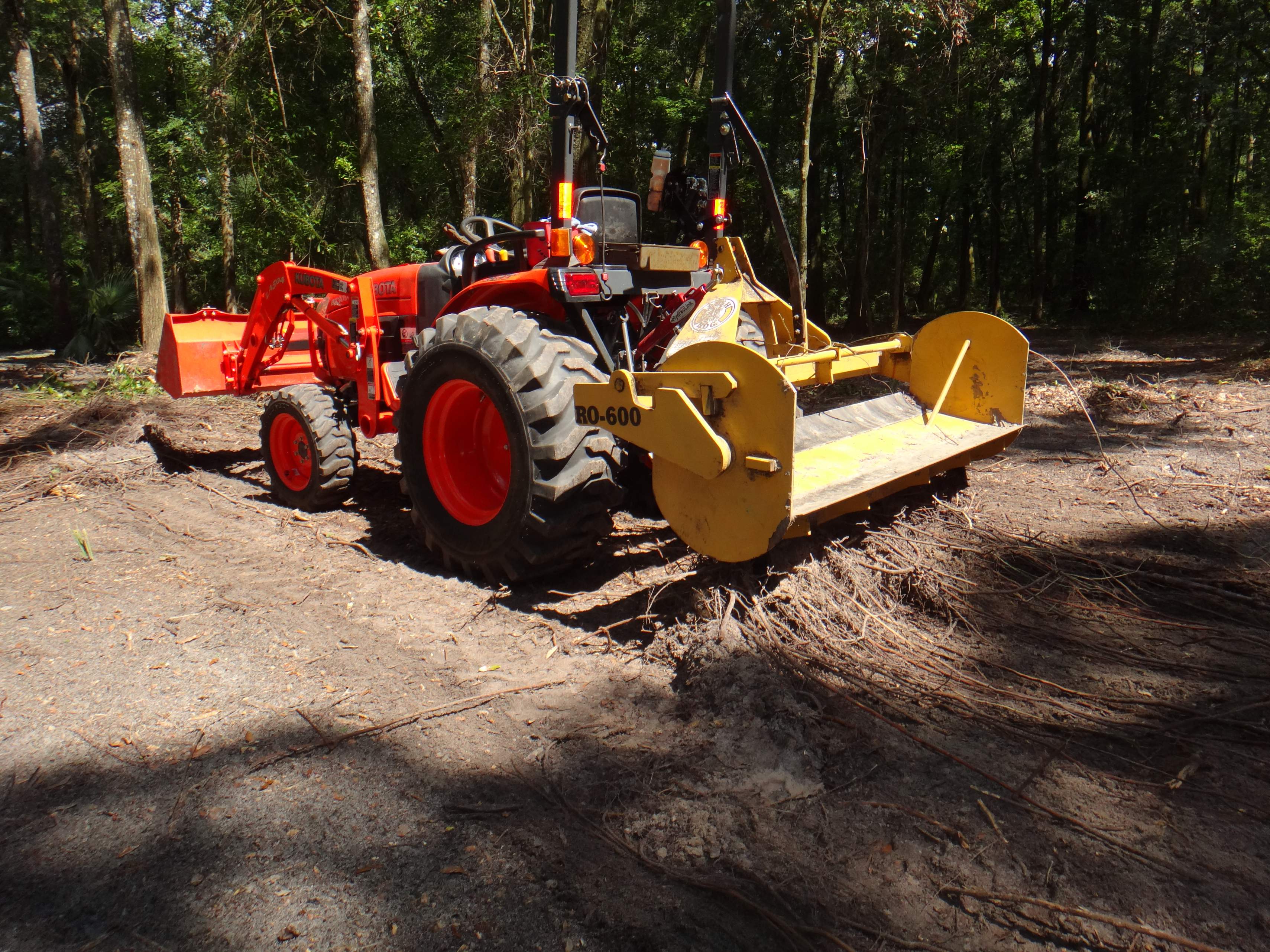

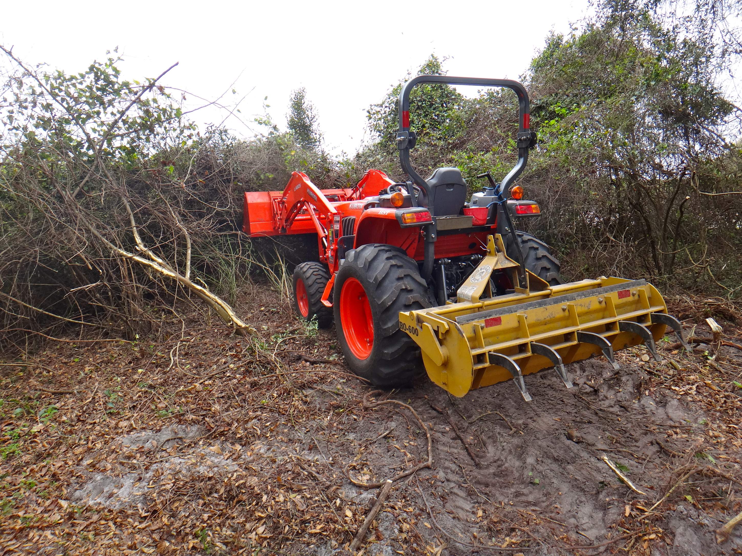

Tractors are fundamentally engineered to PULL. Heavy draft force loads should be applied to the rear of the tractor, through the Three Point Hitch, not the FEL.
A Box Blade is what you want. Like all ground contact implements, Box Blades are dependent on weight for cutting force. To be effective Box Blades should weight a minimum of 100 pounds per foot of width; 125 pounds per foot is better.
There is a pin adjustment, on the stirrups at the lower ends of the right and left Lifting Rods, which raise and lower the Lower Links of the Three Point Hitch. If the pins are set in the lower holes, as opposed to the default upper holes, it allows implements to settle 3" to 4" lower. Changing the default setting to the lower holes often helps Box Blades cut, especially when pulling down mounds, where front of tractor is down, raising rear of tractor and rear mounted implements.
A Rollover Box Blade, which has rippers built in, is preferable if you do not have rear hydraulics. A Hydraulink Top Link is useful with a Box Blade, in lieu of a standard Top Link.
LINK: Google

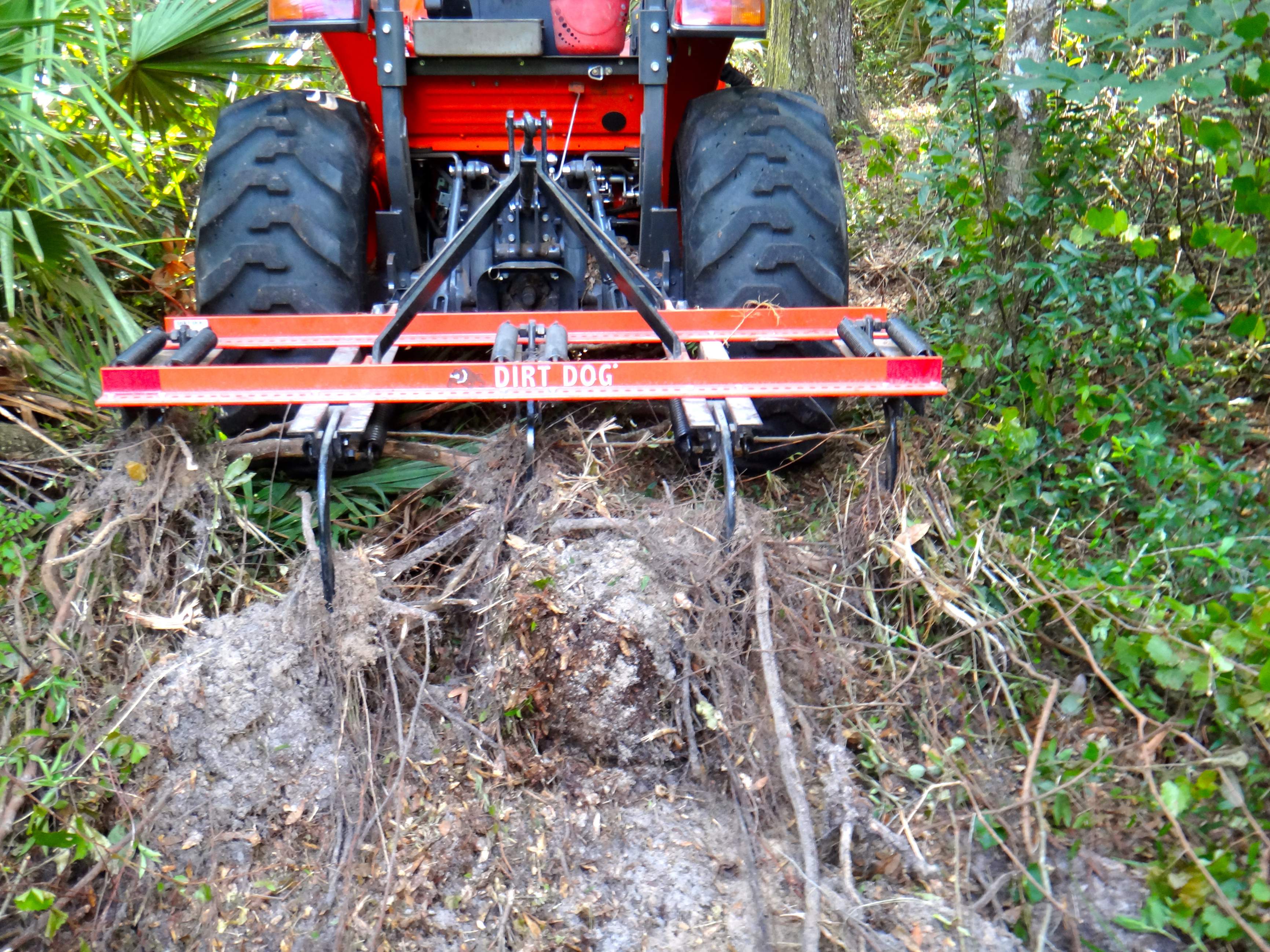

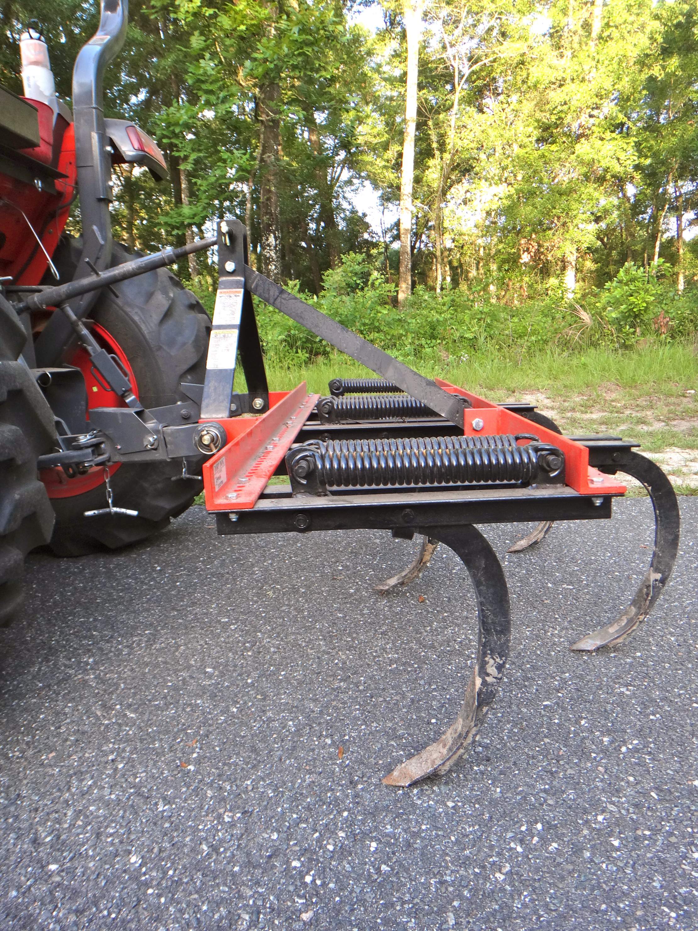

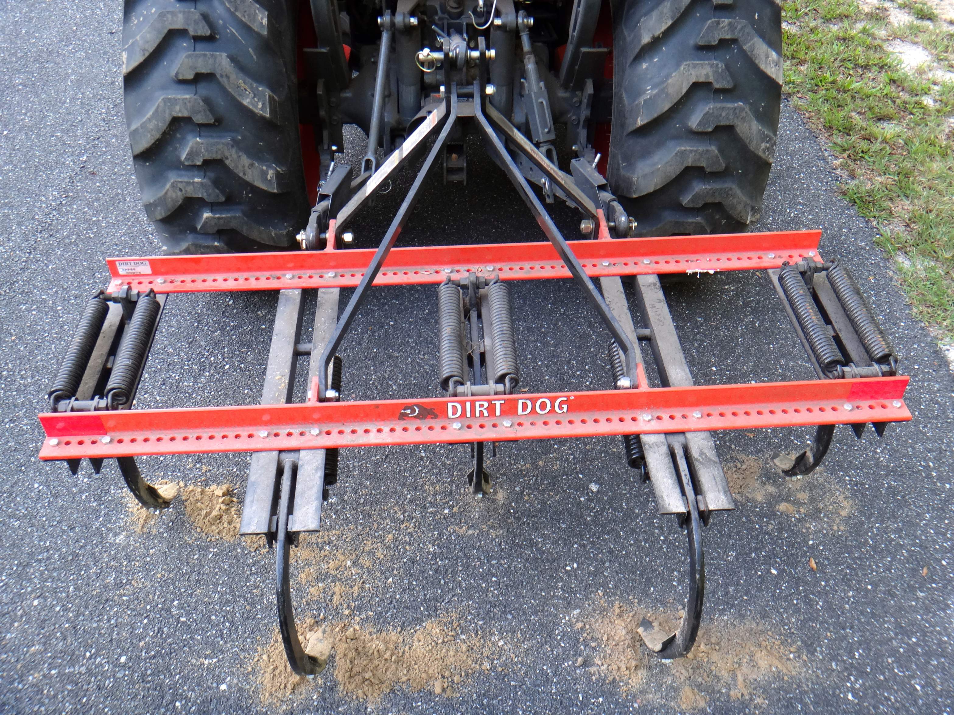

Also consider a Field Cultivator (AKA: All Purpose Plow) for deeper penetration but slower earth moving ability. A Field Cultivator requires less power to pull than a Box Blade. Filed Cultivators are versatile implements. No need for a Hydraulink Top Link.
VIDEO: How to Use a Ripper / Field Cultivator - Gardening Series - YouTube
