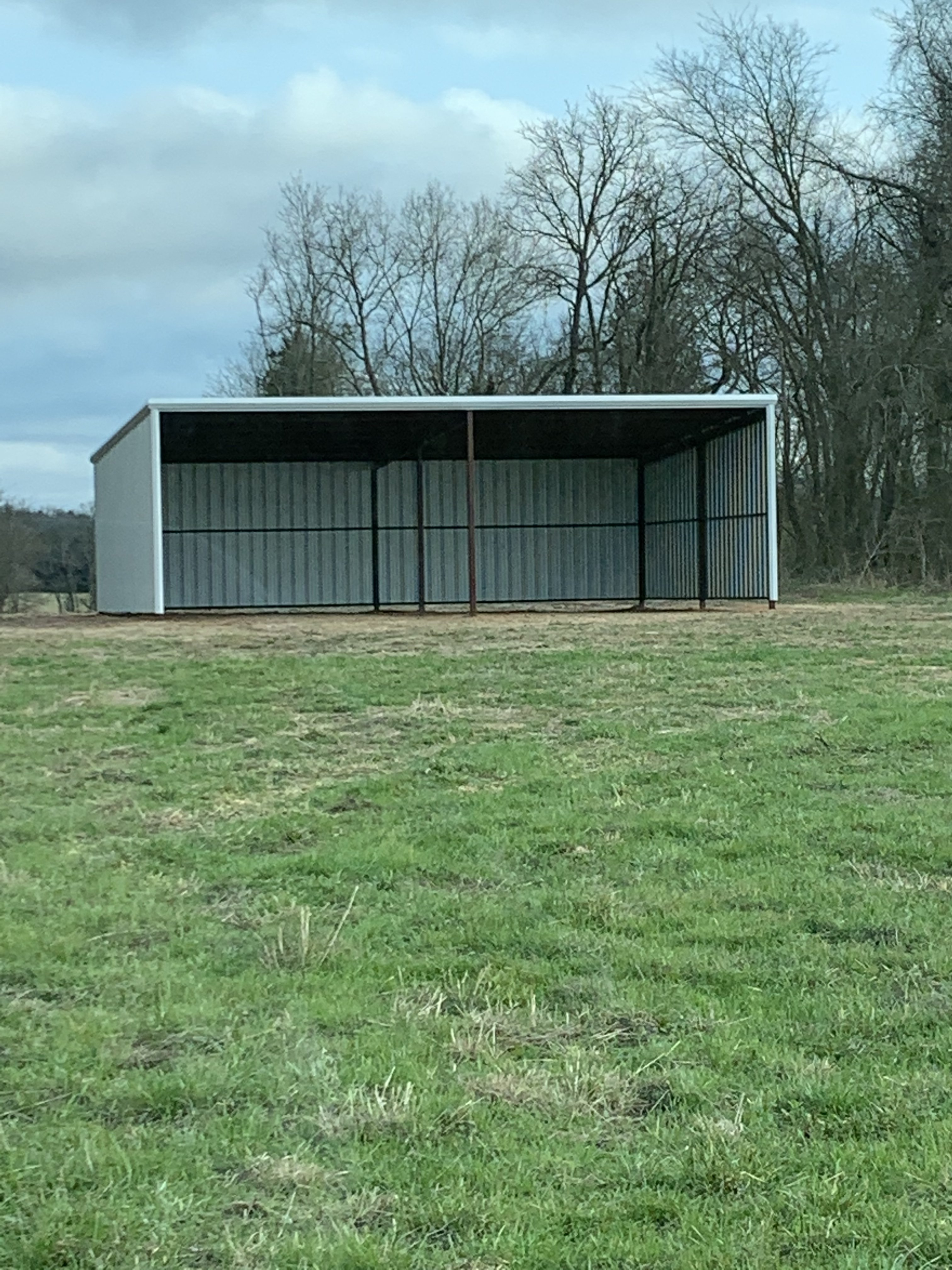

There’s gonna be nothing Low Cost about a 30x40 fully enclosed building with doors. I looked at the Versatube Standard Kit 30x42 and it was $19,600. And I doubt that was with doors. I just had a 30x40 lean-to built locally with 3 sides. 14ga square tubing, I-beams, and 24ga Galvalume for $14,000. I looked and looked for the best building with best price. Wood structures are now more expensive than steel. It was a tough decision on what I was gonna do. I’d LOVE to have a 30x40 fully enclosed with a concrete slab, but this is all I could afford right now. And I’m not complaining. It’s just the steel and wood market are Crazy right now. Absolutely Crazy, I tell ya! ! ! Oh yeah, and your gonna fill that thing up Muy Pronto with a tractor, atv, motor home, and boat.
i hear you. Materials are getting crazy. I should have done this a couple of years ago, but I just decided to get a new tractor and am finally running out of room in the shed and garage!
