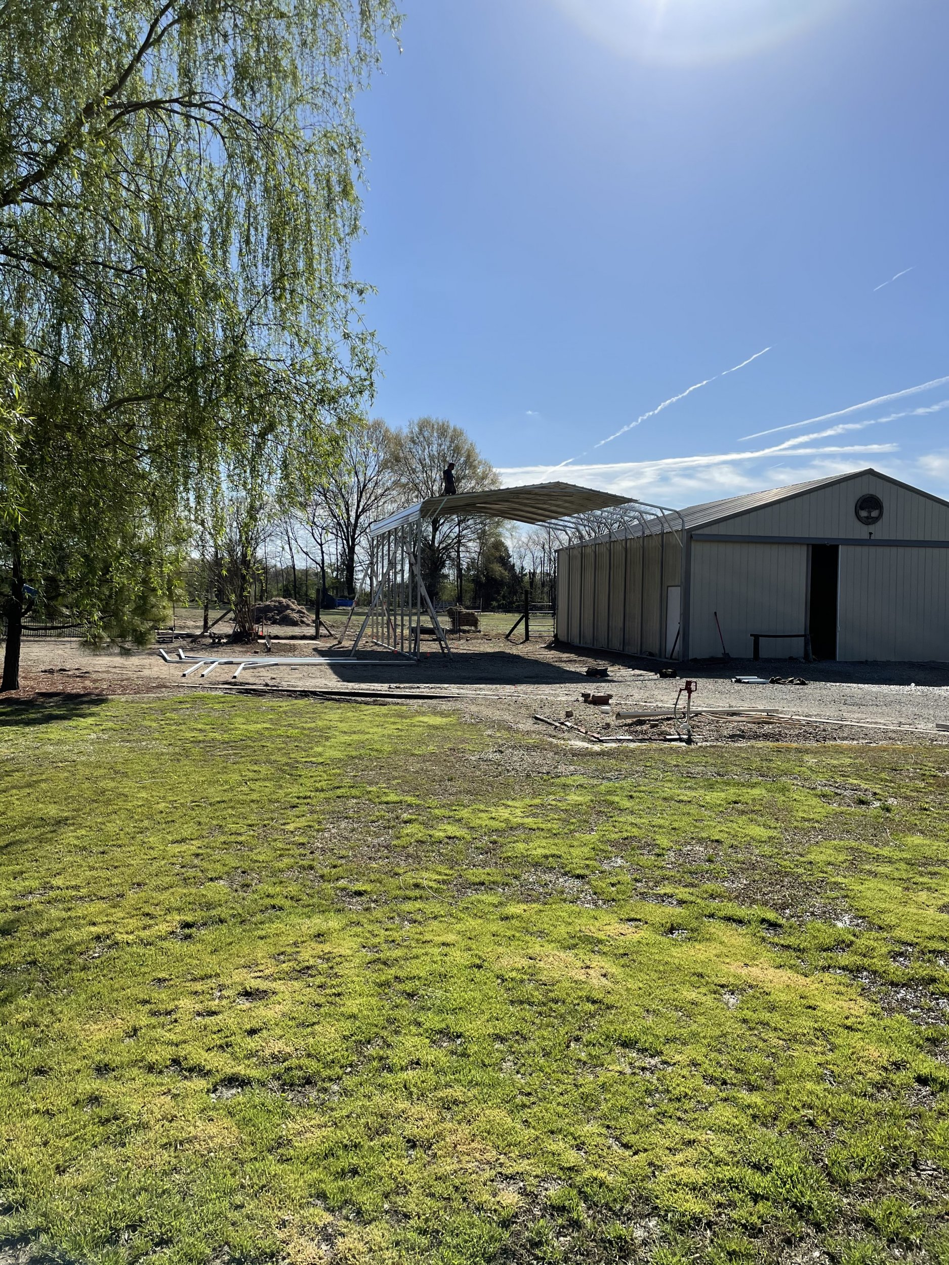

Try garagebuildings.com. Can use 3D builder to design and price out. They are building my RV/Tractor barn now. Only place I found that you can add a lean too
