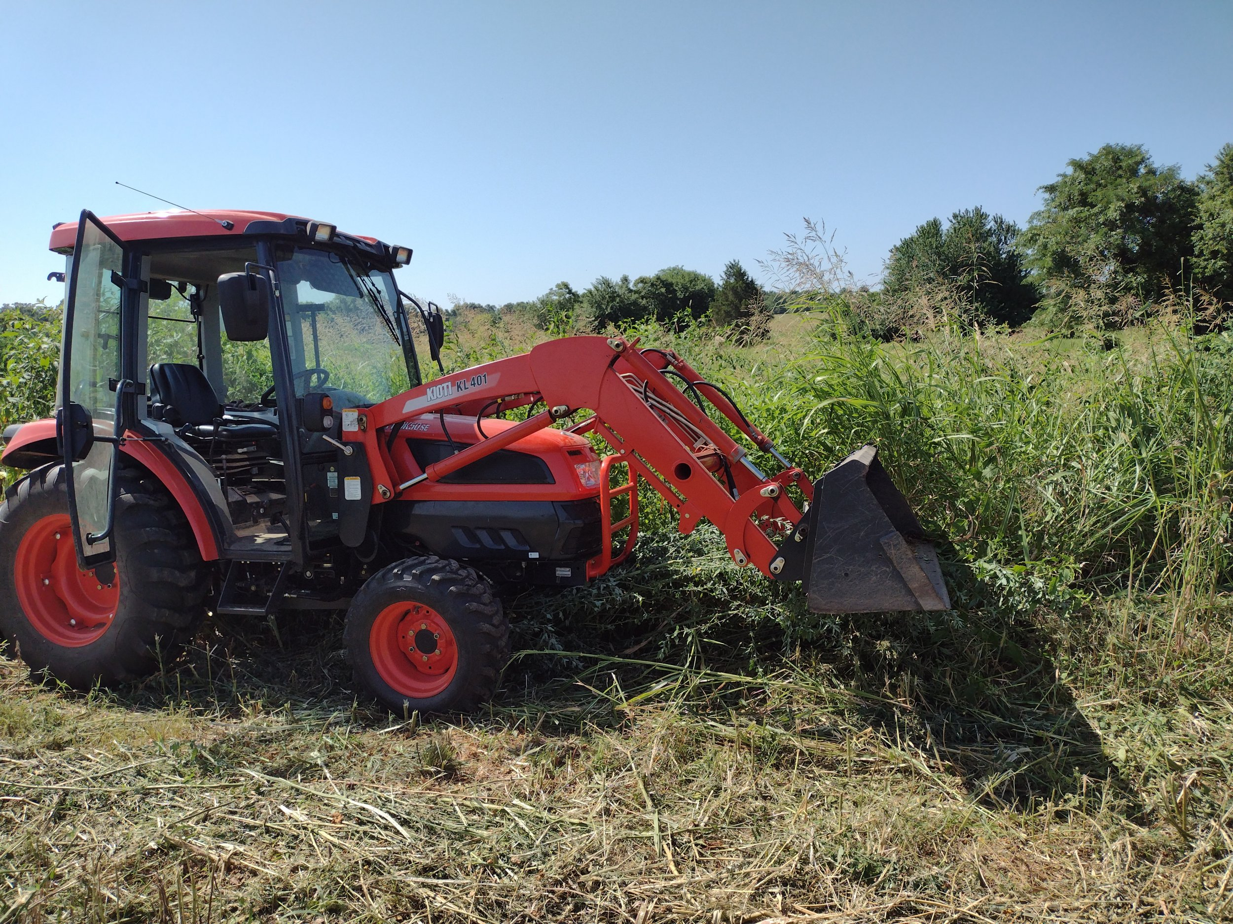

OK ... I only had 1 acre remaining to mow today. This would be enough, given the experience of the last few days, to get the engine over temp.
I am happy to report ... I finished the entire acre without getting above the marked "normal" operation level :) I've attached a pic so you can see what I was fighting.
Just as an aside: Running the AC, even when doing nothing but using the loader bucket, still runs the engine temp up. This has been true since purchased.
Thanks for all the input!
One thing you need to do is remove the bucket. Mowing that tall of stuff with the bucket on causes the bucket to fold it over and folding it over causes even more chaff to be produced. Either than or raise it above the level of the stuff you are mowing. Running the ac will always cause the engine to warm pretty quick. The AC condenser which is in front of the rad is shedding it's heat into the rad no matter what. One thing I did with my Kubota's is I added a 12 volt automotive cooling fan in front of the ac condenser and I run it whenever the ac is operating. That helps the condenser shed heat and keeps things much cooler in the cab when toe motor is idling. Every heat exchanger is totally dependent on the engine fan for air flow, from the rad to the ac condenser to the transmission cooler and in my case the air to air heat exchanger.
