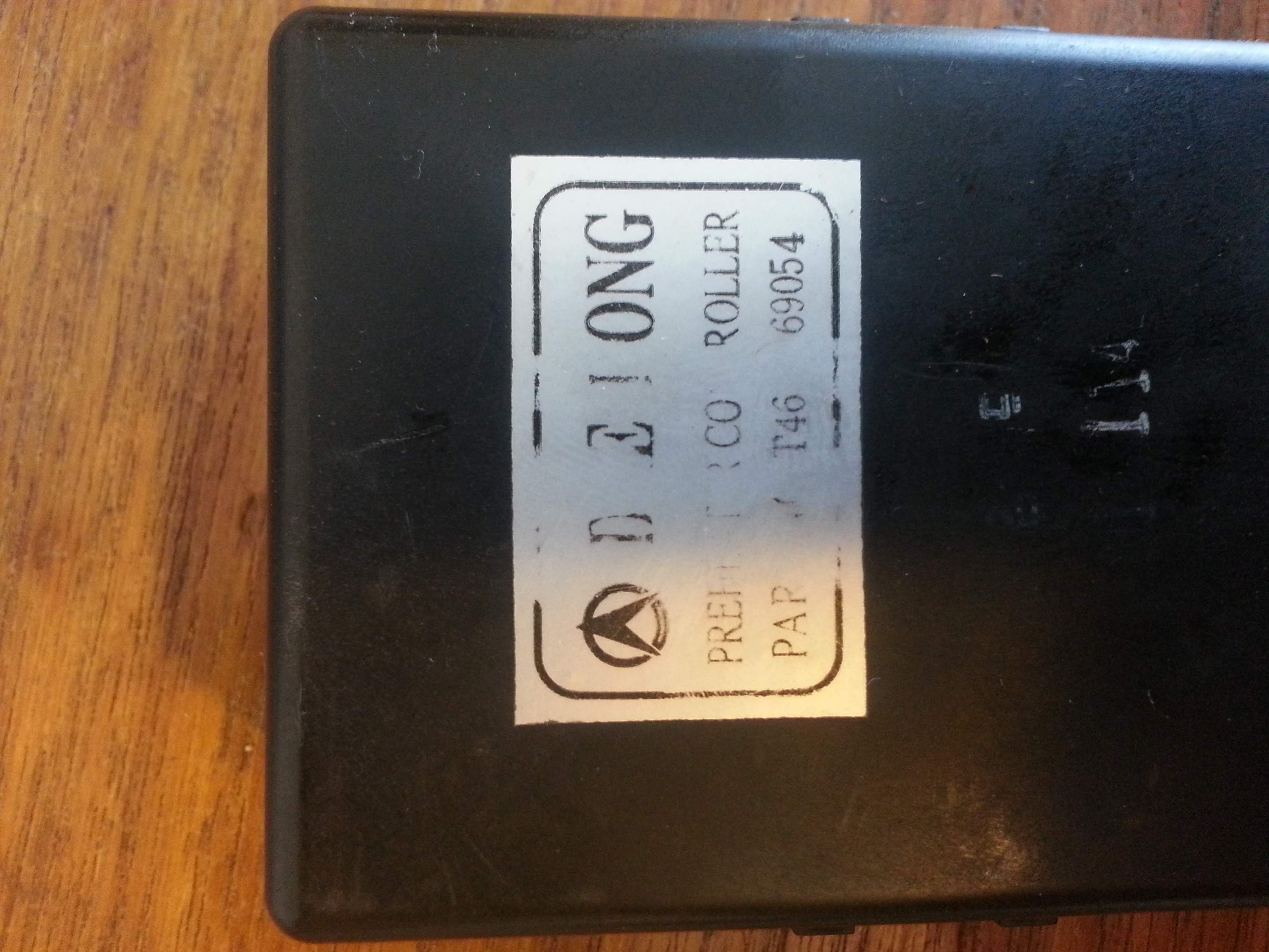

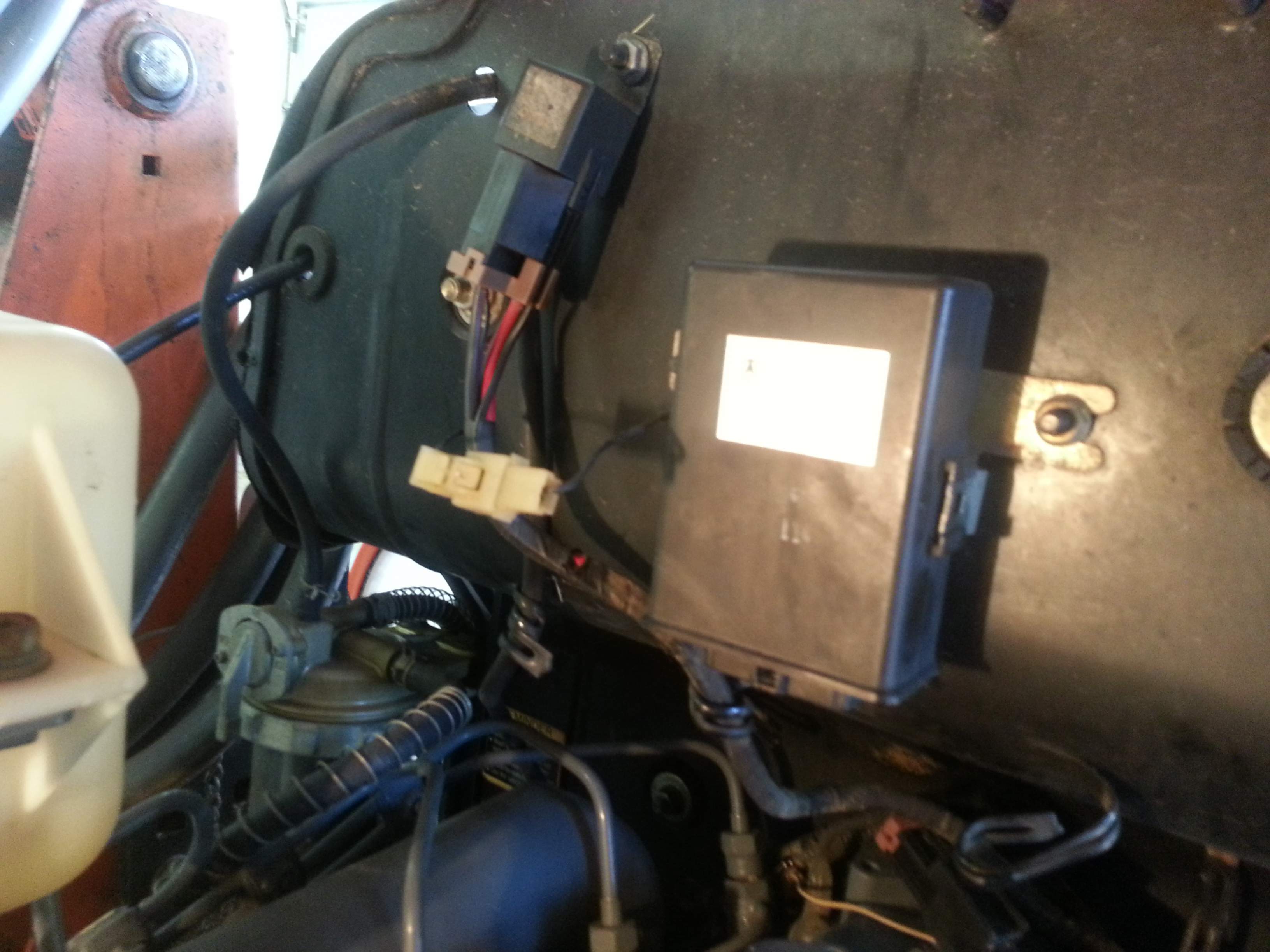

OK...This is the second time i'm typing this....Update MORe....I disconnected the connector from the module (see pics) then jumped the main fuse. I turned the key to the on position and it didn't get hot...I couldn't start it because the starter would not engage...Probably from disconnecting this module??? Is this the problem or can it be deeper in the spaghetti wiring???? Progress !!!!!! Just looked it up...This is a pre-heater controller....How can I test it?

Keep in mind when the Glow plugs go into the pre-heat cycle, and that cycle is controlled by this module, that the glow plugs draw a bunch of current, probably greater than 50 amps and you might expect some temp rise of the wireing. Remember they are supposed to be on for a few seconds prior to you starting the engine (pre heat) and atcually they are are on for a few seconds after the engine starts also (post heat) even if the indicator does not show that. So bring us up to speed, here, If you replace the 60 amp fuse, it blows when? you didn't answer that question. and when you disconnect the wiring to the alternator it does what? blows? stays intact?. Please bring me up to speed as to what exactly we are fighting, and do you have the workshop manual?

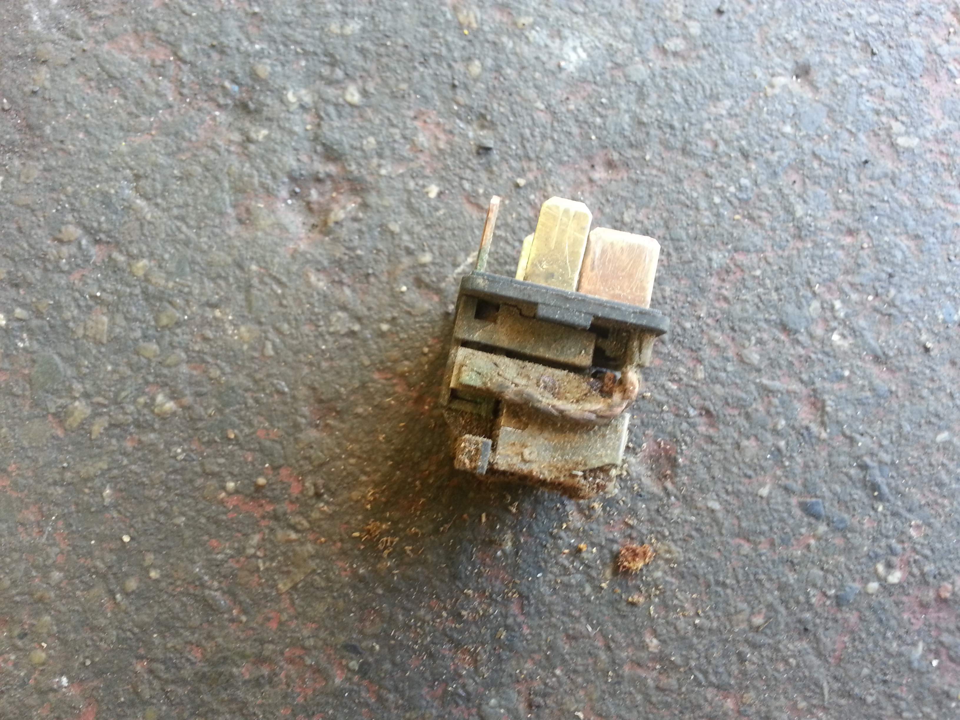

OK....As you can see by the rats nest I've created I have some wire wrapping to do. So...Here's the solution..I swapped the relays for a second and the tractor started and stopped. After all of this it was the 70 amp Relay for the starter. I called my local Kioti dealer (1.5 hours away) and he had the relay and more 60 amp fuses. I spent 3 hours on my motorcycle to get the parts...Nice day to ride....After replacing the relay and putting a new 60 amp fuse in,,,it works...I had tested all the relays, but evidently it was bad....See the pics below....
Thanks to CM, K0oa, rich and especially Jim who I was able to call for guidance...Thankx to all!!!!!
