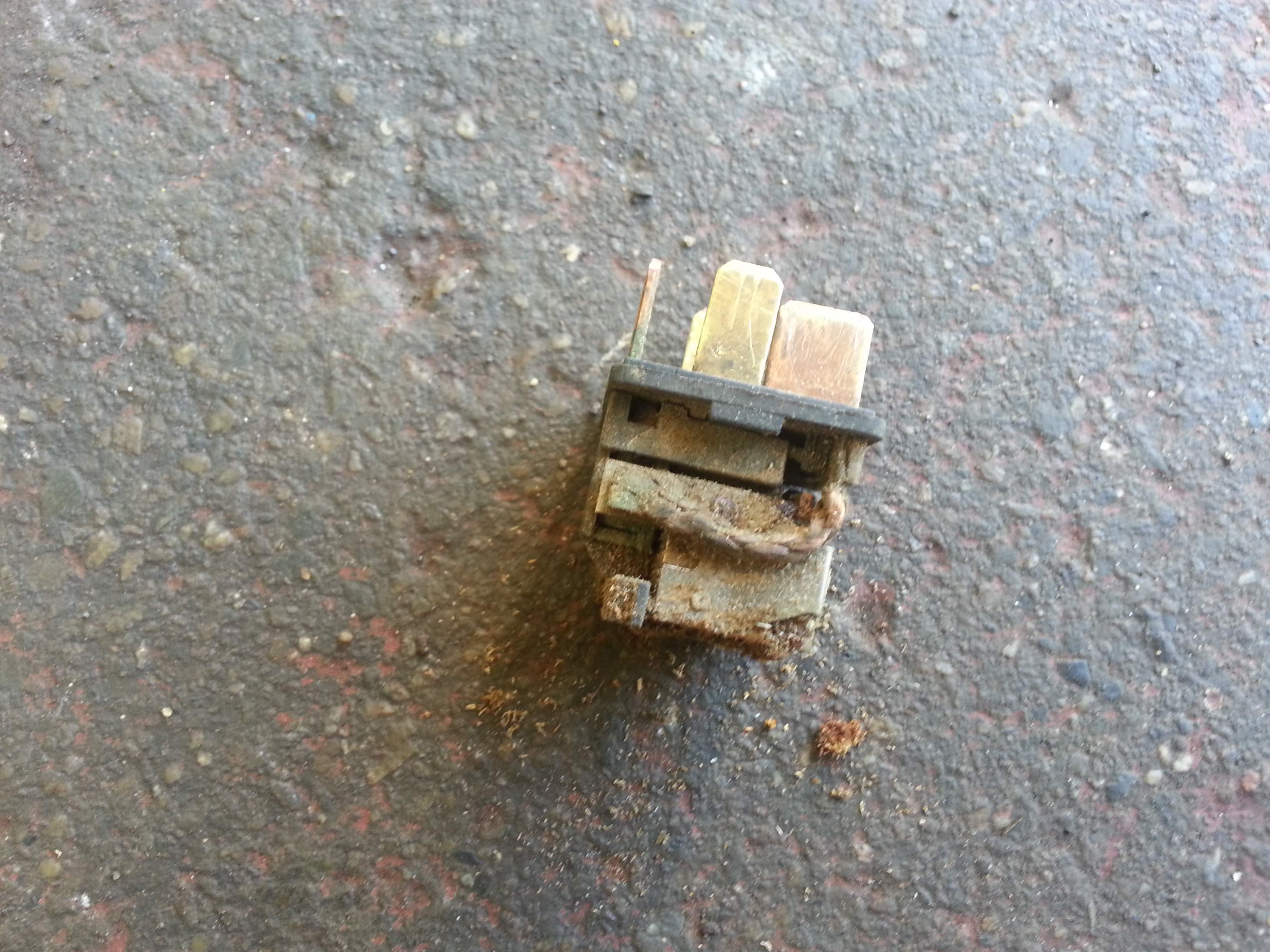

Today I put another battery in the Kioti. I also took the damaged connector out and tied the wires in individually. What's happening is the 60Amp fuse is blowing and the wire gets really hot...I removed most of the wire wrap looking for a short and not finding one yet...It's driving me up a wall. I removed all the body panels around the steering box for better access.....Could a relay behinf the dash cause this...Any other Ideas?

Why another battery? I take it that the damaged connector you took out is the female under the floorboards? Show pic or explain what 'tying the wires in individually' means. The only relays I'm aware of are on the firewall, not behind the instrument cluster. "What's happening is the 60Amp fuse is blowing and the wire gets really hot..." When is this happening? Do any relays get hot too? Is this when cranking the engine? After it is running? Have a fire extinguisher nearby just in case. And disconnect battery ground cable when not actively working on fixing the problem. I'd try disconnecting one relay connector at a time to see if it changes the symptoms; note: this suggestion is based on NOT knowing when the 60 Amp fused lead is hot.

Ok...Update,.....I tested all the relays and connections behind the dash by un-hooking them and then trying the ignition....Still the same, no lights on dash and the 60 amp fuse (jumped) is still getting hot. I them disconnected the alternator cables and turned the key and the lights on the dash come on. The fuse is still hot and when I turn it to start it the started does nothing. I feel like i've made some progress but not quite there yet. HELP!

OK...This is the second time i'm typing this....Update MORe....I disconnected the connector from the module (see pics) then jumped the main fuse. I turned the key to the on position and it didn't get hot...I couldn't start it because the starter would not engage...Probably from disconnecting this module??? Is this the problem or can it be deeper in the spaghetti wiring???? Progress !!!!!! Just looked it up...This is a pre-heater controller....How can I test it?

Keep in mind when the Glow plugs go into the pre-heat cycle, and that cycle is controlled by this module, that the glow plugs draw a bunch of current, probably greater than 50 amps and you might expect some temp rise of the wireing. Remember they are supposed to be on for a few seconds prior to you starting the engine (pre heat) and atcually they are are on for a few seconds after the engine starts also (post heat) even if the indicator does not show that. So bring us up to speed, here, If you replace the 60 amp fuse, it blows when? you didn't answer that question. and when you disconnect the wiring to the alternator it does what? blows? stays intact?. Please bring me up to speed as to what exactly we are fighting, and do you have the workshop manual?

More...I swapped out the 2 relays on the firewall and it starts...Looks like a bad relay...Will test and check

OK....As you can see by the rats nest I've created I have some wire wrapping to do. So...Here's the solution..I swapped the relays for a second and the tractor started and stopped. After all of this it was the 70 amp Relay for the starter. I called my local Kioti dealer (1.5 hours away) and he had the relay and more 60 amp fuses. I spent 3 hours on my motorcycle to get the parts...Nice day to ride....After replacing the relay and putting a new 60 amp fuse in,,,it works...I had tested all the relays, but evidently it was bad....See the pics below....
Thanks to CM, K0oa, rich and especially Jim who I was able to call for guidance...Thankx to all!!!!!
