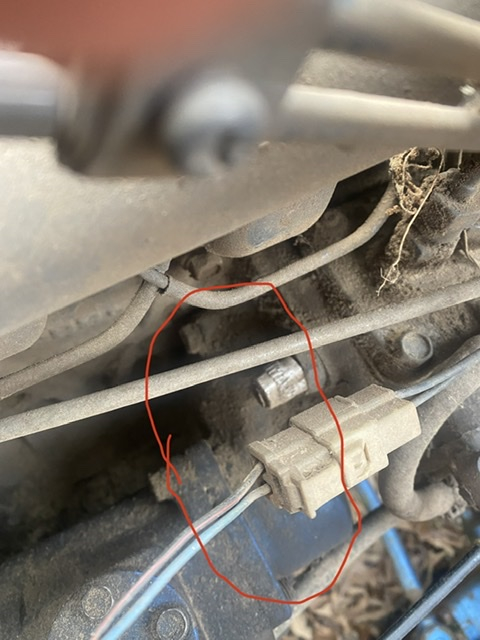

Ok I unfortunately do not have the drive gear I had to use it on my new engine when I replaced it. But this is where I think your problem is. You will have to remove the hydraulic pump again to confirm.
The drive gear is a reduction type gear box mounted to the back of the injector pump. You need to remove the hydraulic pump then remove the gear box and inspect the splines and gears. I will post a picture of what the back of the injector pump looks like and the part I am taking about circled in red.

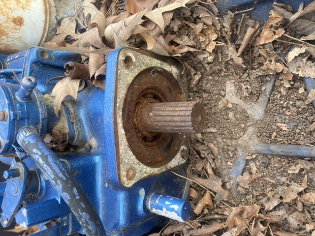

Ok that upgrade pump is now 1400.
How do o text the gear. Visual

If you can find a way to turn the shaft while it is on the tractor that would tell but I do not think that will be easy. If you could turn the shaft then it is bad. No way should you be able to turn it with it attached to the tractor.

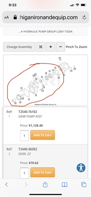

   / Kioti lk2554 #28
Here is a screenshot from the parts diagram. This is the parts I circled that I believe the problem is.
