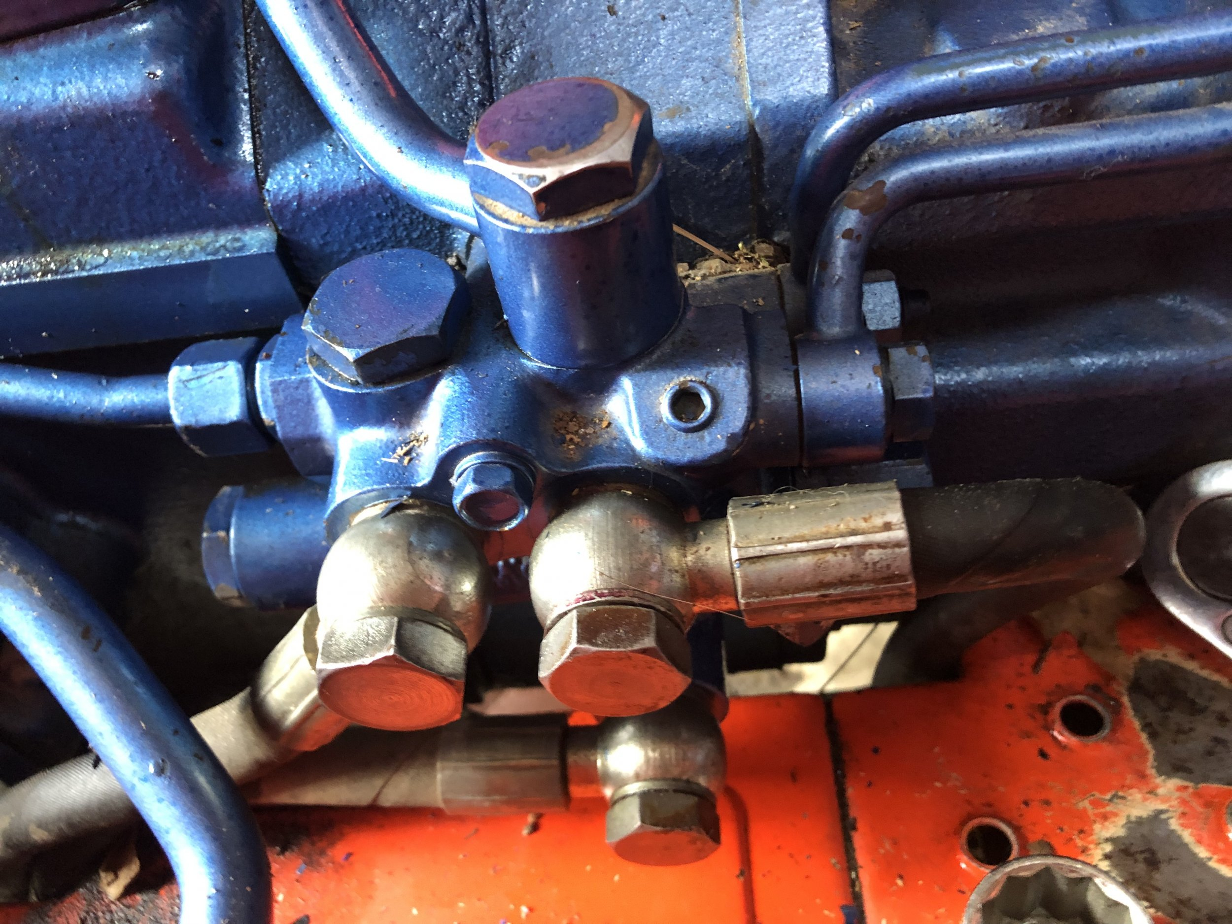

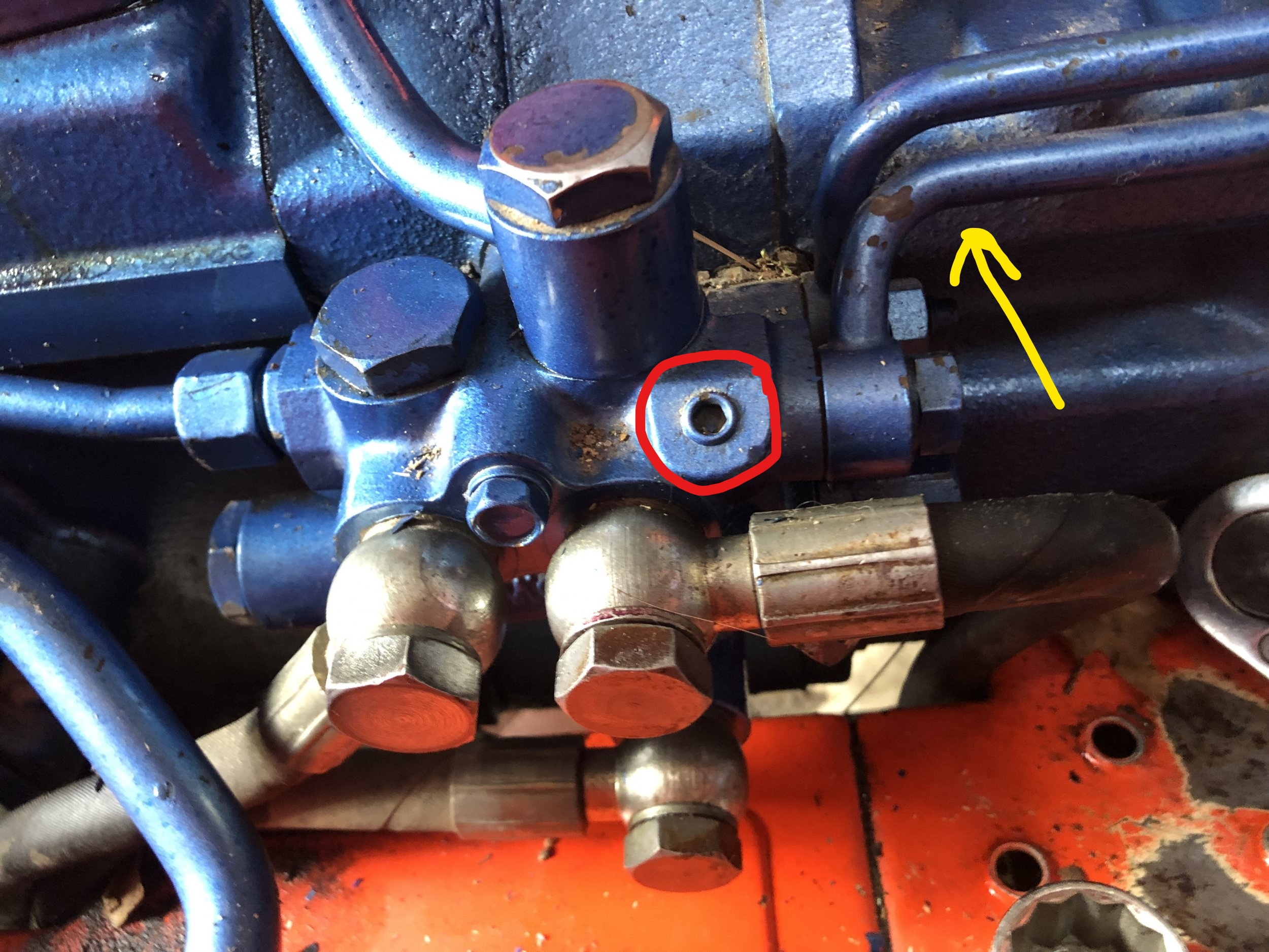

I have a problem with hydraulic pressure. I want to test the psi of the pump at the Auxiliary block on the Sid of the transmission. I need to rule out the pump or the Block itself. Is there a test port in that block?
/ Kioti lk2554 #2
I am not aware of a way to test pressure in the block itself. What issues are you experiencing?
Your block is missing the valve that changes flow to feed the loader. It has a plug where that is on mine. Yours must be a newer model than mine.
/ Kioti lk2554
Thanks I had to call a big dealer then the one by me for help. They had to look it up. There is a port to check the pressure. I’m only getting 200-300 psi. There is no one that I can find that rebuilds these pump. Thank for your help

/ Kioti lk2554 #8
If the line with the yellow arrow comes from the output side of the pump, then the plug on the red circle should be a test port to get readings straight from the pump.
Hard to be 100% sure without a schematic.
/ Kioti lk2554 #9
Those lines feed the power steering. There have been a few guys need to take the priority valve apart and clean. That solved their problem on pressure but it sounds like something else in this case.

#12
Yes I cleaned the two valves. Yes that Allen head plug is we’re Kioti finally told me to test from there
