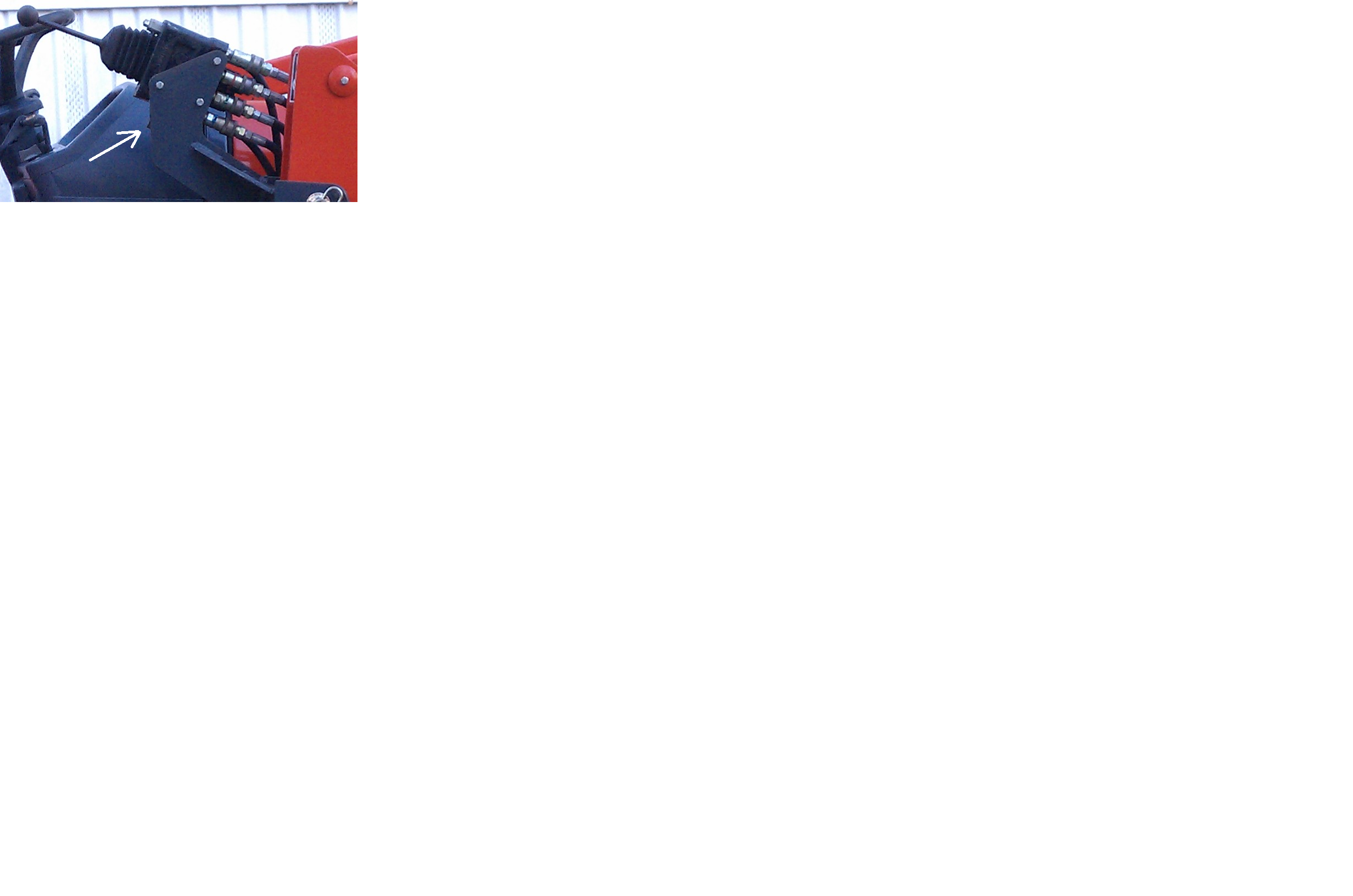

So here is the update. Had a guy come over with some gauges that tapped into my loader. The pressure reading was 2300-2380 the gauge was VERY responsive to the movement of the loader and when not moving it stayed above 2300 soooo I would assume there isnt a leak????
Any way going to attach some photos and one video and see what you all think. The first couple seconds is the noise I hear more often.
The person who came by with the gauges seems to think that the pressure release ( or relieve ) valve needs to be replaced as he seems to think it is having trouble opening/closing??? Any thoughts on that ?
I wanted to post what he pointed out was the valve of replacement.

Main Relief pressure should be: This is for the Later DK45se.. so not sure if that applies to your DK45.
* Main relief pressure: 188.6 kgf/cm2(18.5 MPa, 2.683 PSI)
So it appears your main pressure relief might be low If it should be the same as a Dk45se. I don't know for sure. A shop manual for your exact model would be nice.

I'll see about getting a better video. Mine is a DK 40 and the setting for that loader is 2450 psi
