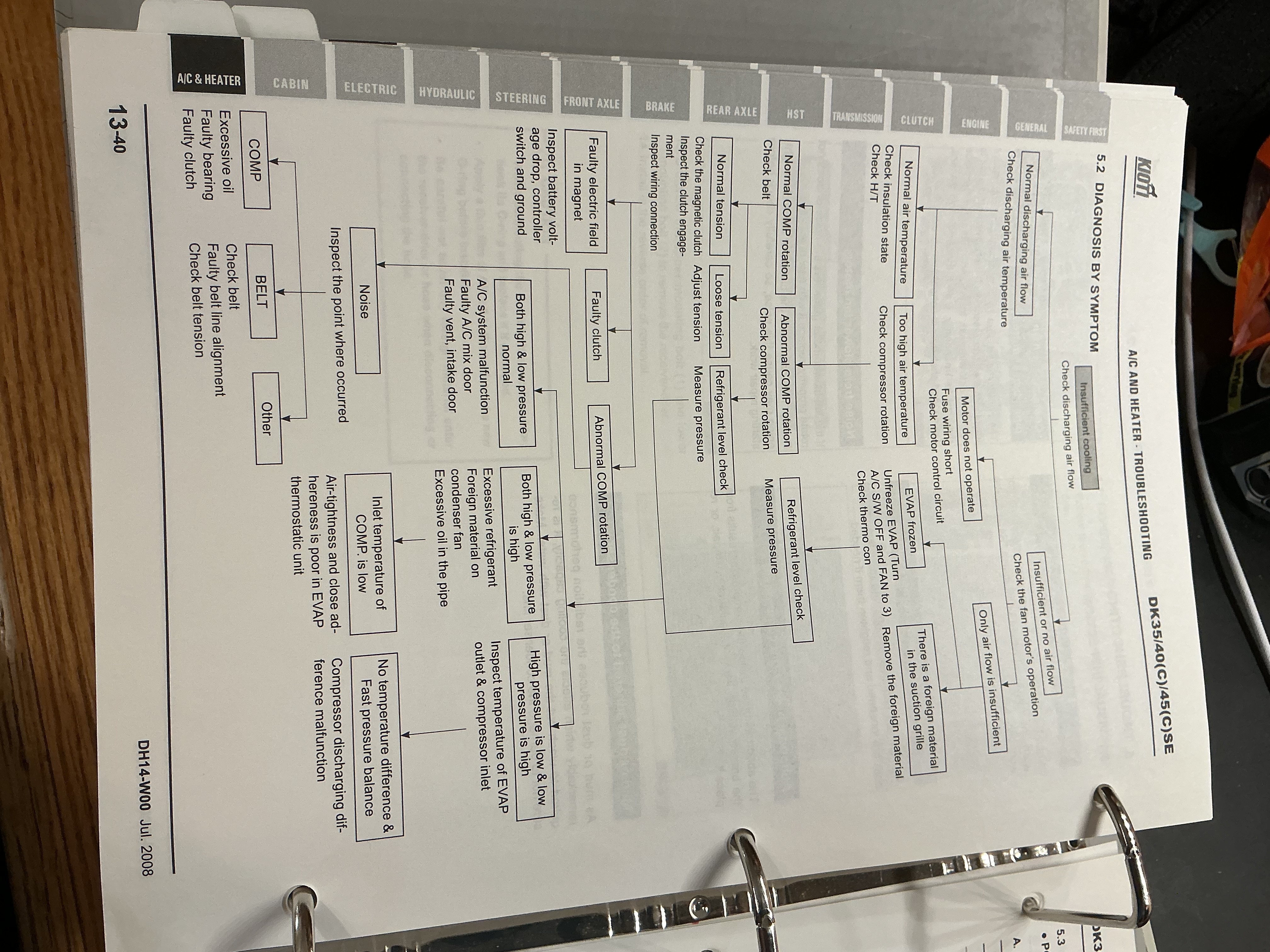

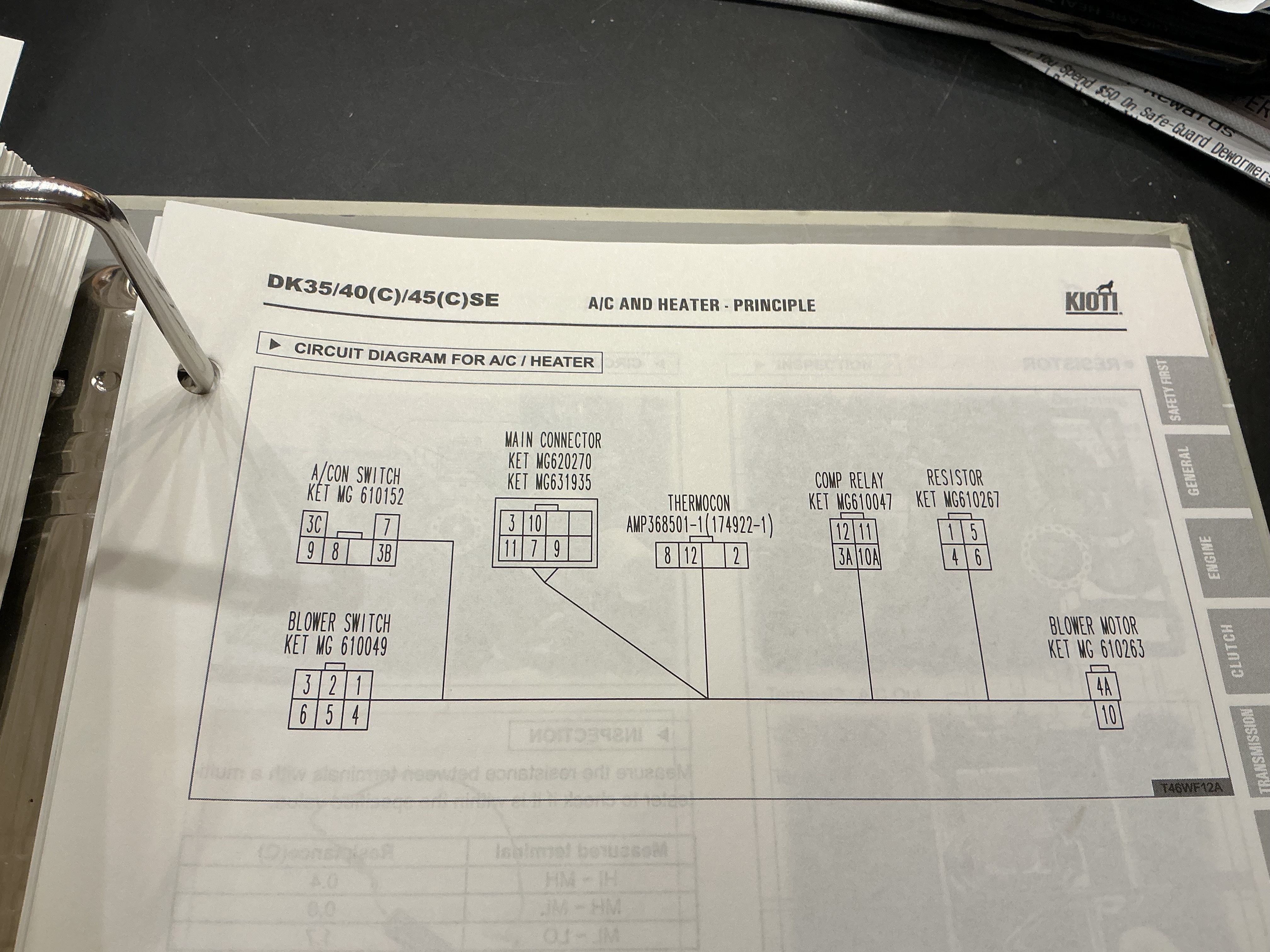

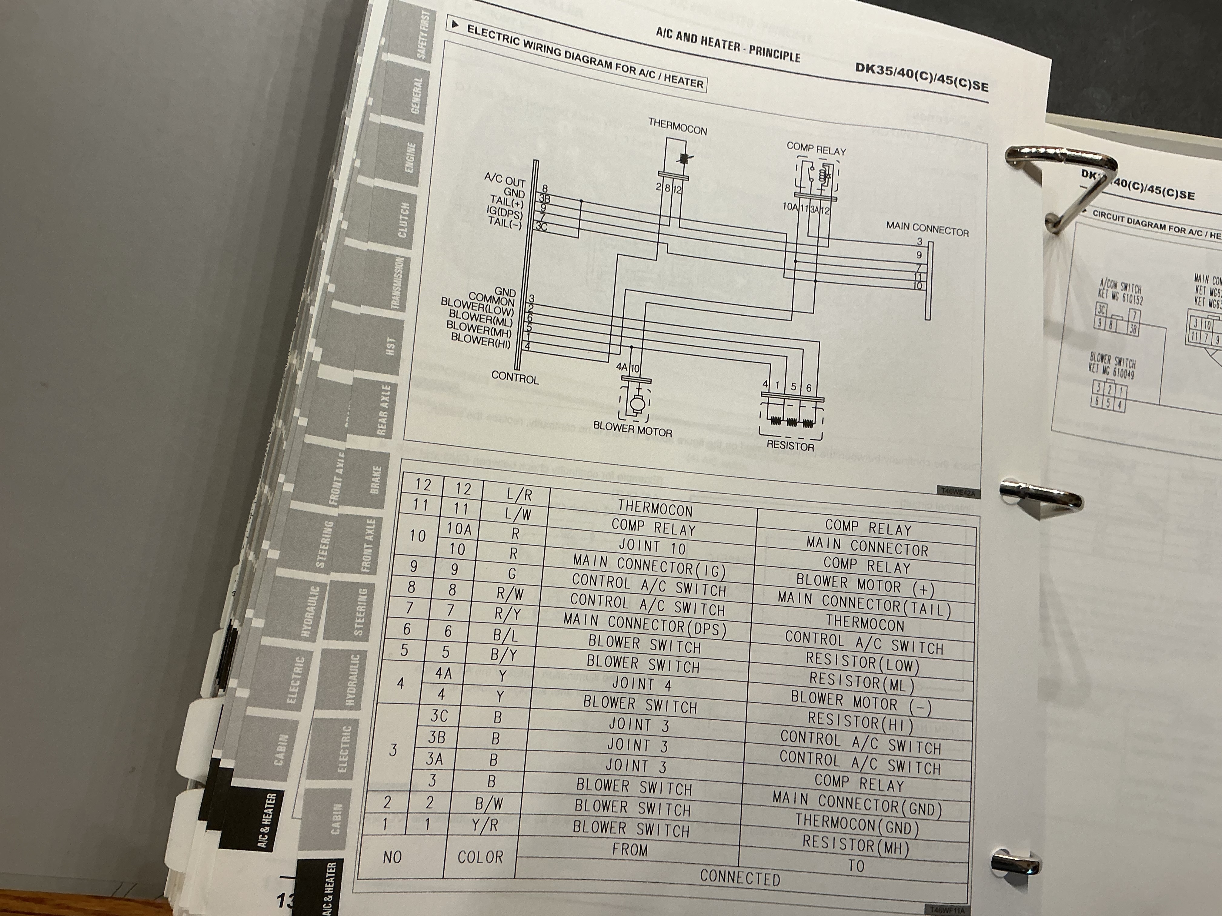

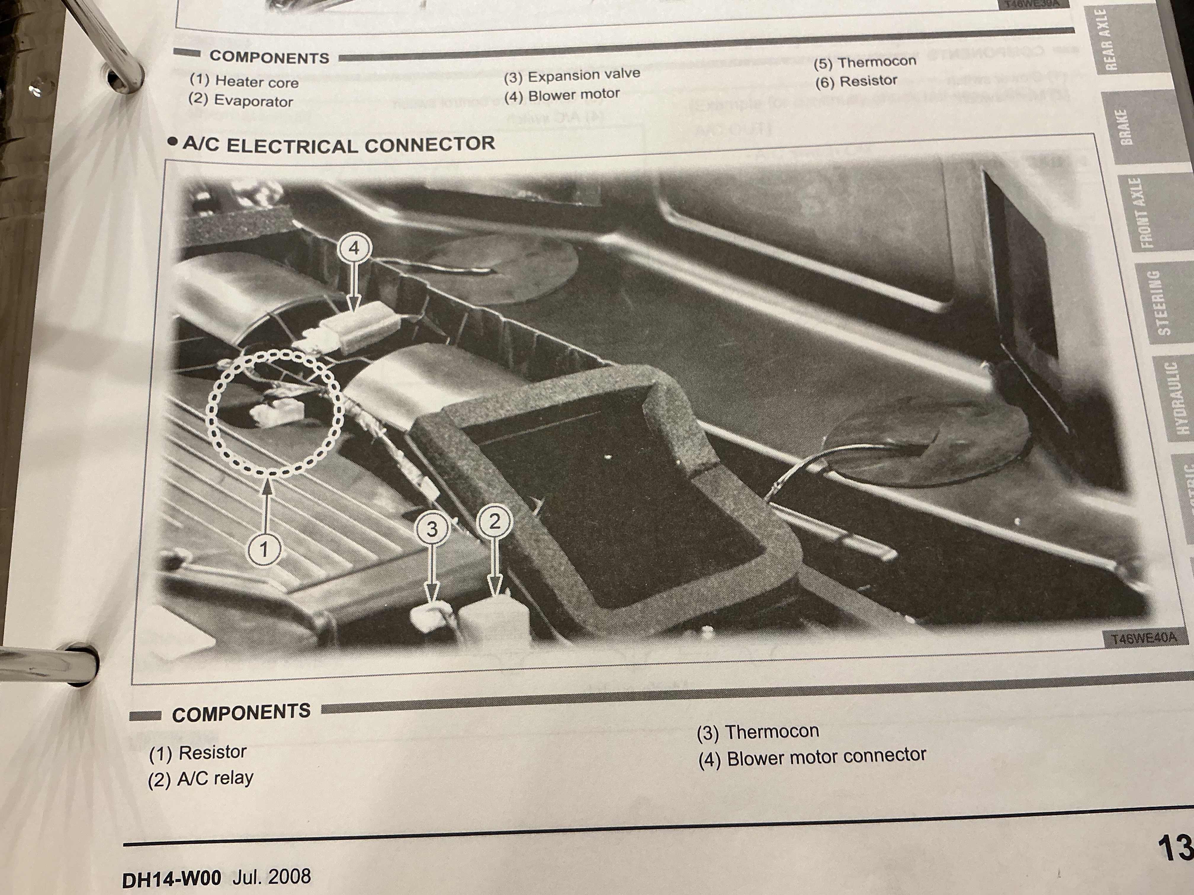

Ok checked the clutch and it is not engaging (not spinning when AC is cranked) did not see any obvious wire damage. Now what do I do?
/ Kioti DK45 AC not getting cold #9

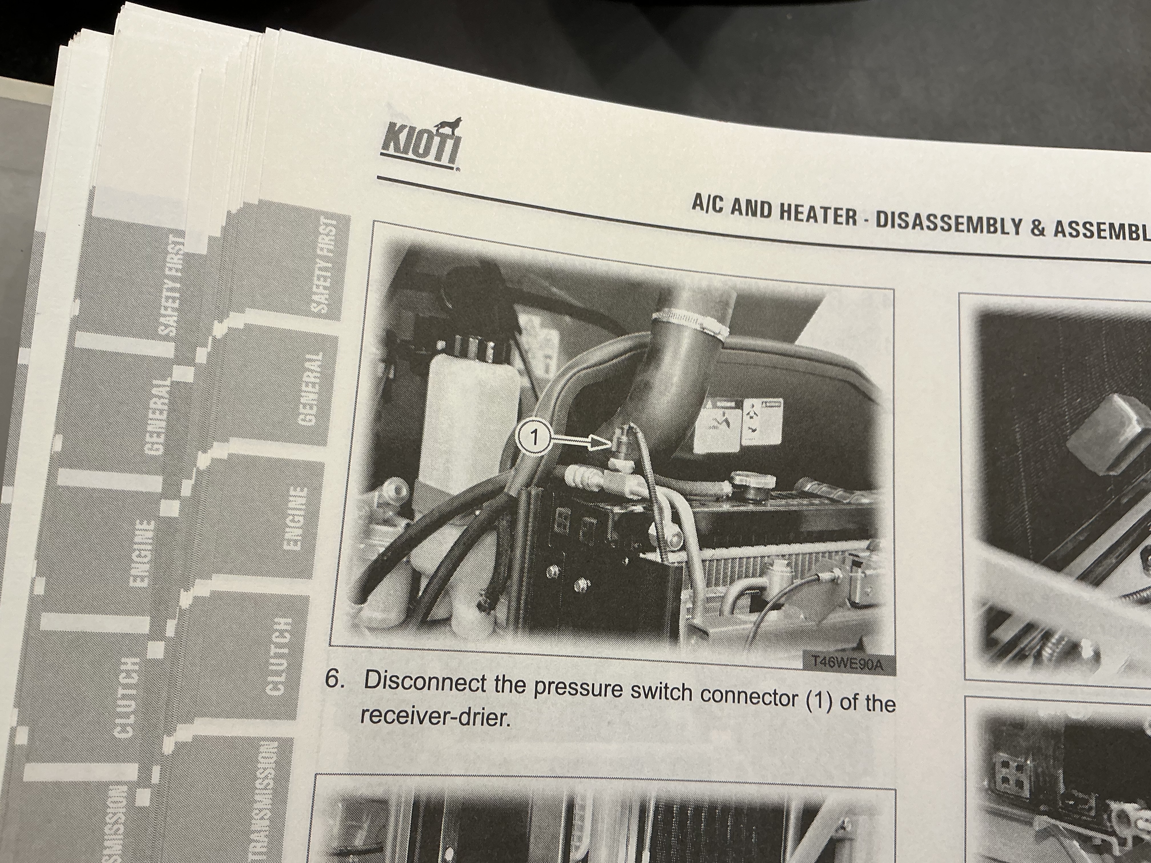

Theres a pressure switch that will kick off the clutch if pressures get too low.
On my unit, pressure was ok, so i traced wiring. I found this micro sized wire that led from wiring harness under shroud on lest side of seat that traveled to the pressure switch in engine compartment. Was open circuit. I ran new wire..all fixed. I swear it was a 30 gauge, hair thick wire. All other wires were nice and thick. Someone cheeped out.
