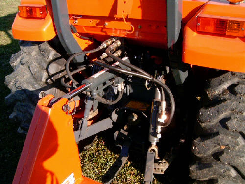

Hi DK35vince:
Your profile says that you've got TnT. Was this a Kioti option or was it added aftermarket?
/ Kioti DK35 vs. GLs from Kubota #11
The rear remotes were a Kioti option.
The top and tilt cylinders and hoses where purchased from CCM (Carter and Carter).
