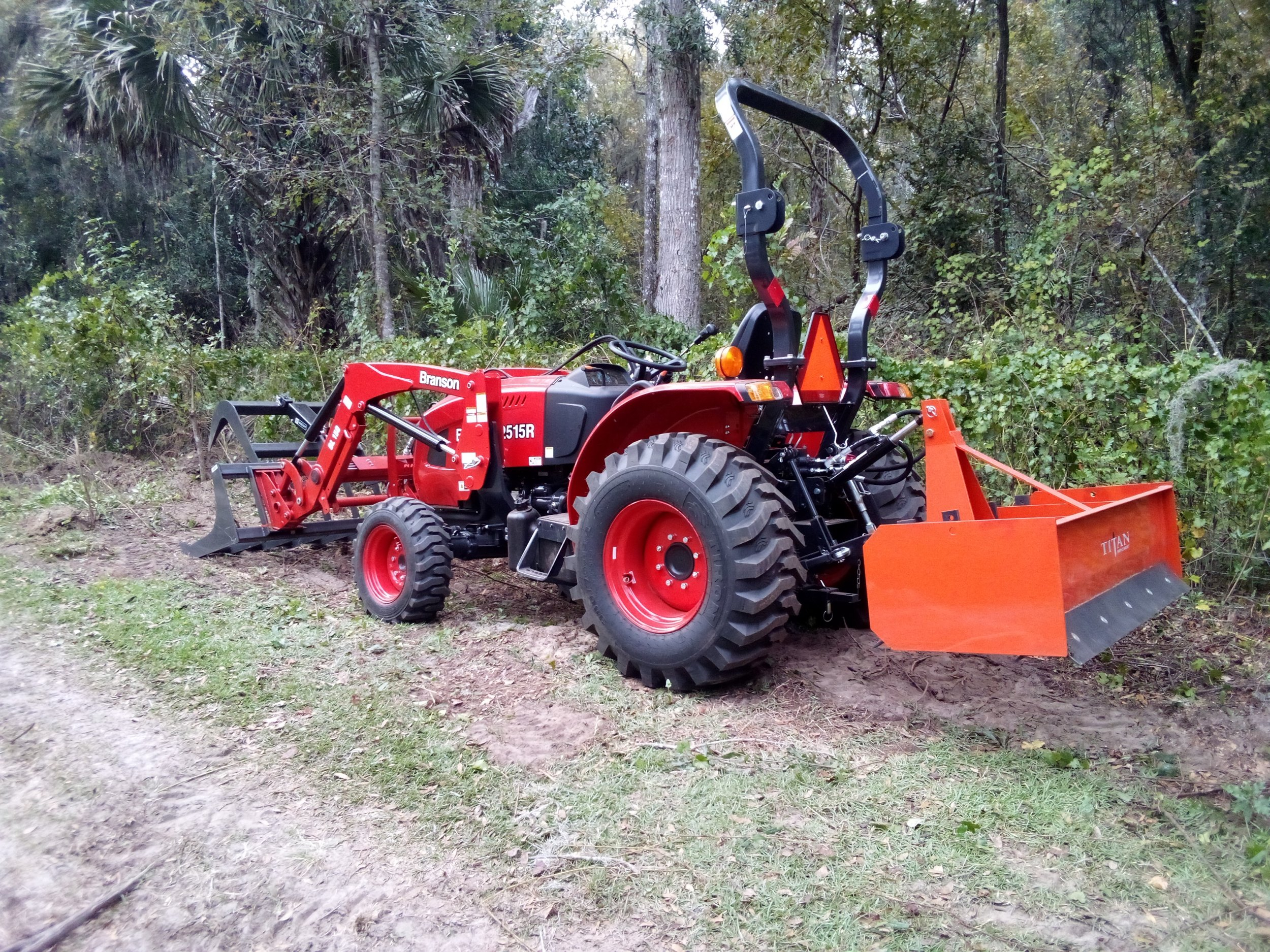

I now have about 32 hours on my Branson 2515R. My soil condition I would for the most part view as soft. Mostly sand. I did some grading with my tractor. I found when hitting some roots like 3" plus. That the 24HP engine in the low gear (low gear is really slow, like i might go back in time slow) had no issue even with liquid ballets tires in rear. It did not bog down. The issue was simply tires would spin in place. Then I would lift up on the boxblade and tines would slip off the root or break the root. Then I would continue on. Weight was more an issue I found than the low 24HP. Over all I'm pleased with my tractor. Jeff9366 thanks for your input was very helpful in make my decision in my purchase of a tractor

When possible, please share some pictures of your machine.
Thank you.
   / Kioti cx2510 vs tym264 vs Branson 2610 h
#69
Thank you.

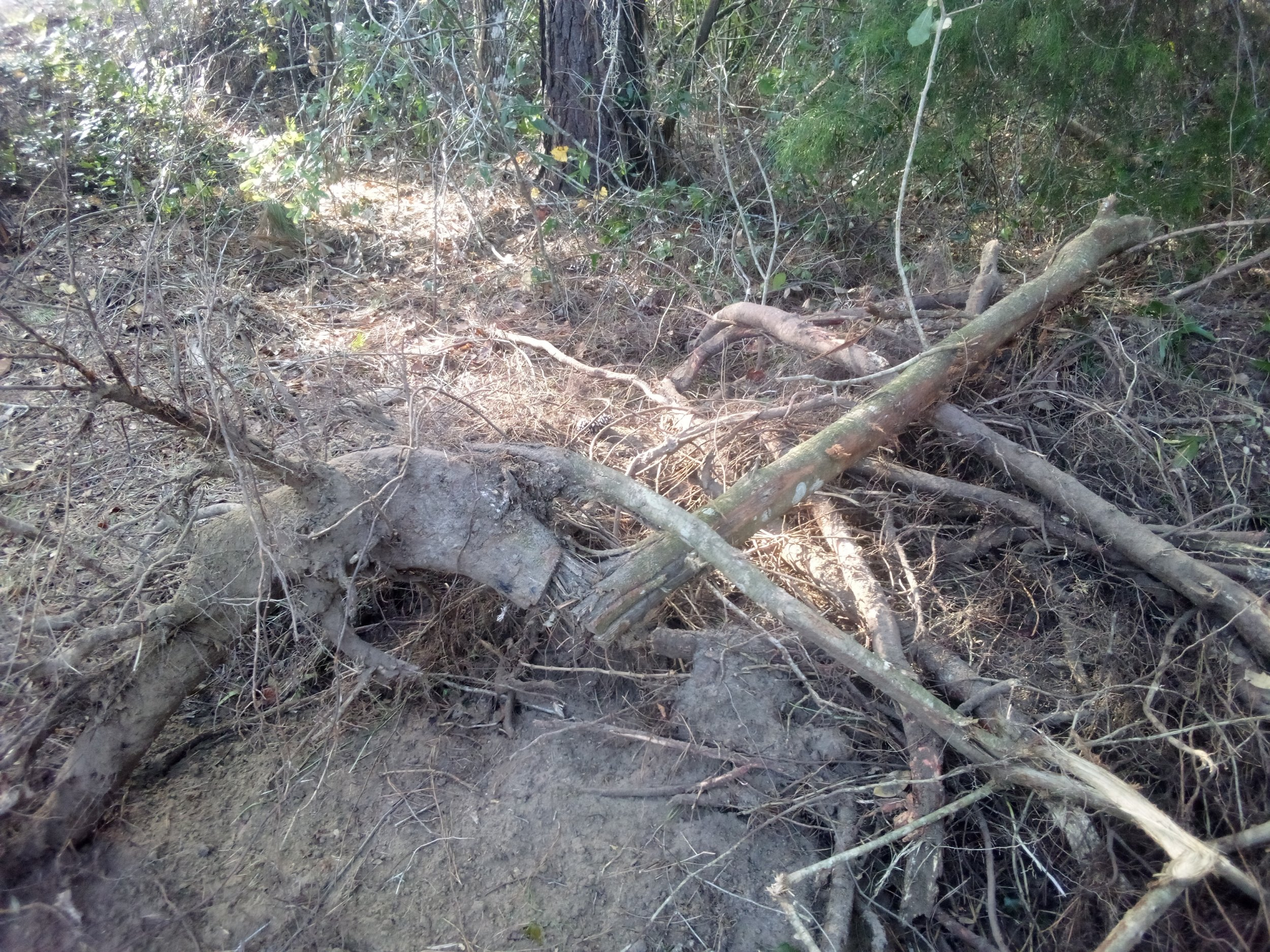

Here's some photos. Getting a little bit more efficient with the grapple. Was able to pull up three and a half to 4 in stump of a tree. Currently have 40 hours on my tractor.
