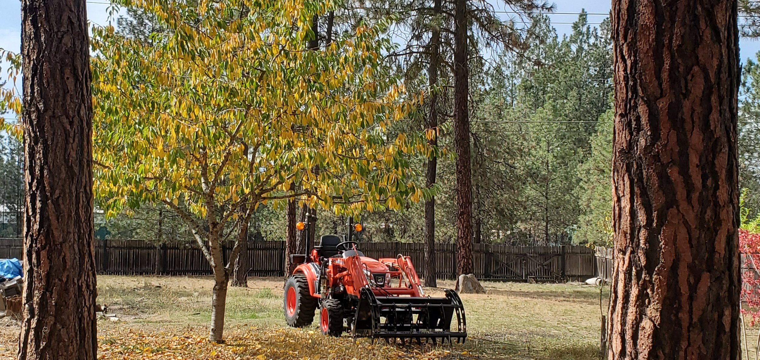

   / Kioti cx2510 vs tym264 vs Branson 2610 h #5
I'm only @ 44hrs but I sure love my CX! I fell for the Ergonomics of it. Everything felt like it was designed by me, for me. Looked at all the others that were available at the time and felt this was the best package. Then the added savings factored into me justifying a Wicked 55 grapple. No issues with the CX yet.
