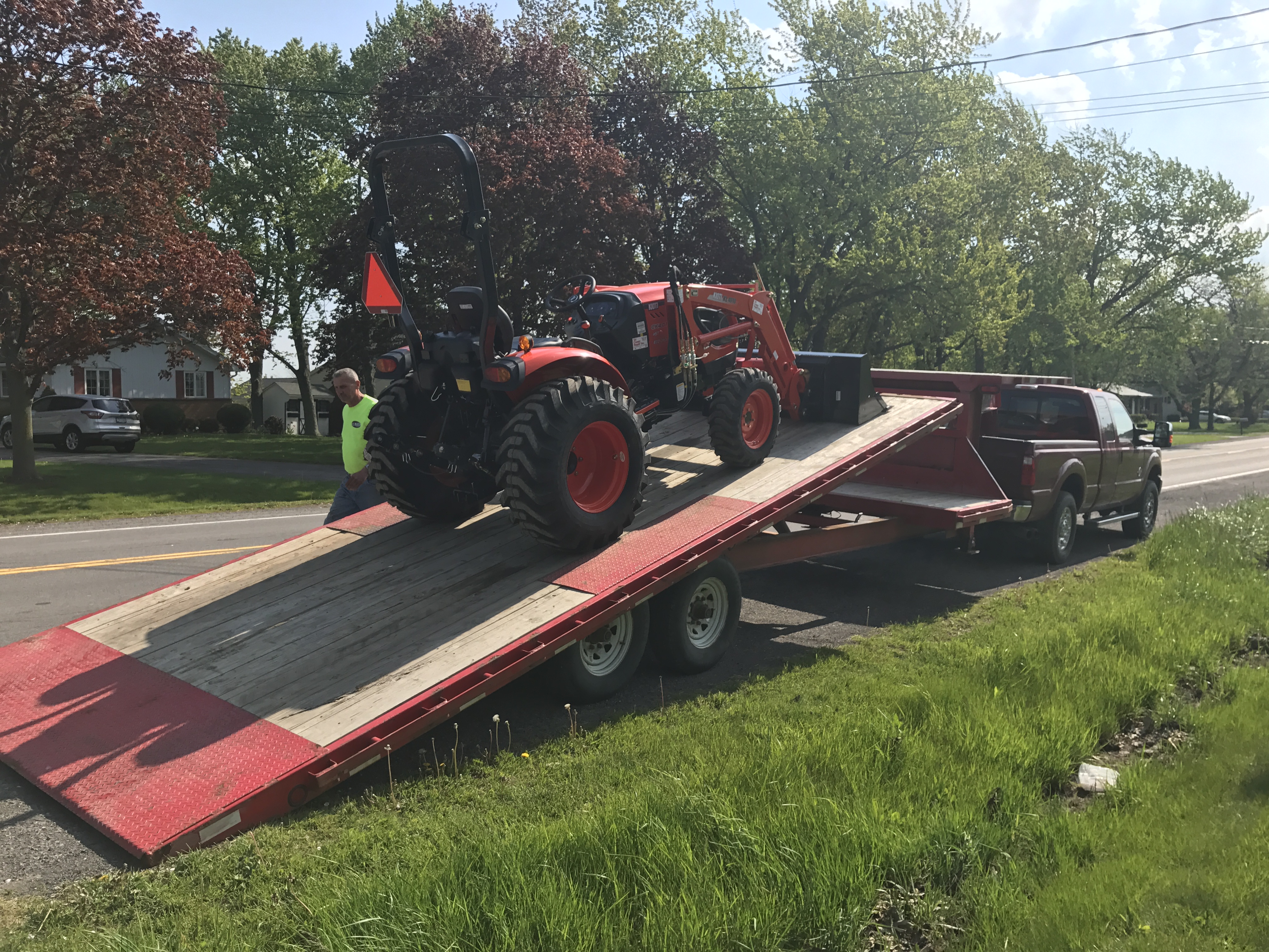

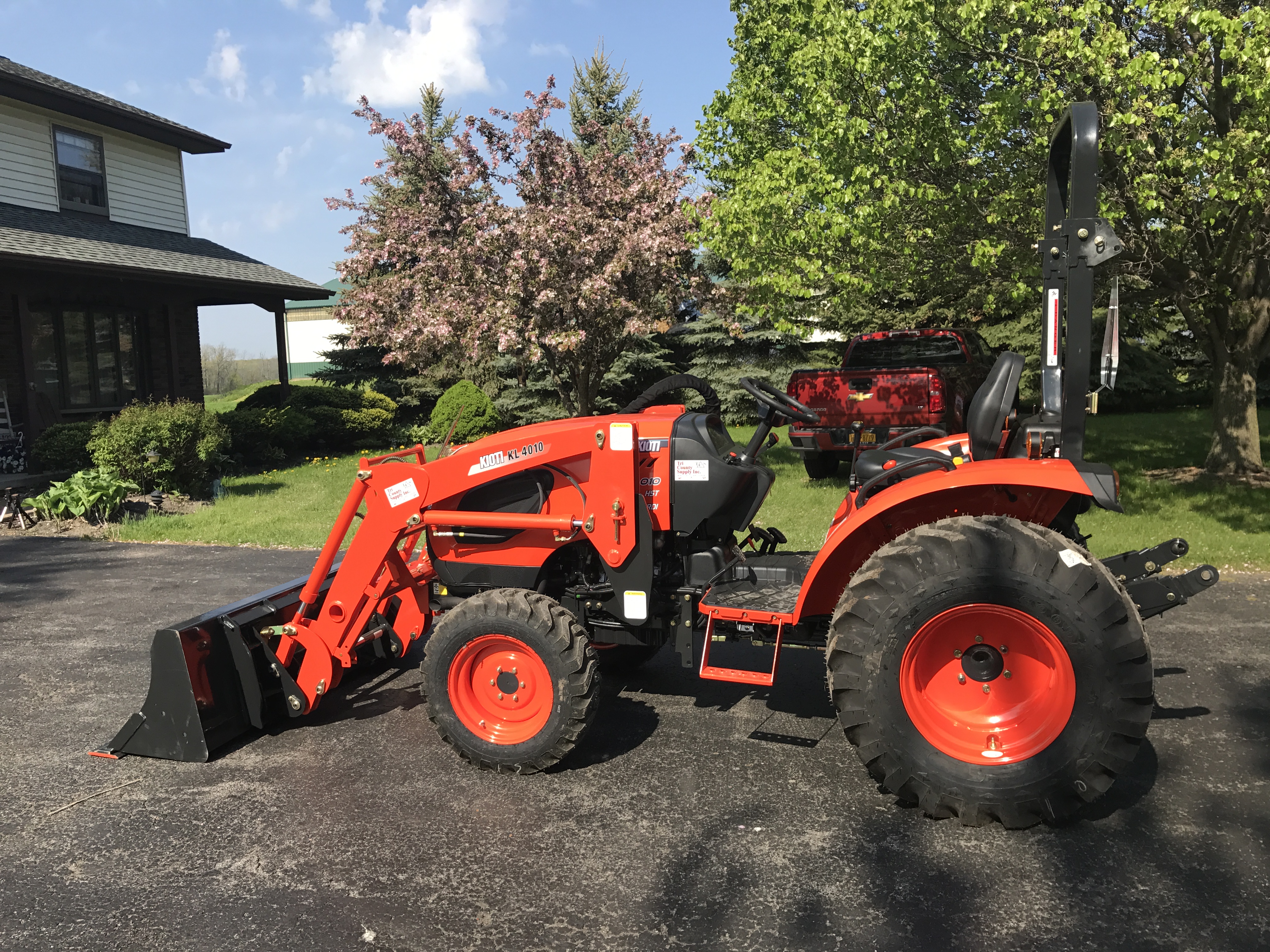

Thanks for all the input.
I covered all my bases today and got the CK4010 40 HP with Hydro, gives me 3 more PTO HP than the 35 with gear. The safety features of the hydro for my family ( foot off pedal, tractor stops), the ease of of use, and that I won't be skidding logs all day or plowing large pastures, gave me peace of mind with the hydro.
Got telescopic links, FEL, dual rear remotes, Industrial tread, fuel heater, bucket blade, Mat, RimGuard, Service and Parts manuals and all the filters for 50 hr service. Dealer spent 4 hours with me answering all my questions and going over each detail of the unit.. So begins a new learning curve, and the pain of letting go of my NAA Jubilee.....

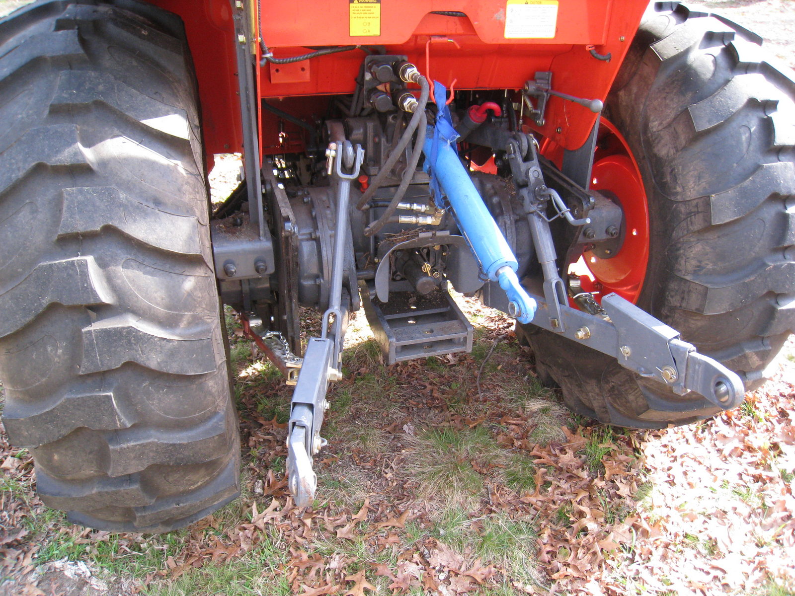

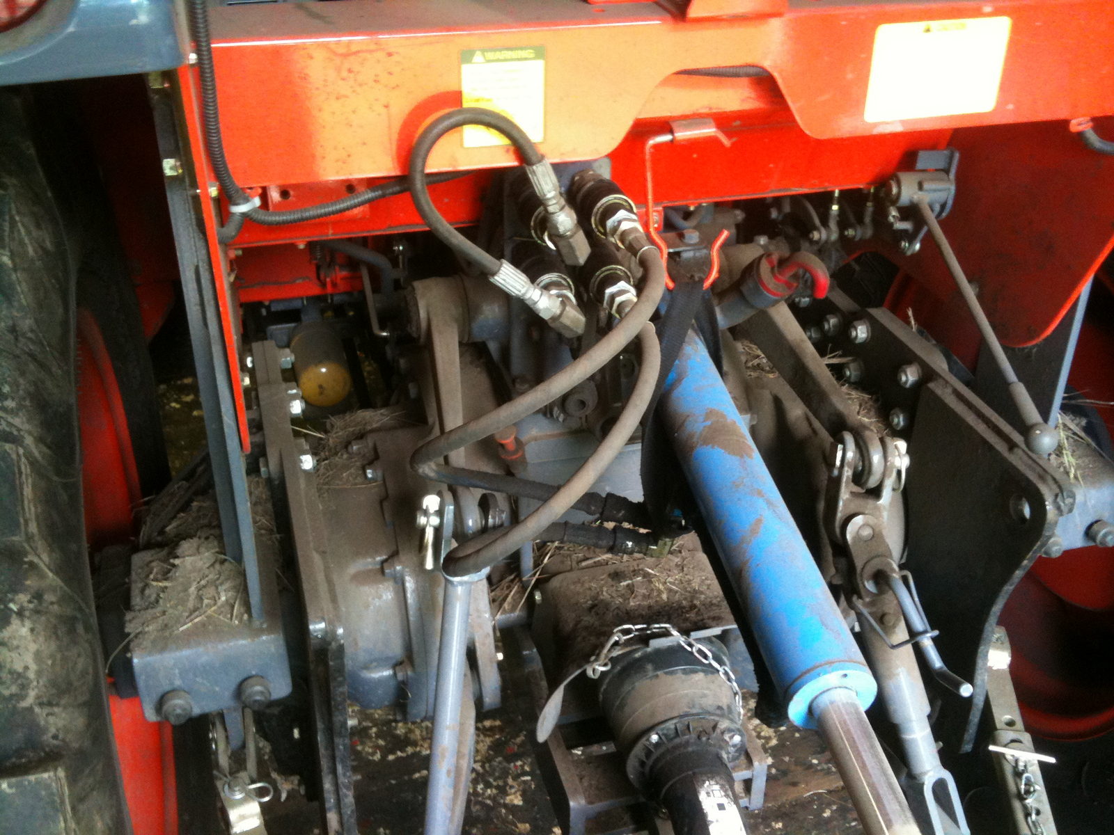

Nice tractor. Now before your wife sees how much you have spent, get yourself a hydraulic topping lift and either hydraulic sidelink or get a 12" piece of 3/8 hydraulic line with 1/2" male connectors on both sides to keep in the unused rear remote set to make sure you don't accidentally deadhead the system. Easy to do (both deadheading and the preventive fix).
Thanks for the tip, I hadnt considered deadheading, should I do the same with the loader ports when I drop the loader?
   / Kioti CK3510 CK4010 difference in HP - why? #27
I don't know of anyone who does it for the loader ports. Most of us use the loader full time rather than taking it off for mowing so it is rarely an issue. It is however pretty easy to either forget to put the rear remote lever in "neutral" after using it or to accidentally hit it with your foot (assuming the lever is near the floor of the operator station. In any case, it is a cheap effective fix that also keeps the ports clean without rubber caps.
