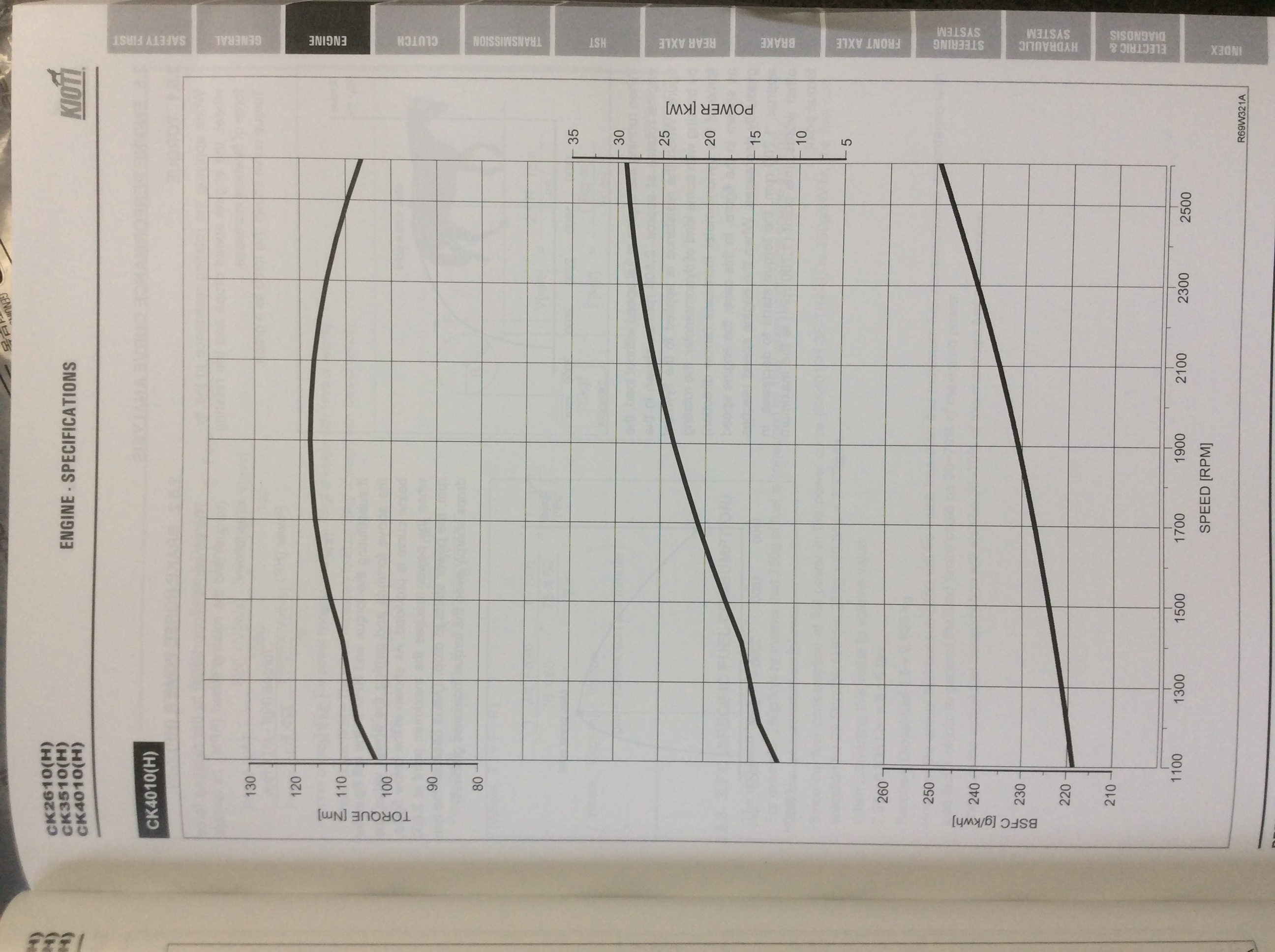

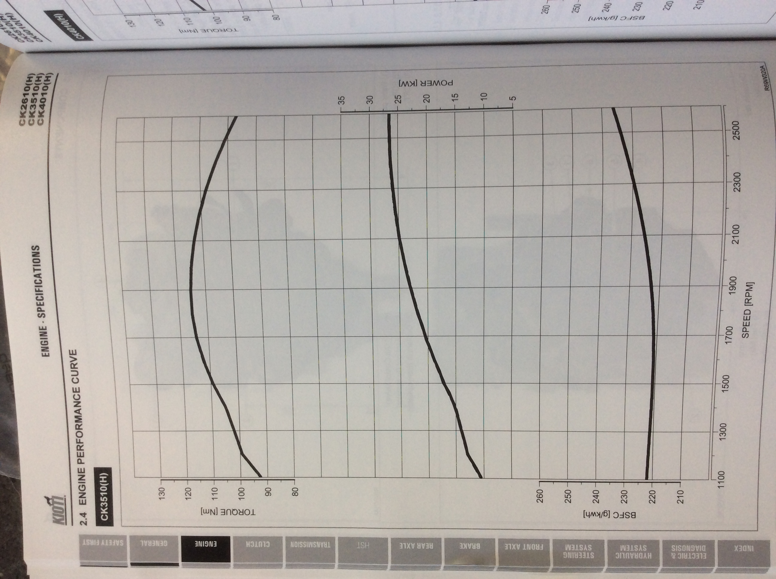

Whoa, thanks for sharing! The 35 HP calibration is much more fuel efficient. I'm pining for a 3510H but it will probably take a couple more years before I can swing it. This post helped solidify my decision for not spending extra cash on the 4010, thats for sure! Sorry, not trying to be a jerk after you bought the 40.
Honestly I'm quite suprised the BSFC curves are that different. Would have thought the only significant variation would come on the top end (peak power) where the power clearly differs more.

The HP difference in a CRDI system has nothing to do with the pump or injector size. The pump only pressurizes the fuel in the rail. The injectors are electronically​ pulsed by the ECM. The software in the ECM will determine how much fuel to deliver. More fuel, more power.
It is more cost effective to make all the parts the same and control the output with software.
Look at all the power up devices that are made for diesel trucks. The turbo boost and fuel are all controlled by electronics.
Unless you are talking to an industry trained service technician, the person that you talked to at the dealership doesn't know. They might be thinking old school.
Makes sense, it's probably easier to have a single assembly line/parts/etc.
Similar thing over the in CPU space. Different speed chips within the same family are identical. They're all made on a single large wafer and then cut up. They divide the wafer into 'bins' and then test them all as they come off the line. Generally bins closer to the center have better tolerances so those turn into the high performance chips.
I wonder if they do any similar QA process for engines or if it's all in software.
