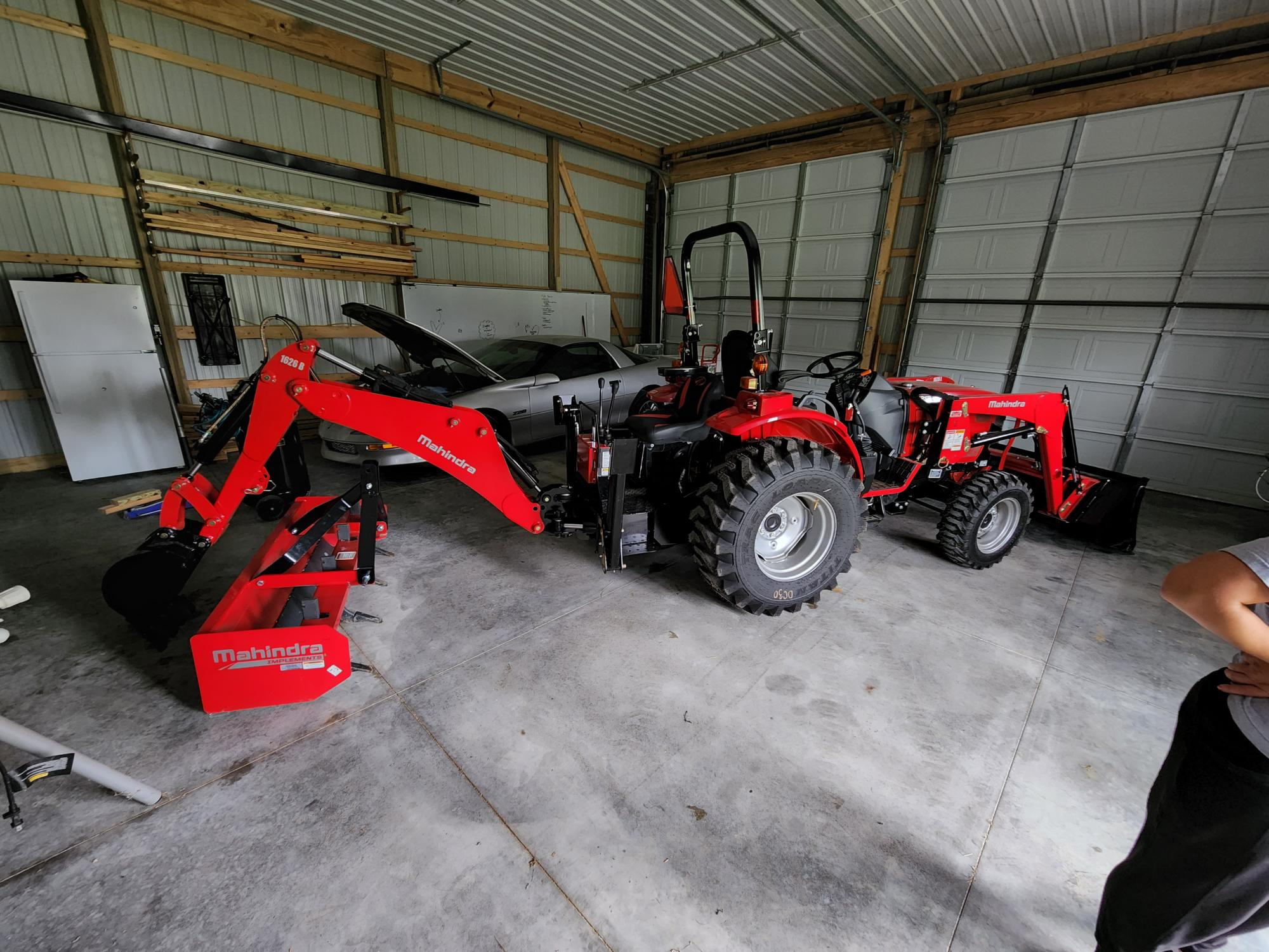

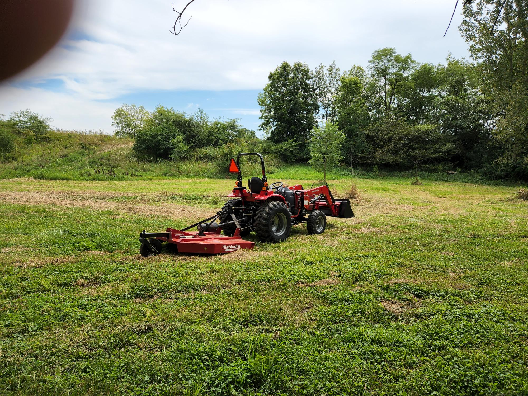

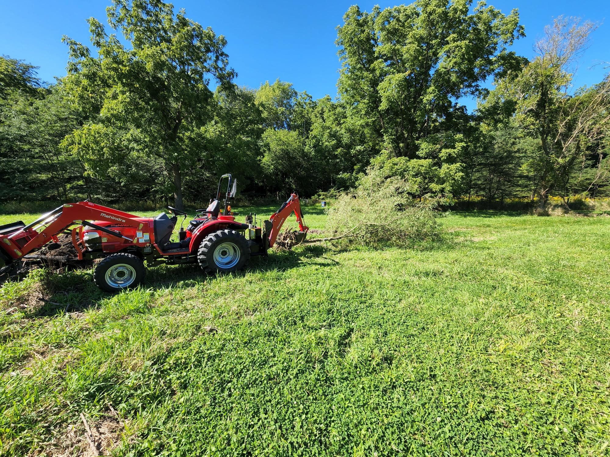

The tractor was delivered a few weeks ago, I've been busy with work, but have managed to fit in a couple small projects since I received it. Overall, very happy, my only complaint is that the front end loader hydraulics seem to leak down more quickly than I expected, but not a huge problem.
