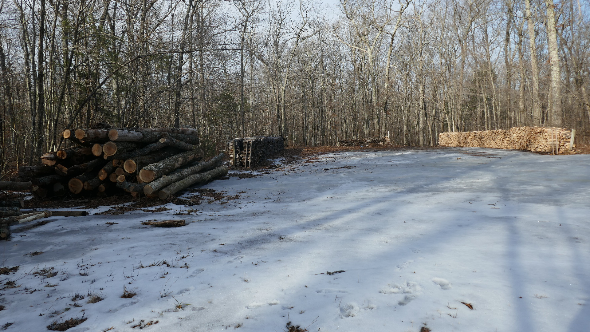

I work at a place that sells the 1626 Mahindra. I own the predecessor number 3016. I feel the geared tractor is stronger in all regard between the hydro 1626 and the geared. I feel the Mahindra is rather crude in its shift operation but is still capable. I also do not like the back and forth peddle actuator for the 1626 much preferring the side to side pedals.
My tractor (3016) is rated for 1650 lift for the fel at full height. I am telling you right now that I would never in a million years lift that weight at full height with this tractor.
What has not been talked about is stability when traveling at the rated weight premise and all of the tractors you mention are too small to move this type of weight for any appreciable distance safely at the rated height.
You would need the next frame or two size larger.
LD 1 is correct. All of these tractors will lift a 1400 # log to waist height. I would not consider moving this type of weight at shoulder height for any of this trio.
All of these tractors will do what is pictured lift wise.
For lifting pallets of stone or heavy feed bags, you would be much happier with the Mahindra 2660. That is a more than capable tractor with little doubt as to its ability.

It will be general property maintenance, and down the road used to help establish a new homestead. Moving logs, dirt and gravel work, pallets of stones, brush hogging, digging water/sewer/electrical trenches. Moving animal feed/hay.
