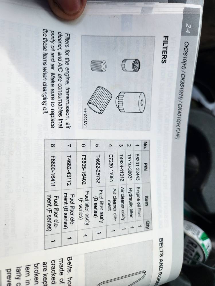

According to the parts lookup on Michigan Iron’s website, the filter part number is T4682-43172 for the CK2610H.
That's what I found as well; but the manual lists two. Was wondering what the heck the manual meant by "B" vs "F"
/ KIOTI CK2610 fluid advice #86
F6800-16411 Is the one for the 4010H so I suspect it is an engine code but don’t know for sure.

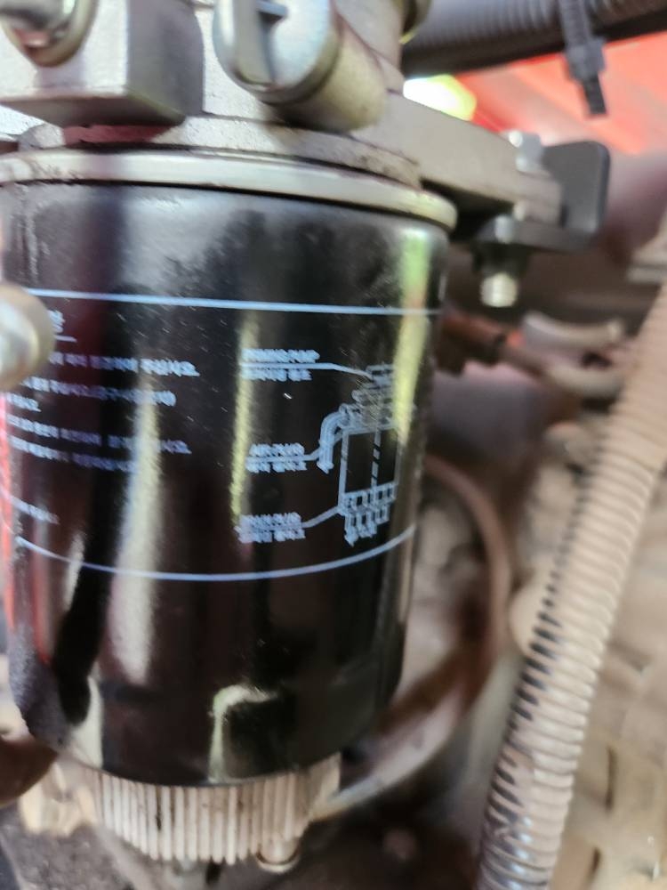

I just installed this one last night, and fit was fine.
Check this out at Amazon.com
LSSOCH Fuel Filter T4682-43172... Amazon.com
Only issue was getting that plastic bottom cap/drain fitting to thread in right. The threads are correct, but between a plastic male, and sheet metal stamped female, it tried to cross thread like 9 times before I got it to go.
I did not check what hours you are supposed to change the fuel filter at, but mine has had a drop in power recently, at only 70ish hours. I've been working in extreme dust, and cleaned the air filter ever about 4 hours, and that didn't change much. It felt/sounded like fuel; basically on a slope and with a load that used to be fine, now it would bog down in medium range. Fuel filter appeared to take care if it, but only had the chance to run one load before I had to fix dinner.
