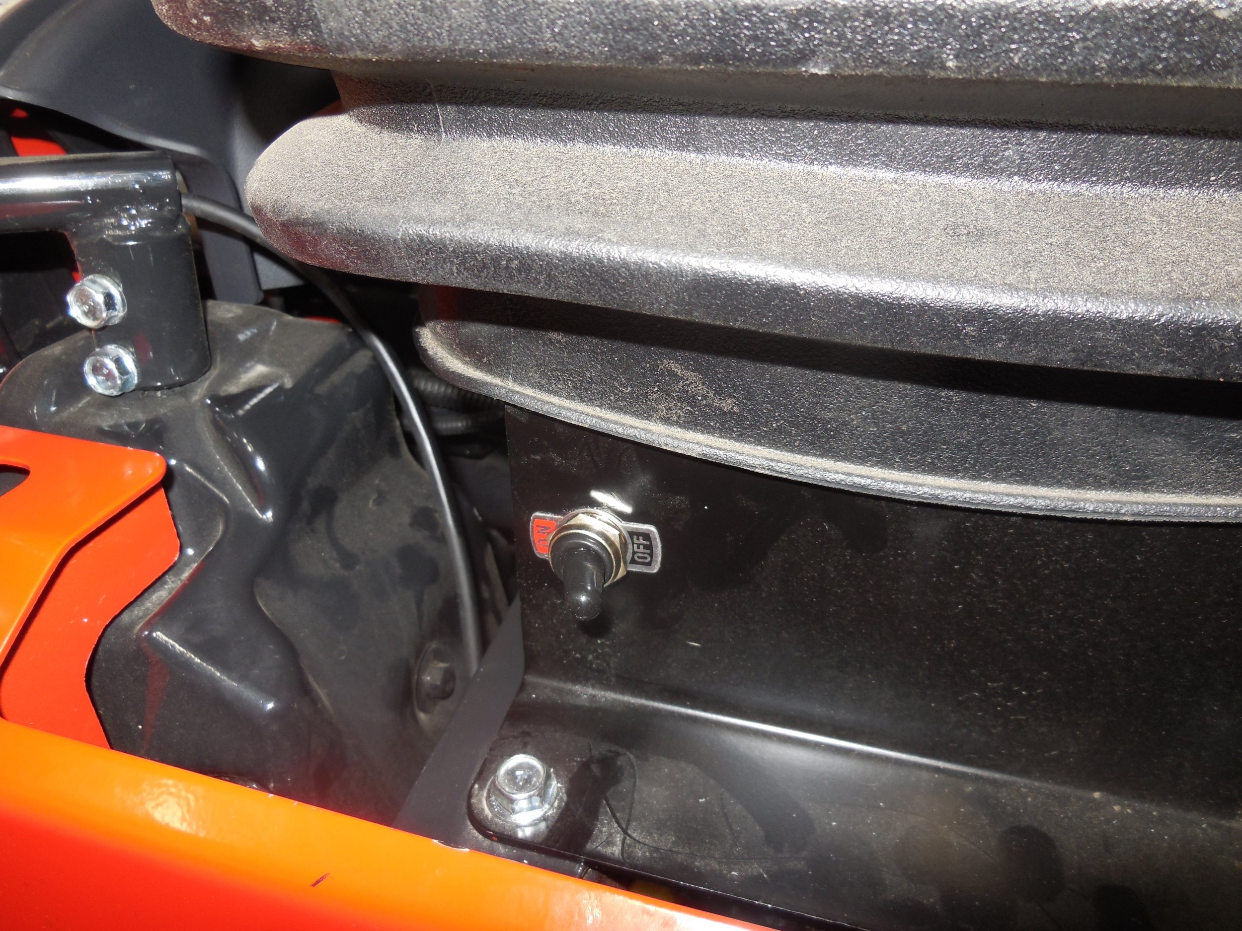

In case anybody decides to install remotes (CKA111) on a Kioti, this one photo might be more helpful than the absolutely miserable instructions.
Okay, easy for me to say, perhaps, since I just finished the task.
   / KIOTI CK2610 fluid advice #78
While messing with this Kioti I also installed a switch on the base of the seat to avoid having the engine stop whenever I get off the seat.
In Off position the seat nanny works as intended, but when turned to On I can lock in the Quick Tach levers and do other things without going through the whole Neutral, parking brake on, routine.
   / KIOTI CK2610 fluid advice #79
My dealer gave me a little plug to defeat that stuff, but that's a nice clean install right there. Also safer if it were to roll and you get tossed from the seat.

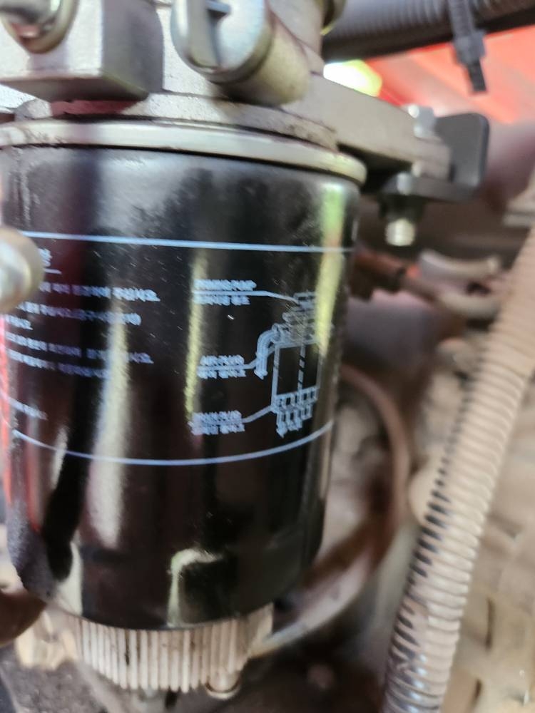

@ODZD did you do fuel filter? It seems stupid, but when I check manual, there are distinctly two different models, depending on if a "B" or "F" model? I have a CK2610H. Is that a "B" or an "F"
