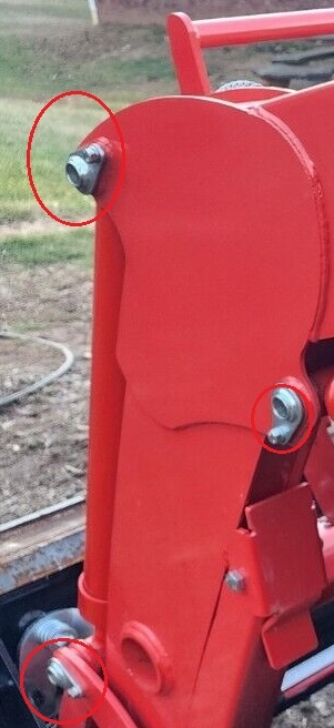

All,
The bolts shown in the attached picture (not sure what there called) continuously loosen up on our 2610 despite torquing them properly and using Loctite. Any suggestions on how to keep these from backing out? I don't see a way to safety wire them...btw this isn't a 2610 loader arm, but the setup is similar.
Thanks,
Lou

Which loader do you have? KL4030 or KL4030C. It may make a difference as the 'C' was manufactured by a sub contracted company and there were some issues.
My KL4030 has been flawless with a lot of grapple log handling and dirt work.
Patrick
   / Kioti 2610 Loader Arm Grease Fitting Bolts always loosening up #3
A couple of mine did this as well, to the point I lost one, but retorqing fixed the problem so far.
I suggest your try to get replacements for the ones that keep backing out. Could be that they were over-tightened and are now stretched..?
Dealer gave me a couple spares for free.
   / Kioti 2610 Loader Arm Grease Fitting Bolts always loosening up #4
Mine always loosen up. Good thing is though, if they fall out, nothing happens. Just keep spares around.
   / Kioti 2610 Loader Arm Grease Fitting Bolts always loosening up #5
Use LocTite red, LocTite blue is for applications you need to remove easily. Red only comes loose when heated to 500°.
If those are moving joints, a shoulder bolt works best, but finding the correct fit might be difficult.

Thanks for the replies. I'll try some red LocTite or see if I can safety wire them somehow.

I'm guessing that's a KL4030? The KL4030C has a whole different setup for grease fittings.

If using loctite the threads must be free of any oil or grease. If oil on threads the loctite typically will not setup and harden properly.

Yep, grease them “more often” so that you catch them before they pop off. Tighten them up as necessary and if they go missing replace with your spares…😉
