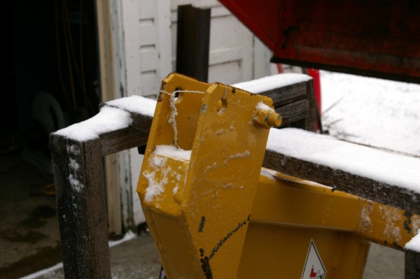

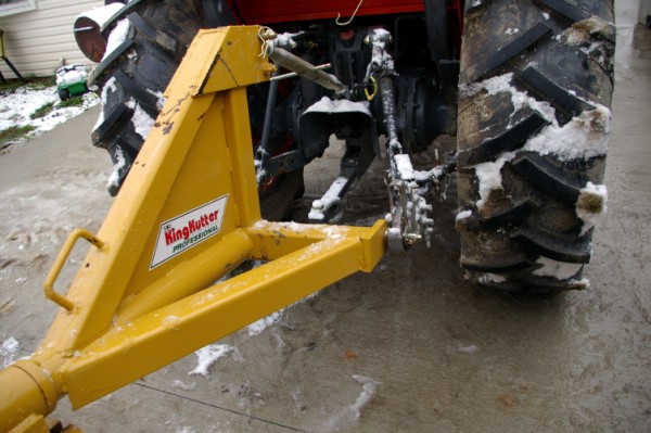

The difference I have seen in the Professional models is a heavier gauge steel with more reinforcements. I recently bought a 7 ft blade that was a professional model. Pretty HD compared to the standard...
