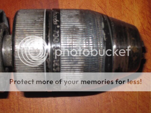

Here you go. It didn't work very well right from the get-go.
No offense, but thats not a good chuck. You cant write off keyless chucks because of that particular low end model.
I got the same one on a Makita. Its garbage. About the only bits that it will work with are hex or tri sided ones, and even then its iffy. Its a Jacobs 510.
Look at the ratcheting chucks like the 700 series from Jacobs, its a 1/2" capacity chuck. once they are snug, there is a ratcheting mechanism that makes them EXTRA tight. And carbide jaws ensure a good bite.
Your drill being 3/8 might be difficult to get a high quality keyless for it. I dont know if they make a 700 series that will mount to a 3/8.
EDIT: If you cant find a Jacobs in 3/8, have a look at Rohm chucks like the Supra 871044 or the Extra RV's

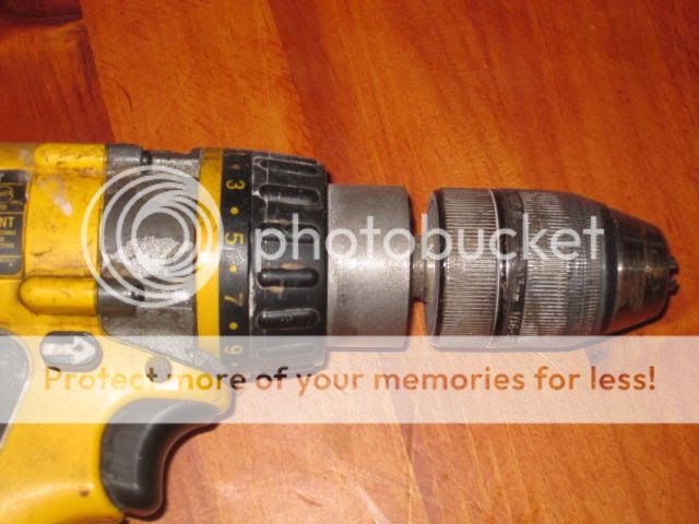

Heres my Dewalt with a 700 chuck.
