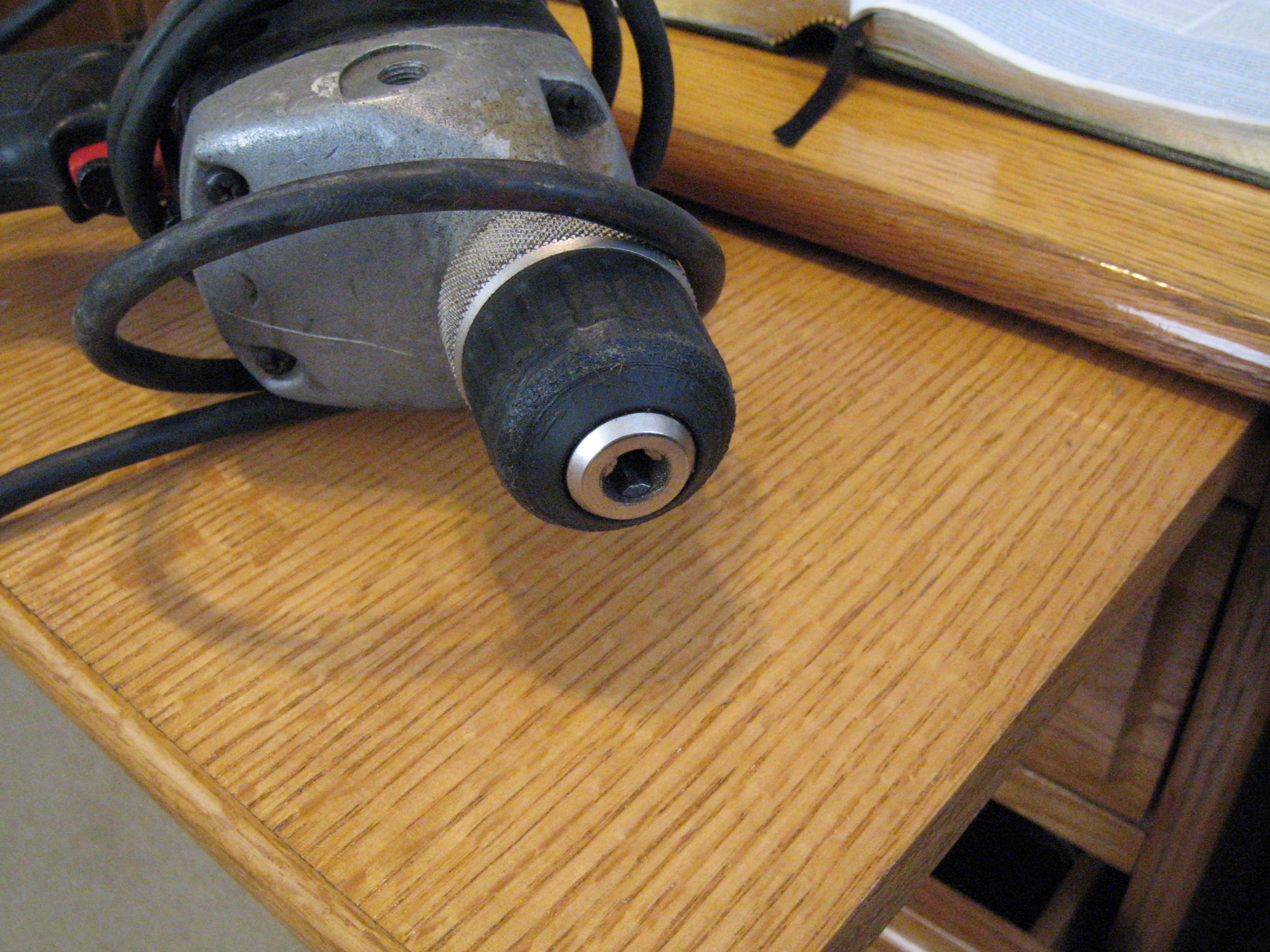

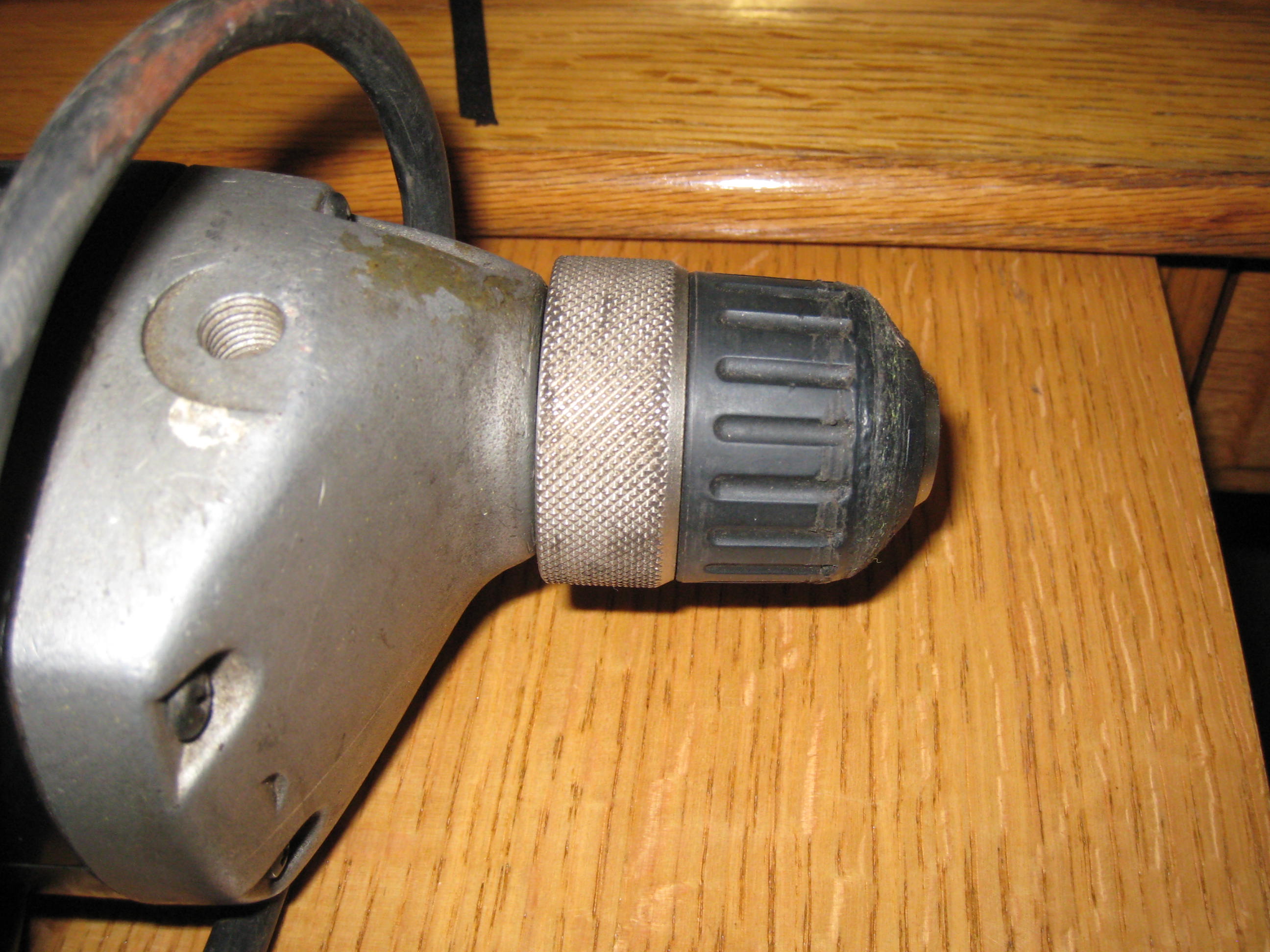

After much bragging about keyless chucks by my friends I finally went down and bought a 3/8" church for and old drill I had laying around. I would never buy another one unless somebody shower me theirs and demonstrated how great it is. It is always slipping after I start drilling hard. And I do tighten the chuck as hard as I can, and I'm a big guy. At least with a keyed chuck you can turn it tight as you can.

I can't read on the chuck what kind it is, but it seems like it is a Jacobs 3/8" chuck. I can read a little on the plastic part but not enough to get precise info. The next time I'm in the store I'll check it out.
or even a picture would narrow it down.

Here you go. It didn't work very well right from the get-go.
I'm pretty sure that's the old style that just worked ok. the new style ratchets down on the bit, you can hear it click tighter as you put more force into it. My Milwaukee will crank down tight enough on my worst slipping bit that it will wrench out of your hand when getting stuck while drilling. It also helps that my drill locks the motor when twisting the chuck. I bet the drill setup you have means you need to put a hand on the plastic piece and the other hand on the small knurled metal piece to tighten it to the max.

No offense, but thats not a good chuck. You cant write off keyless chucks because of that particular low end model.
I got the same one on a Makita. Its garbage. About the only bits that it will work with are hex or tri sided ones, and even then its iffy. Its a Jacobs 510.
Look at the ratcheting chucks like the 700 series from Jacobs, its a 1/2" capacity chuck. once they are snug, there is a ratcheting mechanism that makes them EXTRA tight. And carbide jaws ensure a good bite.
Your drill being 3/8 might be difficult to get a high quality keyless for it. I dont know if they make a 700 series that will mount to a 3/8.
EDIT: If you cant find a Jacobs in 3/8, have a look at Rohm chucks like the Supra 871044 or the Extra RV's
