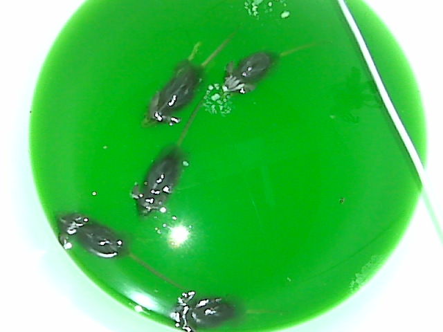

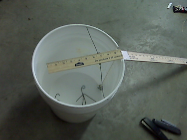

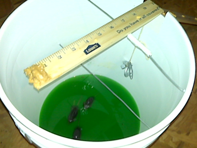

I don't have the problem with mice in my shop. But the house is another story. I one I built,also uses the bucket method. But, I use a ruler and counter weight. They get to the end were the peanut butter is and there weight is too much for the counter weight. The ruler fall's down and they land in the anti-freeze. Once they fall off of the ruler, the counter weight pull's the ruler back up and it's reset for the next one that thinks he's getting a free meal. I stopped counting after I caught 17 of them.

That's neat -the bucket trap.
