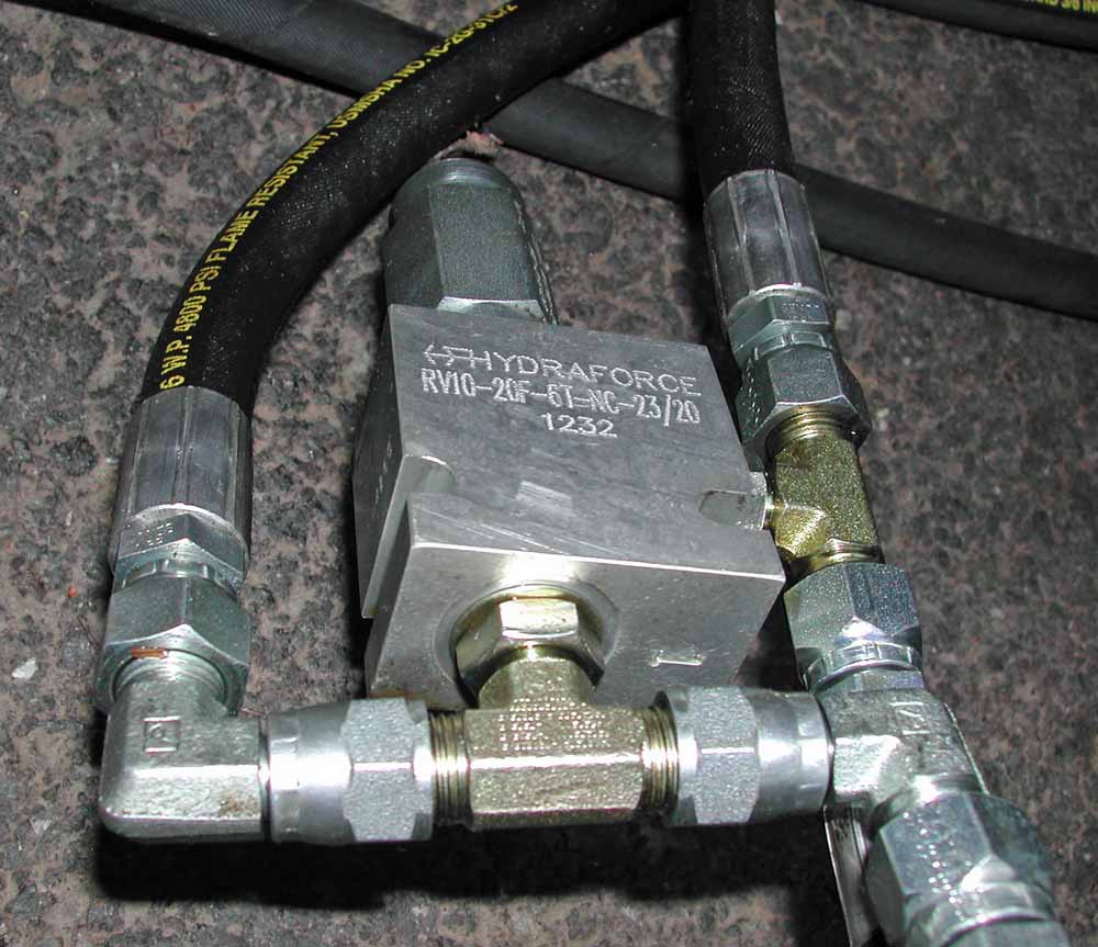

A simple work port cross-over relief like this (photo) is the next easiest approach, if the OP does not
want to open the cyl. You can order these pre-set to any pressure and the plumbing is simple, with
no drain ports. This application does not seem to require much pressure.

Sounds like you need a pressure relief valve such as those found at: Surplus Center installed on just on that cylinder
Aaron Z
http://www.surpluscenter.com/Hydrau...00-1500-PSI-HYD-CUSHION-VALVE-9-4019-50-L.axd
the HYD CUSHION VALVE will do what you want , it is two relief valves, hooked together and will dump oil from one hose to the other, if over pressured, so even if the vale is in neutral or locked the cylinder is still protected From over load, or if the tractor is has more psi than the cylinder can deal with it will work.
I had a situation where if the load go to great it would bend the cylinder, and the valve solved the problem. and each side can be adjusted independently if needed.
   / Keeping a cylinder from bending #25
1/2 NPT 30 GPM 500-1500 PSI HYD CUSHION VALVE
That Prince valve is a workport crossover relief valve with dual adjustable RVs. Unless there was a dump
to the tank, it will not protect the cylinder when the control valve is in neutral. If the workport was
connected to a hydraulic rotary motor, then it may work in such a situation since the in and out volumes
would be the same.
would be the same.
It does not need a return to the tank,
as the cylinder can at a given pressure by pass to the opposite hose, thus if the cylinder is compressed/extended to over design load it moves as the oil is passed from one side to the other via the cushion valve, (just as if one hooked a hose from one end of the cylinder to the other, (but with resistance that is set by the user via the valve),
and if it over pressured by the system, it goes through the cushion valve and back the other line to the tank
All I know is it woks on my two cylinders on my back hoe, as there are situations that if I curl the bucket it can over load the one cylinder and my current design I can not with out rebuilding parts, so I added two of this type of cushion valve and it has worked for a number of years, now and no more bent cylinders, if you do not want to believe my experience then don't.
