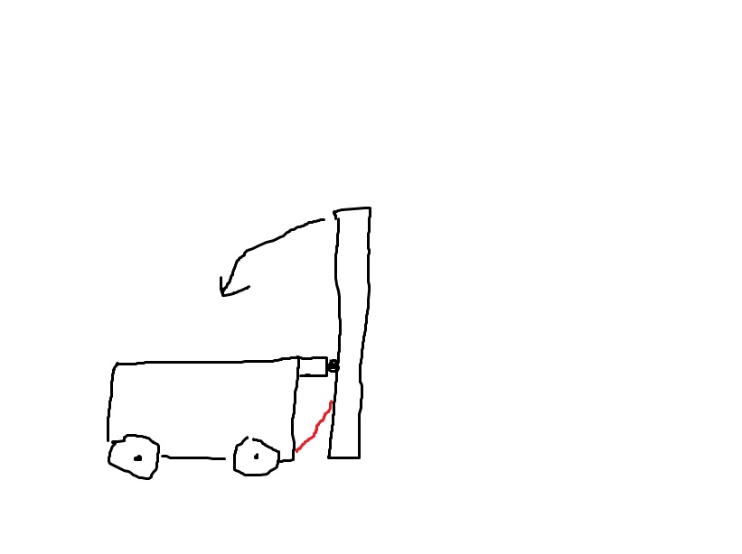

I have a machine with a mast that uses a hydraulic cylinder to rotate the mast 90 degrees - vertical for in use and horizontal for travel. There is never any kind of load on the mast except for the mast itself. The mast weighs about 1000lbs but is well balanced and pivots freely. Two people can pivot it by hand. The mast has stops at both the horizontal and vertical positions to keep it from over rotating.
What happened is when rotating it to the horizontal I very briefly held the control lever after the mast hit the stop and it bent the rod in the cylinder. It was not an extreme or careless thing I could see it easily happening again. Current cylinder is 2.5" bore with 1.25" rod. I see bigger cylinders with 4" bore and 2" rod - would this help or would there just be more force to bend the larger rod?

/ Keeping a cylinder from bending
#12
Here is a rough sketch of the design.

/ Keeping a cylinder from bending #13
The cylinder did not contact anything. I am interested in regulating the pressure to this cylinder only, but not the main relief as I have other cylinders and motors that need full pressure.
Sounds like you need a pressure relief valve such as those found at: Surplus Center installed on just on that cylinder
