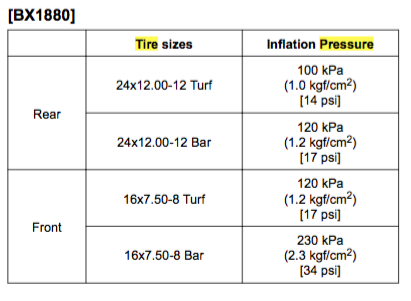

So theres more to it than just matching these numbers?
Rear: 24x12.00-12
Front: 16x7.50-8

The IDEAL situation - your owners manual tells you the tire size for R-1, R-3 & R-4. However - I'm willing to bet that will not be the case. Me - I would go to a tire store that - 1) you know you can trust 2) sells and deals, specifically, with tractor tires 3) willingly acknowledges your wishes and takes the job on professionally.
Quite honestly - you DO NOT need R-4's that exactly match the sizes you have listed - those are your terf tire sizes - right? Of course, you shouldn't go to a tire that's 36" high. What you need is a bit difficult to describe -
You need tires that have the same ratio of size - front to rear - that those turf tires have. So if the front tire has a rolling diameter of 20" and the rear rolling diameter of 40" - you need to keep the same ratio on new tires. ( Front - 15" rear - 30" ) ( Front - 24" rear - 48" )
Common sense will dictate that overall you will want the new tires to be close to the same size as the turfs.

Hoping to just do it myself.
Manual says same size for turf and bar....assuming "bar" mean anything other than turf

I’m reasonably certain that R3 and R4 Tire’s for a BX are the same relative sizes, but the Op manual will confirm or refute that. There is not an R1 option and finding suitable R1 sizes will be problematic and perform unsatisfactorily in many situations a BX is typically used.
/ Keep getting flat tires #15
Thank you, sufficient even if I do not replace the rims?
IF you can find tires of the same size (diameter and width) then the same size wheel should be fine. I do think on the subcompacts all three major tire types (R1, R3 & R4) are all the same size. Compact and larger tractors often have different tire sizes between types, most notably between R1 and R3/R4. R1s tend to be taller and narrower, dictating a narrower and larger diameter wheel.
"Bar" is the R1/Ag equivalent on subcompacts, but different than R4/Industrial. You want R4s for your application.
Tractor data implies that for the BX2660 I looked at, all three types are available in the same size.

From what I can tell, the BX1880 does not offer R4 tires as an option, I believe because R4s are not made in that smaller size.
You MAY be able to go up one size.
The BX2660 I mentioned above takes these sizes:
Front: 18x8.5-10
Rear: 26x12-12
They might fit on the same rim size - not sure.
Note that you will be losing some effective power pushing/pulling power by virtue of the larger diameter of the tire. AND you probably will void the factory warranty if you do so.
Bar tires may be ruggeder, not sure. If so I would say that is your best option unless you can find some more heavy duty Turfs.
