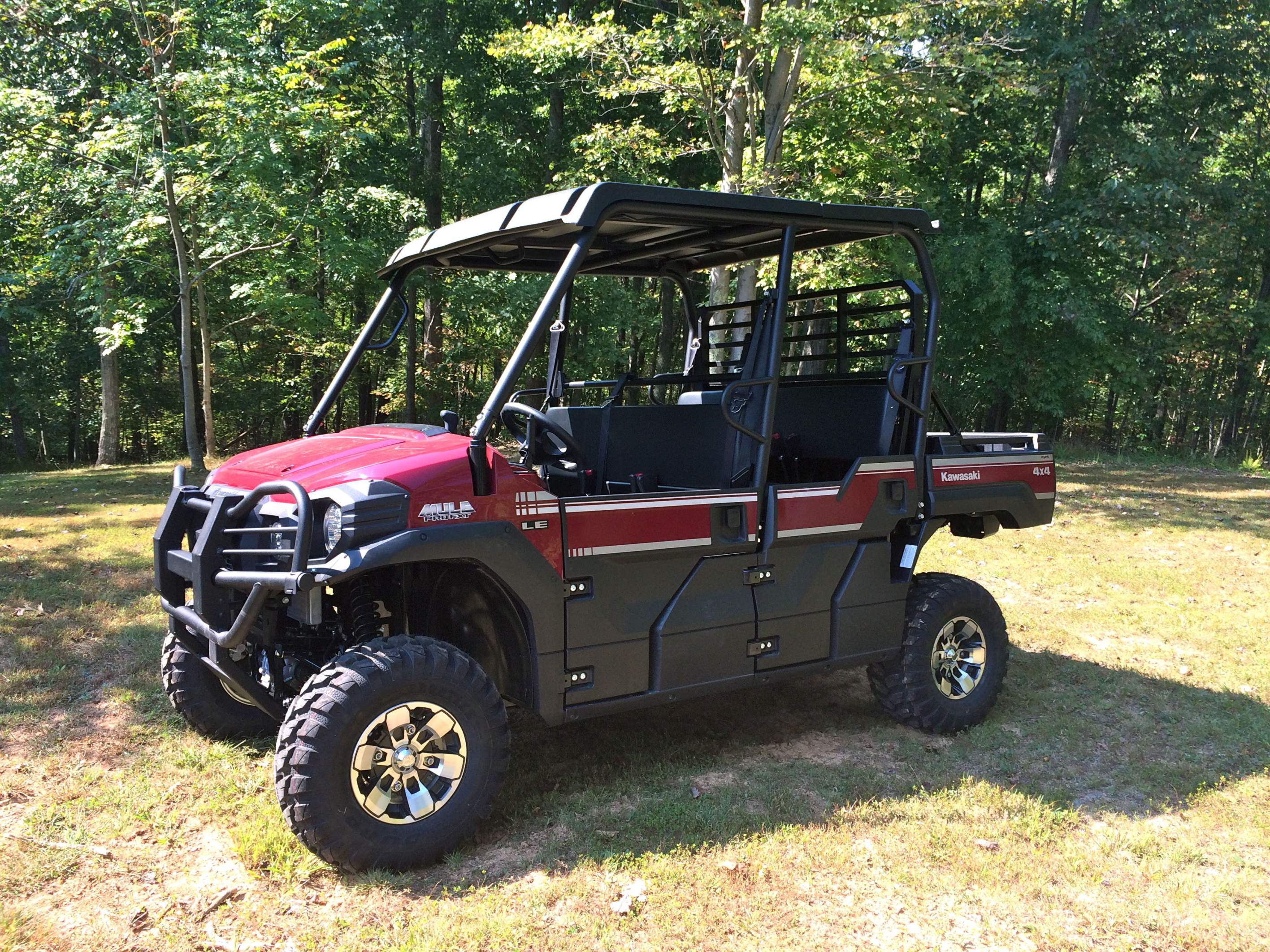

Any pics of your new mule Code?
/ Kawasaki mule pro 2015
#19
Here is one for you. Sorry I don't have an updated photo with the winch on yet as I have it apart in my shop right now doing some aux wiring. Adding the rear lights, horn and maybe a light bar. Ill try and get some updated ones later this weekend
