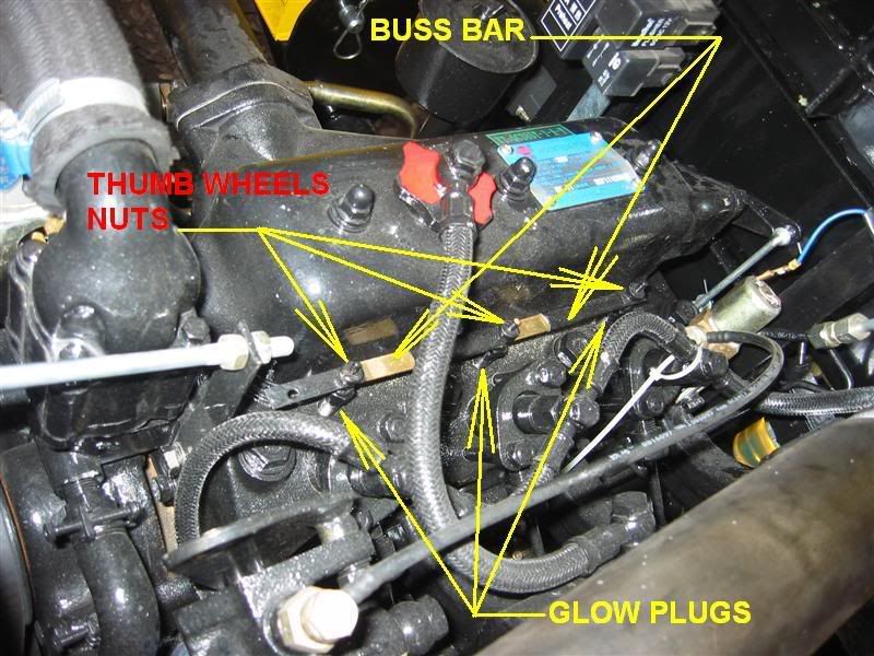

I have checked all connections I can get my hands on. Cleaned, re-torqued, etc.
With my truck running at high RPM, I was getting anywhere from 13.68 to 14.12v at the starter, and on the battery. I was able to get the starter to turn over several times, but it still won't start.
I am not blowing fuses even when I turn on the glow plugs. I tried getting amp readings on the glow plugs, but I wasn't able to keep a steady reading. I removed them and cleaned them, but to no avail. One of the plugs was round on the inside tip while the other two were sort of flat with a slight crevice going across the tip.
As of now, I am back to clicking at the starter when jumping them with a screwdriver, or at the ignition switch.
What am I missing???

Well - if you're jumping the tractor battery with the truck - you've defeated the purpose of the intended voltage checks. They were intended to a) determine if your tractor battery had a sufficient charge, and b) how much of that charge was making it to the starter solenoid.
1. what's the tractor battery voltage?
2. what's the tractor battery specific gravity?
3. what's the voltage between the keyswitch and the solenoid while the starter's cranking?
4. please clarify whether it's the starter or the solenoid that doing this "clicking"
5. did this clicking persist when you tried jumpstarting with the truck too?
And since you have an ammeter on the dash, checking for amps at the glow plugs is redundant. The procedure I described to you was for checking resistance. The multimeter must be set to one of the OHM scales.

Fuses blow because of an electrical short. But if your replacement fuse didn't blow, the condition was apparently temporary. That can happen when the 12v leads to the starter and/or solenoid are loose. You can get a spark gap that jumps to ground.
Verifying battery ground is important to the entire electrical system. But specific to the starter circuit, tighten the three 12v connections at the starter and solenoid;
-battery to starter
-keyswitch to solenoid
-solenoid to fuse box.
Also inspect the insulation on all three. If it's worn/burned through, one could be periodically shorting out against some metal.
//greg//
Fuses will definitely blow when there is a short to ground but they will also blow when the current draw across the fuse exceeds the fuse's rating. Since the starter uses a solenoid to make contact across the lead from the battery to the starter he should check for a bad solenoid or starter along with cleaning all battery cable connections.

Dave is correct that pulling too much amperage also blows fuses. I left that unstated, as I gave you credit for already knowing that.
But don't arbitrarily rush out to buy a bag full of possibly unneeded new parts. The steps I advised are intended to troubleshoot to the point where you can arrive at an informed decision. I strongly recommend the suggested tests to narrow the scope of this issue. So far, it's just a generic starting problem. These checks are intended to take it down to component level: battery - wiring - solenoid - starter - keyswitch - et cetera.
