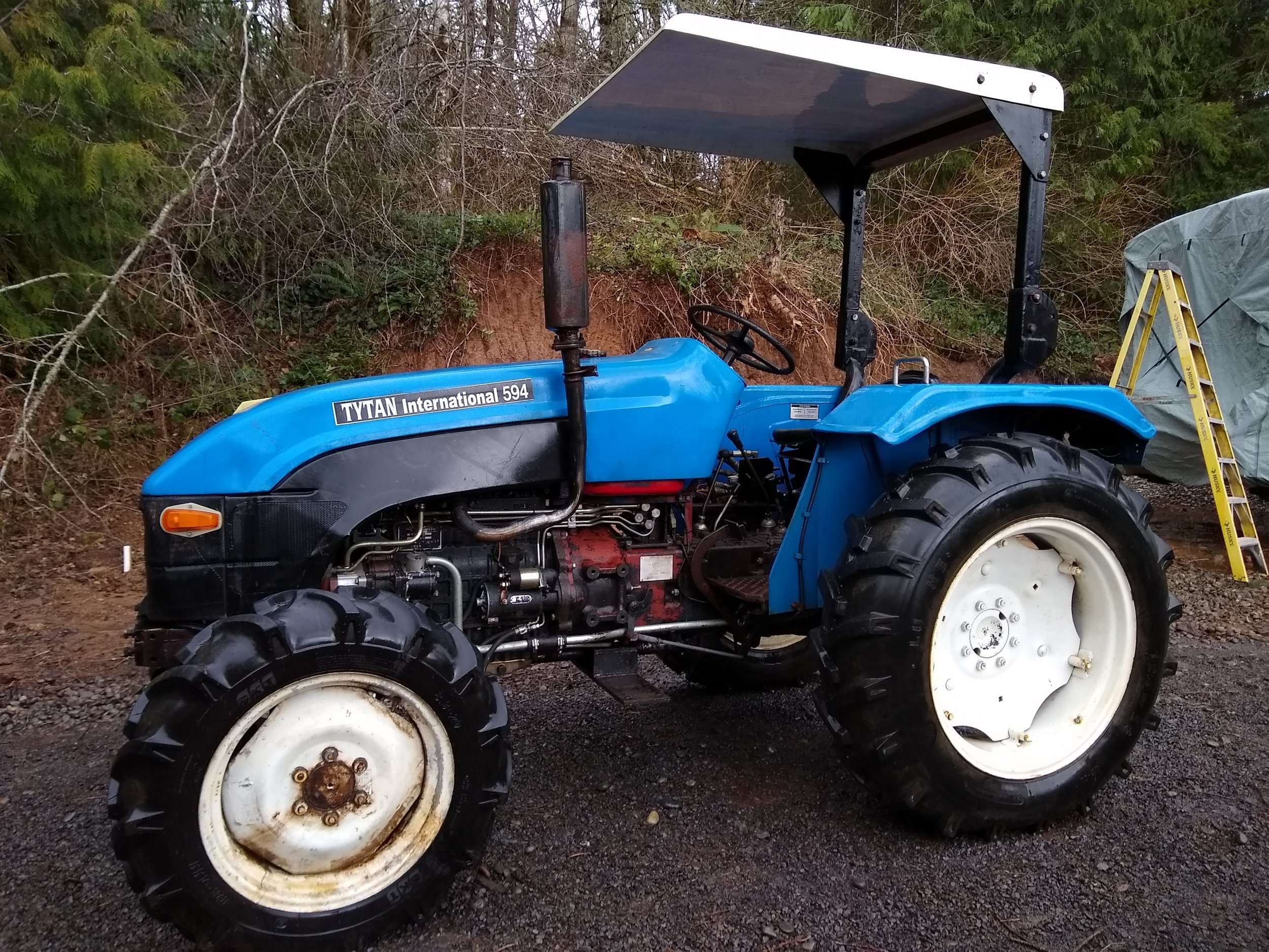

The ol' girl is getting a little tired. Starting a light restoration to fix some issues and spruce up. Also improve stability on hill and hopefully do some improvements.
This is a KM554 rebadged as Tytan 594
This is what she looks like now. Heavy built and tough.
Removed FEL and frame.
Items to fix:
Leak from top of power steering resevoir
Leak at power steering cylinder banjo fitting
Leaky front axle
Starter doesn't always work
Need new seat
New brakes
Adjust clutch
Clean and repaint
Paint FEL to match
Replace wheels and tires with wider R-1W tires

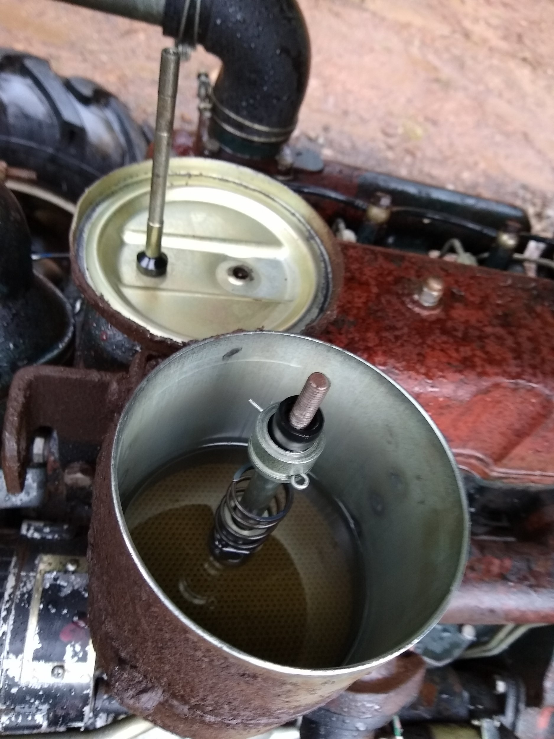

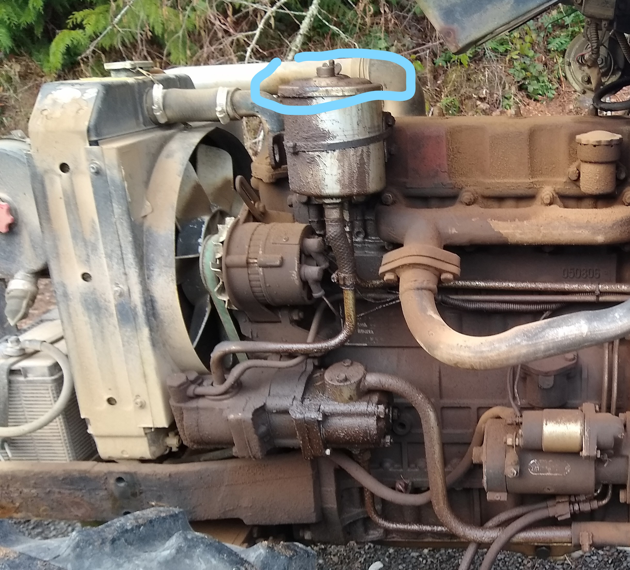

I have a major leak from top of power steering reservoir. The cover is just metal on metal. Seems like there should be a seal around the top. Does anyone know what is supposed to be there to seal?

Quite possibly an O-ring, or just a flat neoprene gasket.

This is what it looks like. No place for an o-ring. Yes, maybe a large flat ring shaped gasket. Guess I would have to make it

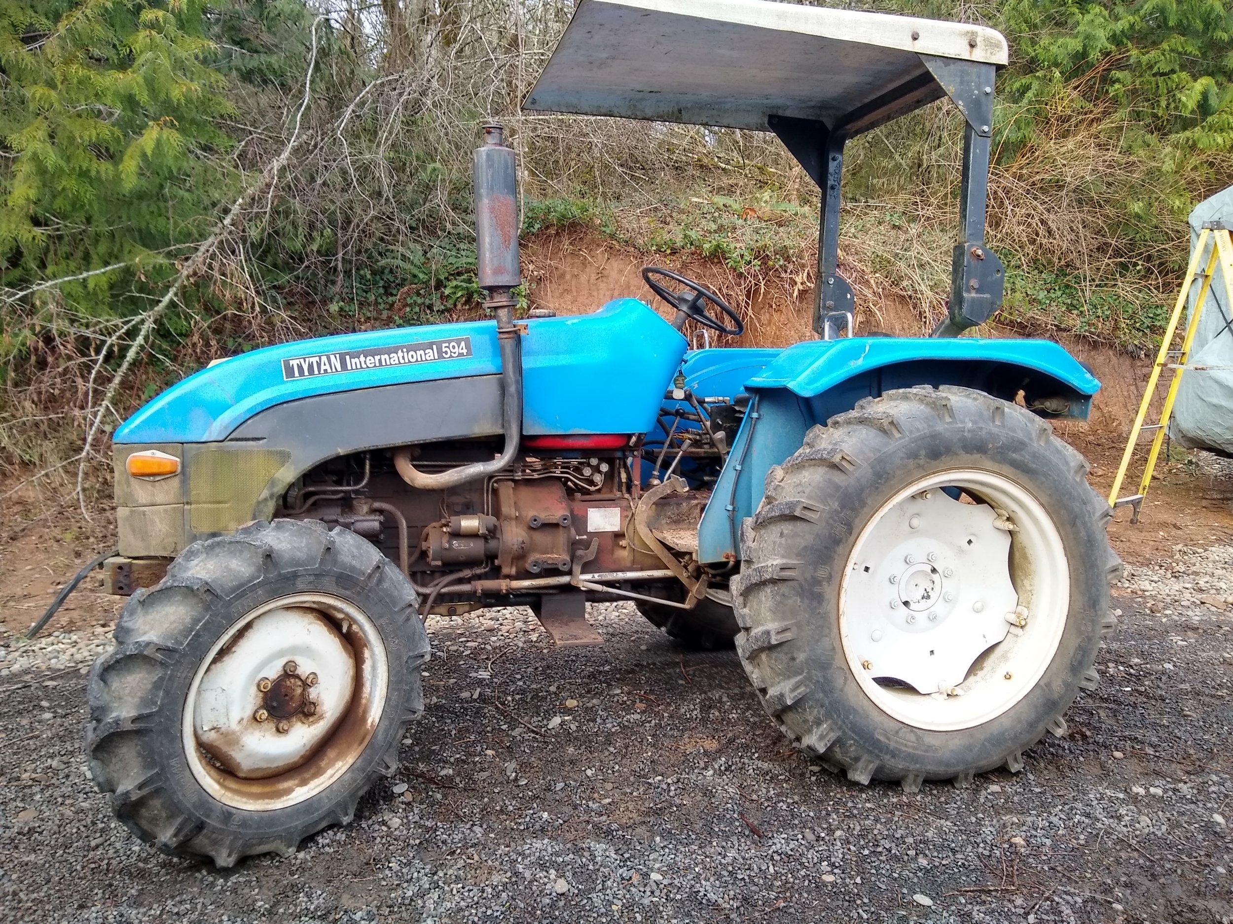

   / Kama KM554 rebuild and upgrades
She look better after a bath. I think she wants to be red again.

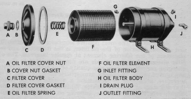

Without knowing the actual size, I'll speculate that it's the same size as the old cartridge type oil filters.

Nice project - you can make a gasket - trace the lid on an old inner tube and cut out holes for the two rods, or maybe find a mason jar seal ring but may not be compatible with PS fluid.
Looks pretty good all cleaned up, and yes red would be nice, but blue would be easier - no need to remove all the fenders and HW, dash etc. just get it close to current color match. Do you plan to sand and prime or?

Thanks Carl,
Yeah, I'll have to make something. Or I may take it up to the Tytan tractor place near me and see if they happen to have one. I am lucky in that regard. When I needed a clutch assembly I was able to drive about 30 minutes and pick up a new one same day. They are in Chehalis I think. I'm located outside of Kelso WA.
Every time I clean it it gets redder. The main tractor was painted black over the original red at the factory.
Not sure how far I am going with the paint. I have to remove the fenders and ROP to do the brakes. I have to remove the hood because I want to clean out the diesel tank so... maybe I will primer and paint the whole thing. It's a lot of work though for cosmetics.
I'll have to go measure it. Guessing it's about 8 inches in diameter. It does look very similar to the picture you posted. Was that filter for tractors or cars or both? What vintage about?
