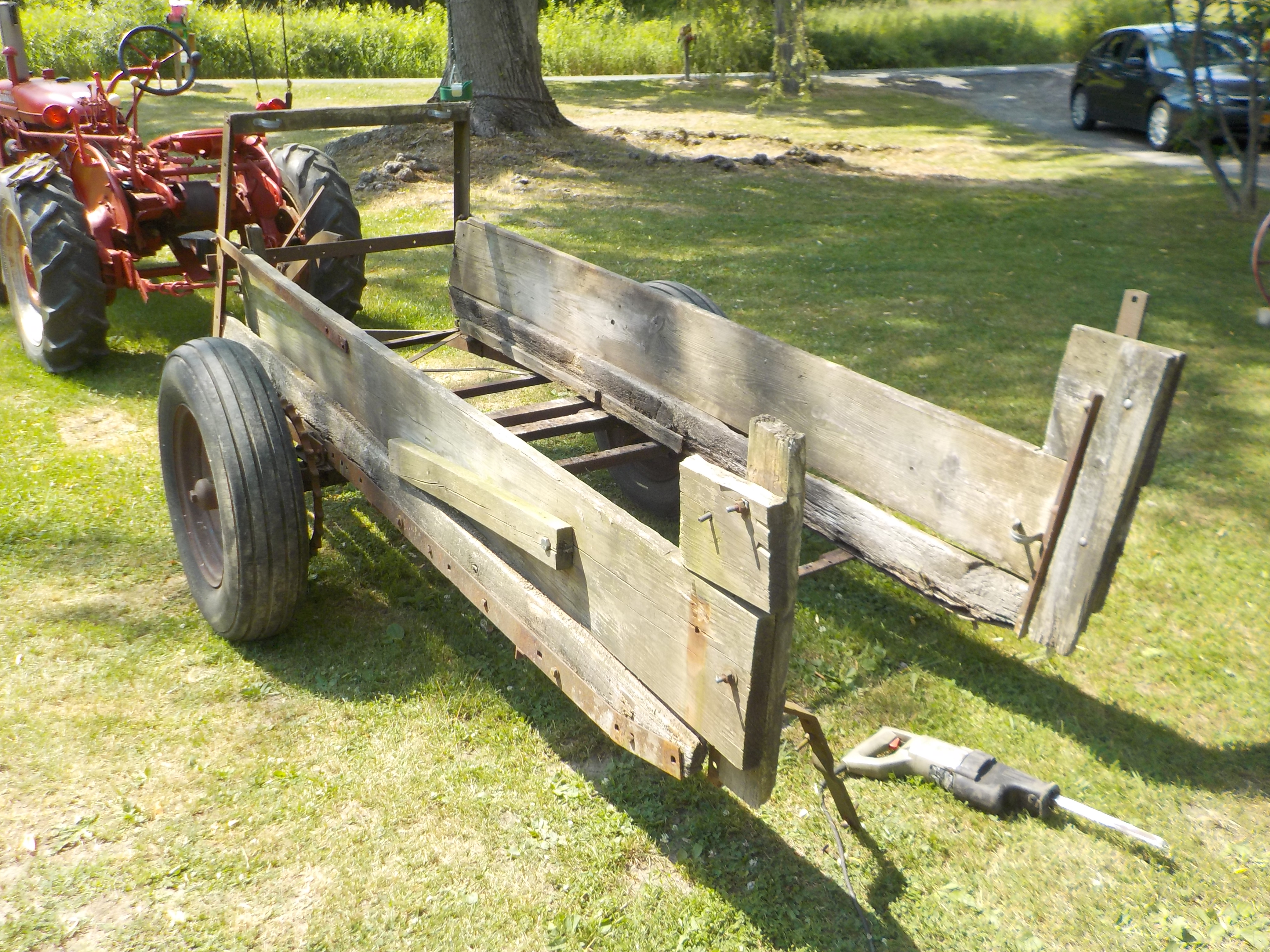

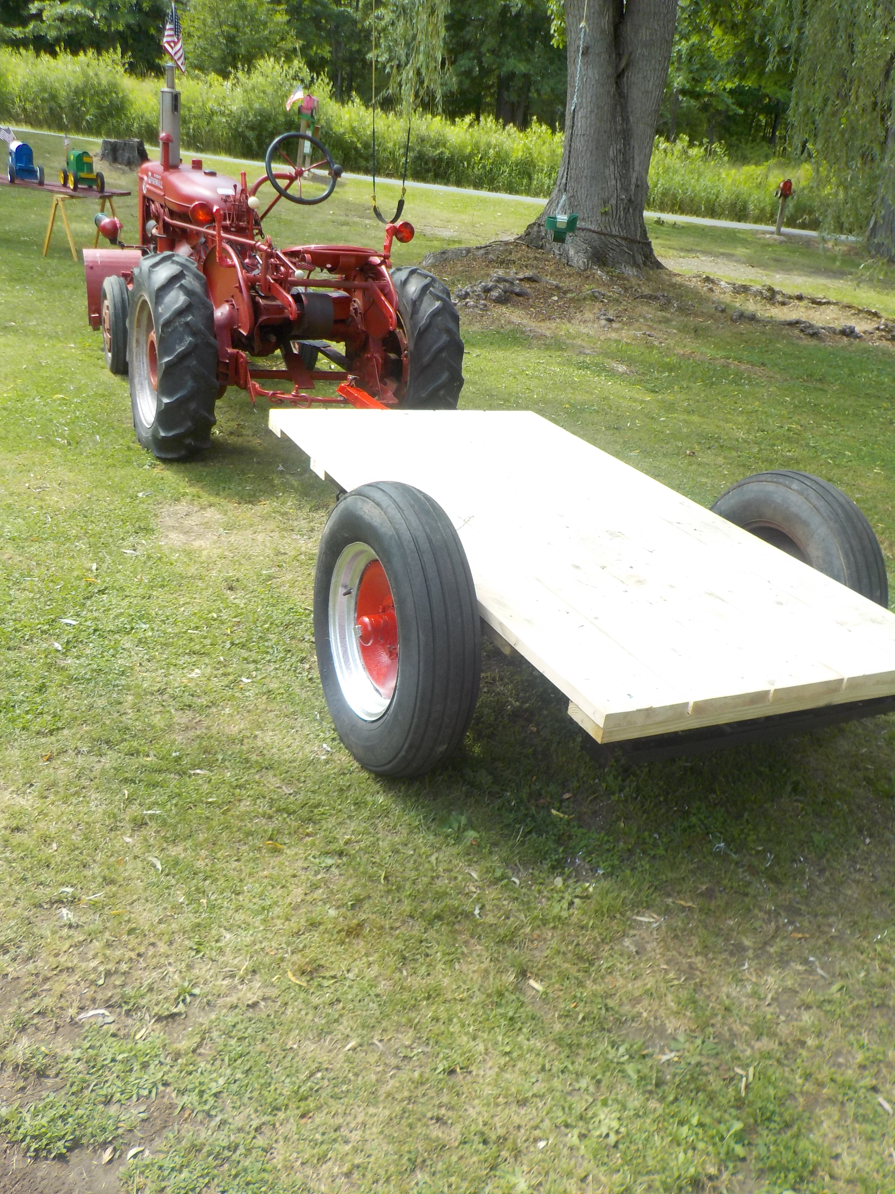

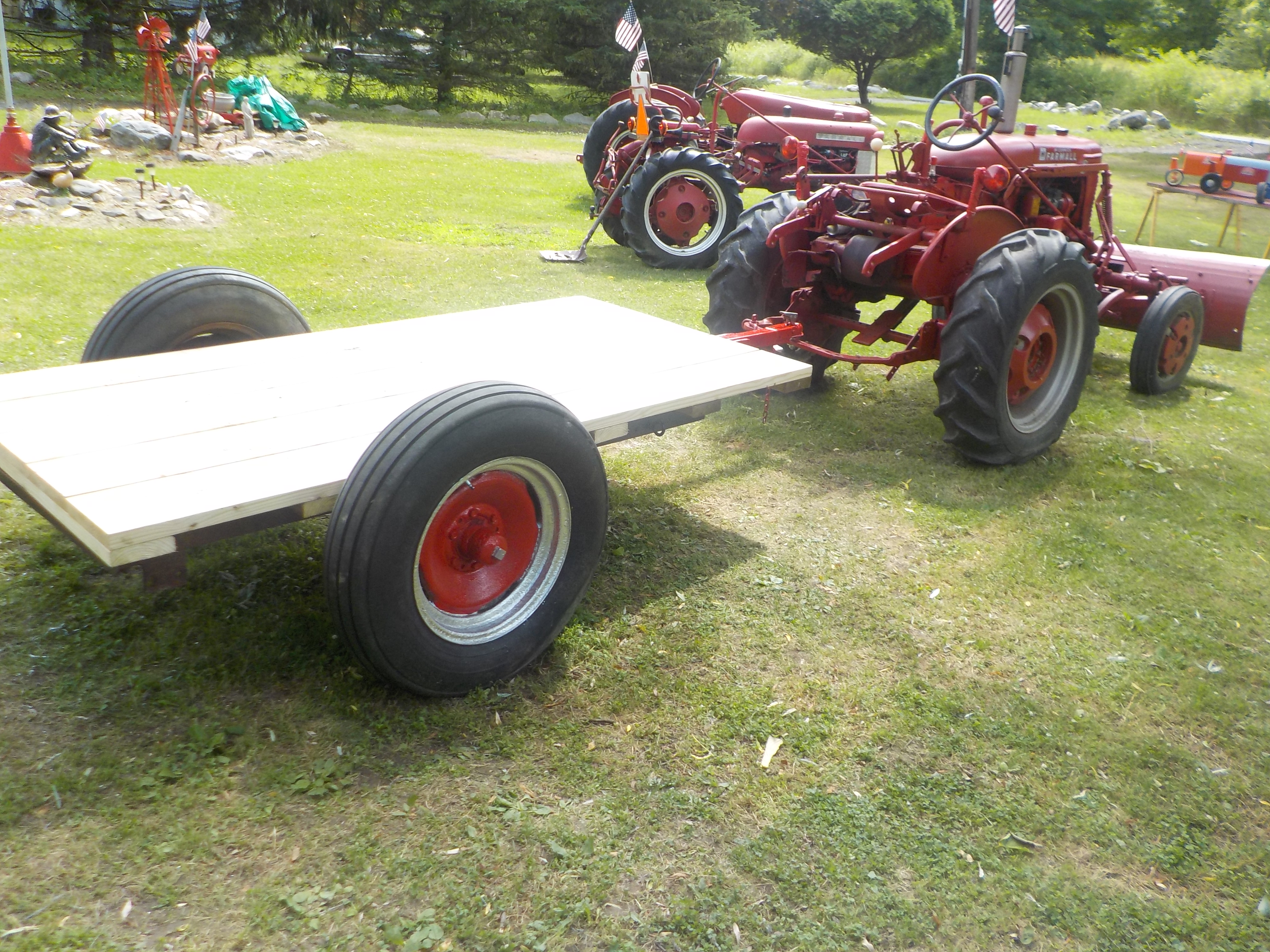

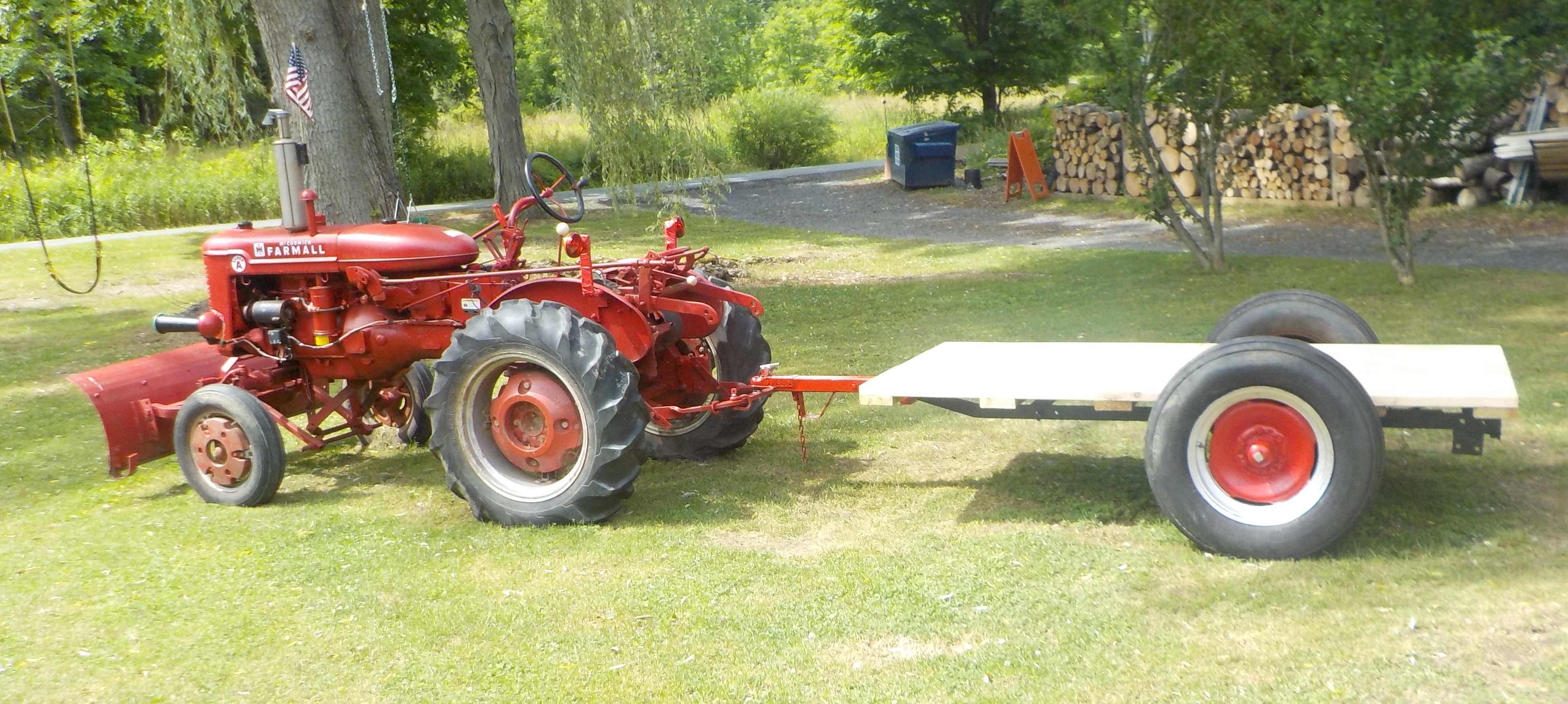

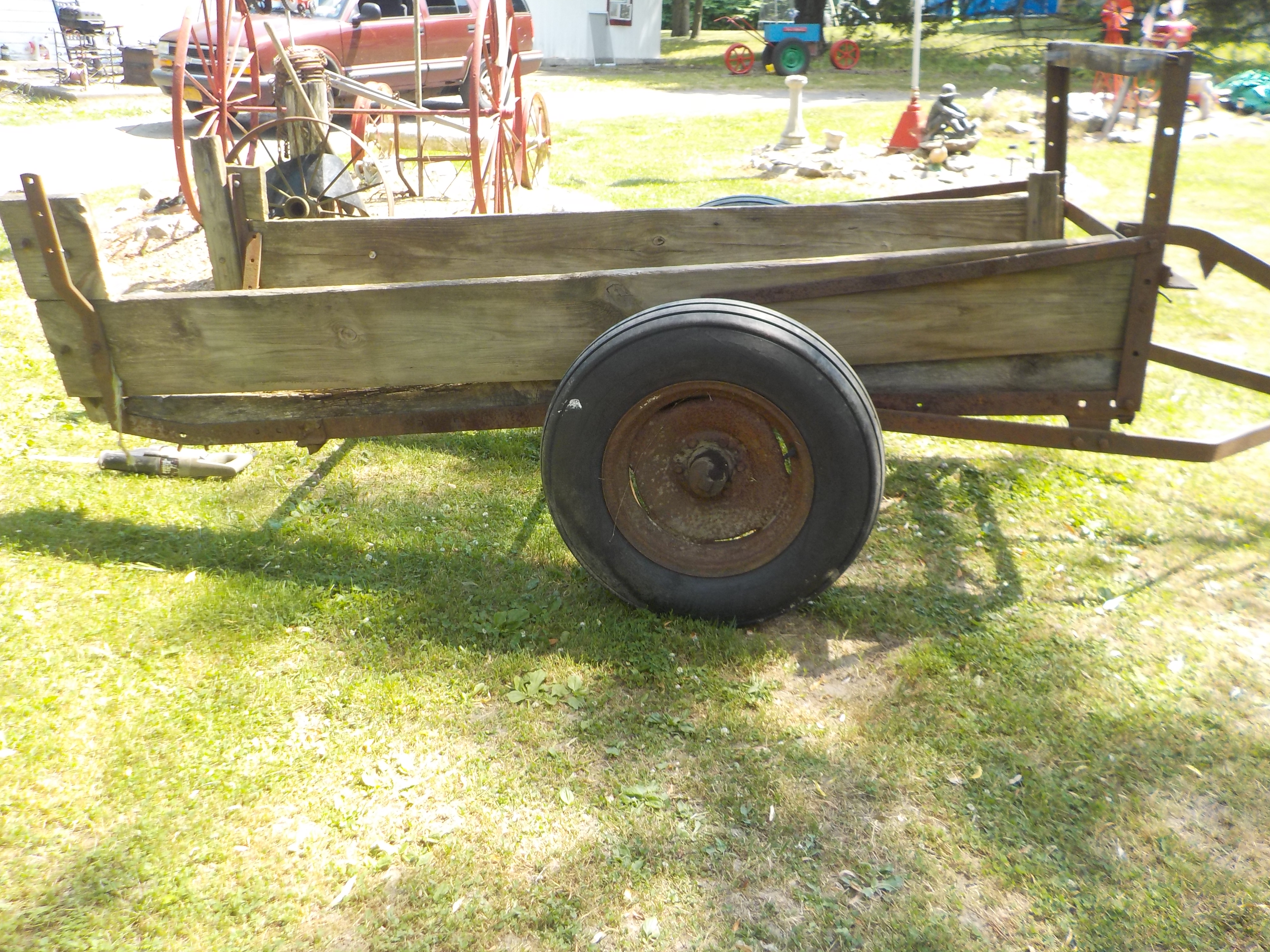

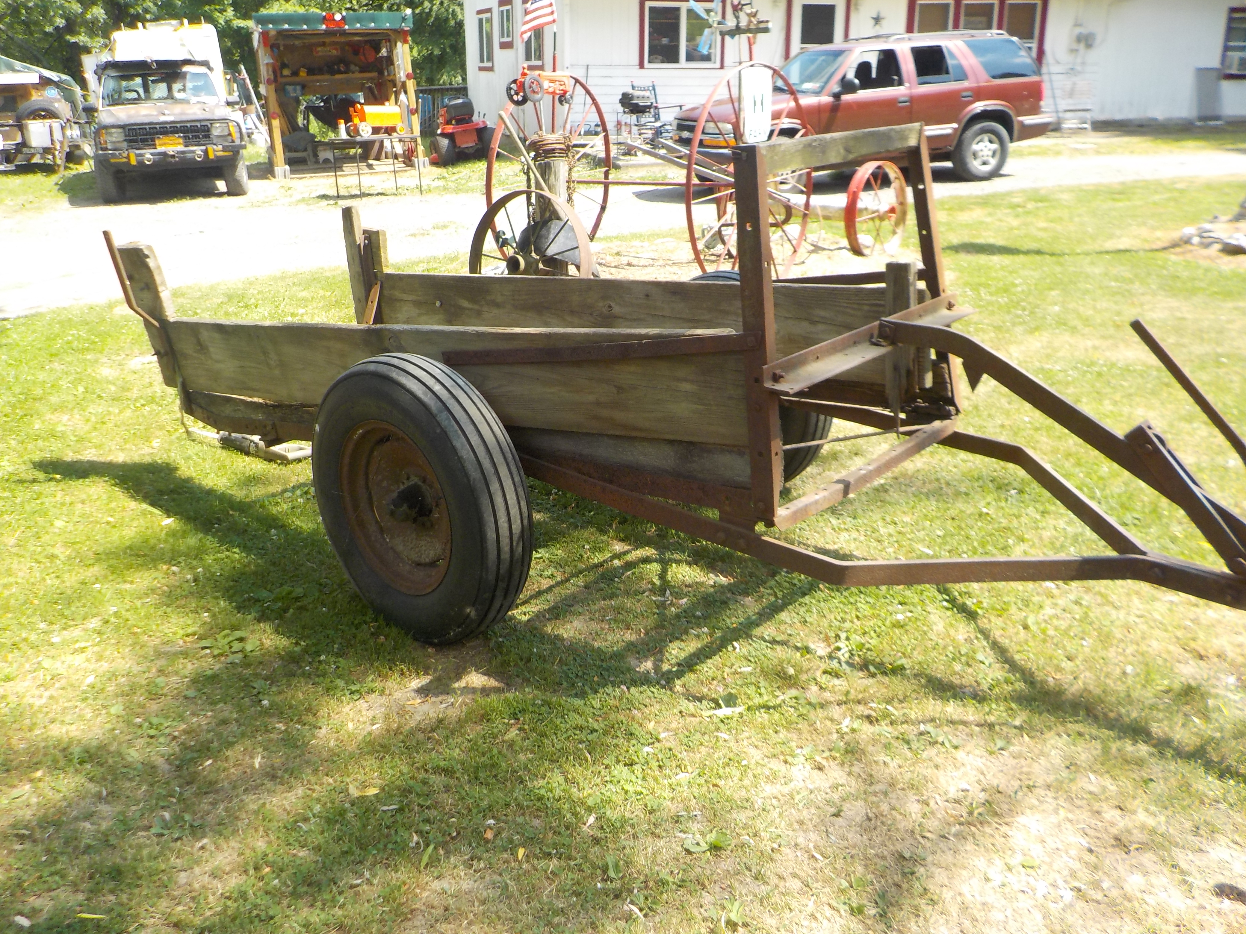

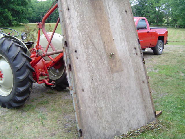

A Neighbor of mine had an Old Dilapidated 1940's Farm Cart that was in a Previous Life a Manure Spreader, which He said he was gonna cut in half and throw on the Scrap Metal Pile. Well, I told HIm, I'd Take it and put it to Good Use. He Just laughed and said, "It's All Yours."... A Week has now passed and he came by my place today. When He Seen what I did with it He Said, "Holy Crap, is That MY OLD CART?!!"
I Just Smiled at Him and said, "NO, THAT'S MY NEW CART!!!"
... She Now has a New Lease on Life as a Farmall Flatbed Trailer...
Looks Pretty Darn Nice Rolling along Behind the old SuperA
It's All about Saving the OLD IRON, One Piece at a Time

You did good! I'd like to see some sides, yet.
An after thought: I had a friend/neighbor, who recently died, who has an old manure spreader sitting in the brush. He kids are getting ready to part with his house. I'd better have a look at the old manure spreader tomorrow. I hate loading the pick-up with brush and many times the 14' trailer is "a bit of overkill"!

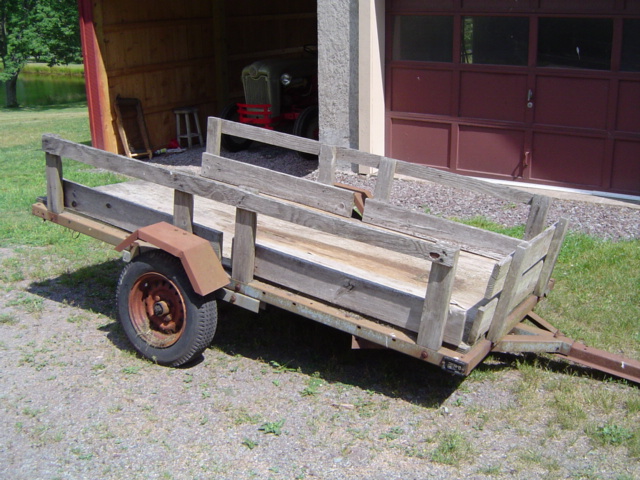

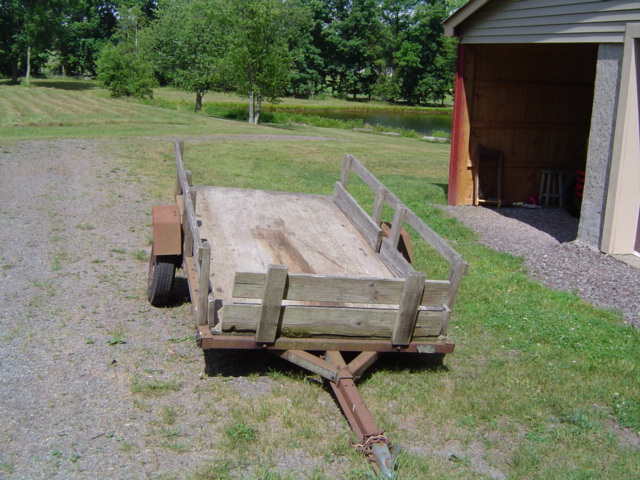

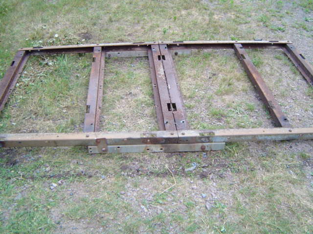

Well, your manure spreader trailer got me going. I looked at the old spreader up the road, but it was in pretty bad shape. So continued my search. Today, I stopped at a friends place and he said, "I believe, I have just what you need." .... a 4' x 8' tilt bed trailer. The axle and tongue need to be straightened, needs paint and it could probably use new bolsters underneath and a little additional TLC. It will be good for hauling brush, etc.. Plus, the "price was right!"

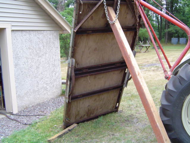

The "potential" wasn't as obvious, after I got into it!

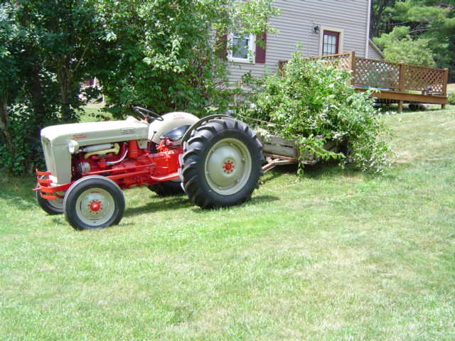

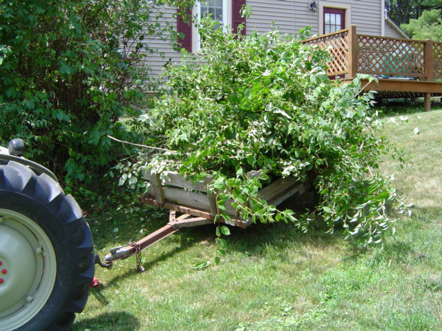

Yesterday, I hauled two loads of brush, just to "prove it's need".

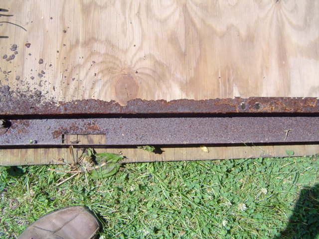

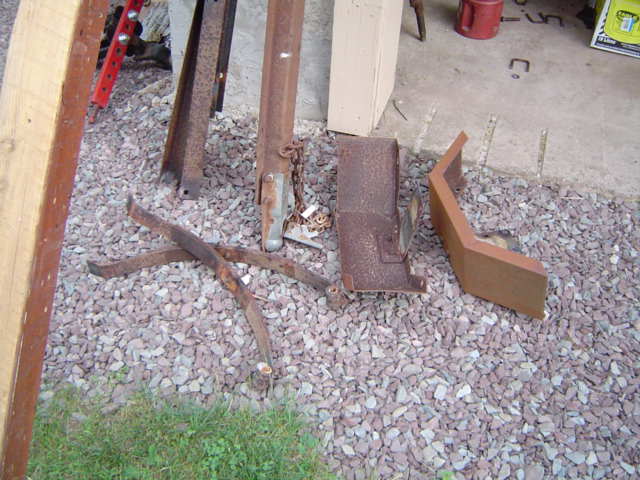

Yesterday afternoon, I took on the "restoration". I spent most of today in the hot blistering sun, burning off bolt heads.
When I finished today, I hadn't salvaged much, except the outside frame rails.

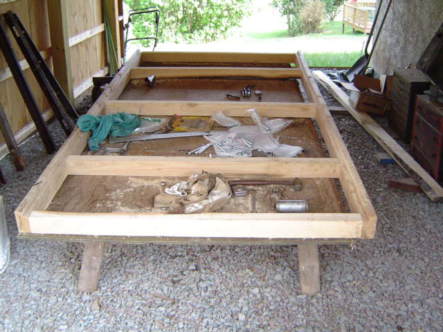

I can't find any metal "hat channel" with the same dimensions, so I believe I'll replace the bolsters with oak.
I still have to straighten the axle, and replace the wheel grease seals, races, bearings and dust caps. Plus, I believe, I'll get a new tongue.
After getting in to it, I believe, it was a "kit trailer".

I think, this project is in the right forum ("Build-It Yourself"), but maybe the wrong thread ("Just Saving Some Old Iron"), as I haven't saved much old iron!

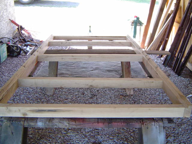

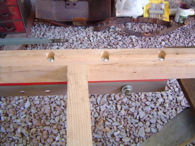

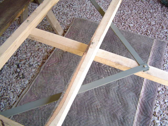

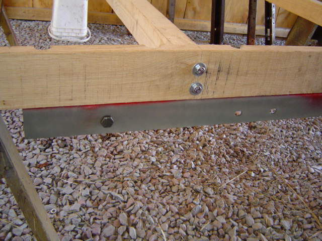

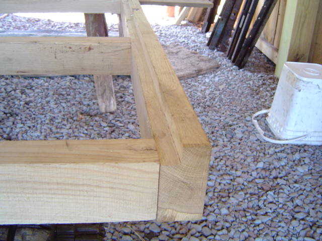

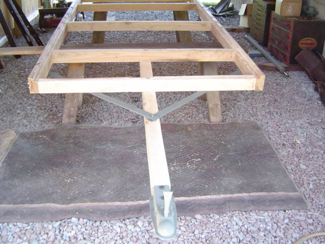

The frame is nearly done. I used full dimension 2x4 oak, some is cut down in size. The side rails are full, but have the inside corners cut out, to receive the 3/4" plywood deck. The hardware is mostly carriage bolts and lags, with a few machine bolts. The spring hangers are installed.
I have the springs to clean up, yet, the bearings, etc. to put in the axle hubs, post pockets on the front and sides and build the sides and paint ..... I think!

Sometimes, what starts out as a "Labor of Love" ... NOT BY CHOICE...becomes a "Love of Labor"
I Think Once We reach the MENTAL, "Point of No Return" We Convince Ourselves it's All Worth it!!!
You're Building a whole NEW trailer there! Looks Great
/ Just Saving Sime Old Iron #18
Thanks SuperA! I think, it will be around for generations, if somebody doesn't over load it, or jack knife it, backing up and run over the tongue.

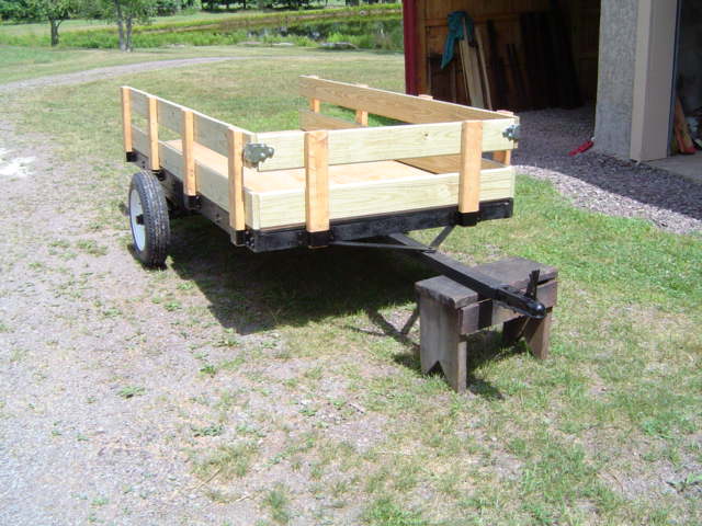

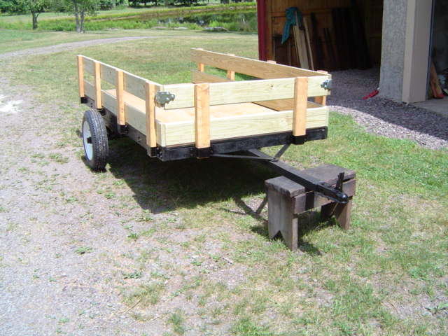

Before and after shots.

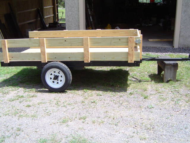

Well, it's all done, except for putting some deck sealer on it after the wood dries out. I had to get pressure treated for the sides, as they didn't have any 5/4 x 6" without. The only thing, I have reserves about is the oak tongue, but removing 3 nuts will allow putting on a steel tongue. It was more of a project, than I anticipated, to attain my goal. .... "A BEER TRAILER"!

Excellent Job, You really made SOMETHING out of NOTHING there!
Put a $10 set of Harbor Freight Lights on it and she's Road Worthy!
....You Done Good Son...Now don't You Dare go and get Her all Dirty!!!!
