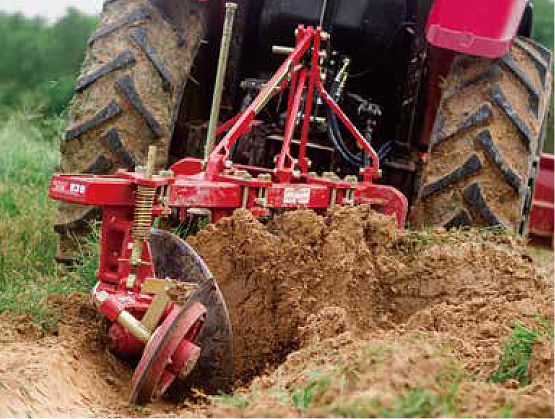

That lever engages/disengages draft control to regulate the ground engagement dept for an implement attached to the 3pt hitch. It's sort of a hold-over from the days when tractors were used a lot for plowing. When plowing it keeps you from having to constantly have a hand on the 3pt lift & lightning reflexes. It's not useful for much of anything else. I don't think I've used that feature on any tractor in 30 or 40 years.
Except once when I left it engaged by accident.....
To see how draft control works, take a look at the top connection of the 3pt hitch on the back of the tractor. See how that top link connection it is actually a pivot and lever?
Well, when the plow contacts an obstruction like a rock underground it puts compressive force onto the top link. That lever is on a heavy spring, but it moves just enough to open a valve inside the rear end that instantly raises the 3pt lift arms an inch or so. If that doesn't clear the rock, it all happens again...very rapidly.
Draft control forces are only crudely adjustable. Most of the time you don't want draft control, so you disengage it with that lever that is frozen up.
Forgetting to disengage draft control when using a 3pt mounted backhoe used to be the cause of many farm-related accidents & deaths.
rScotty

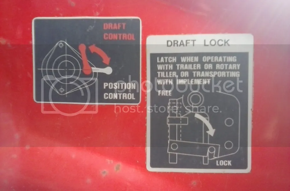

Reading the manual, draft control maintains implement depth when traversing hills and swales. It also reduces depth when the ground gets harder to help maintain power. This lever is not frozen. Looks clean and in working order.
   / Just picked up a 336.. couple quick questions #15
On the fender wall, there are these decals for the draft control.
The draft control also works with a bottom plow on gradual slopes. Ideal for potato farming on sloped hills.
