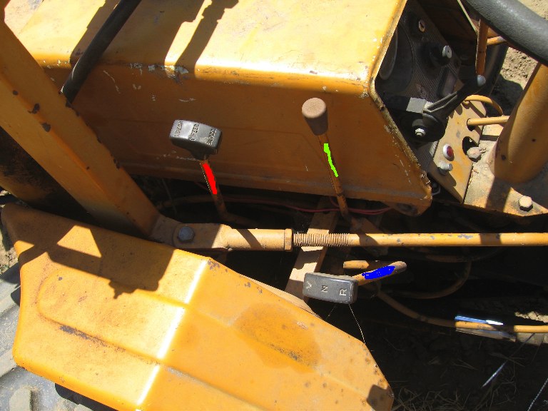

The control arrangement is the most frustrating aspect of this machine. The stereotype of Italians is that their hands are constantly aflutter with gesticulation; I've never been to Italy, so can't speak about that, but the expectations of their tractor operators would seem to imply it may be accurate. There are two pedals only: A clutch on the left, and a single brake pedal, operating two rear drums brakes. The remainder of the controls are all hand operated, and they are in odd places.
The steering column and part of the steering wheel can be seen in the upper right corner; this is looking at the left side of the machine. The red marked lever activates the front axle's differential lock. (Open differential in the rear, no locking ability) The green marked lever operates the three point lift. The blue marked lever is one of the PTO gear levers, selecting 540, neutral, or 750 RPM. The lift control is horribly obnoxious to me. It is forward and low; difficult to reach even for me, taller than average. It is impossible to reach the lever and look behind at the implement. Additionally, because it is operated by the same hand as the differential lock, it is impossible to both control the implement lift and simultaneously engage the differential lock, as might be required when working with box blade rippers, a heavy 3 point disk, etc.
The right hand operates the gear shifts on the right side of the dash board, with the speed selector and range box. The right hand also operates a mechanical parking brake under the seat (marked blue), while on the left side under the seat is the ground speed PTO control (marked red).
