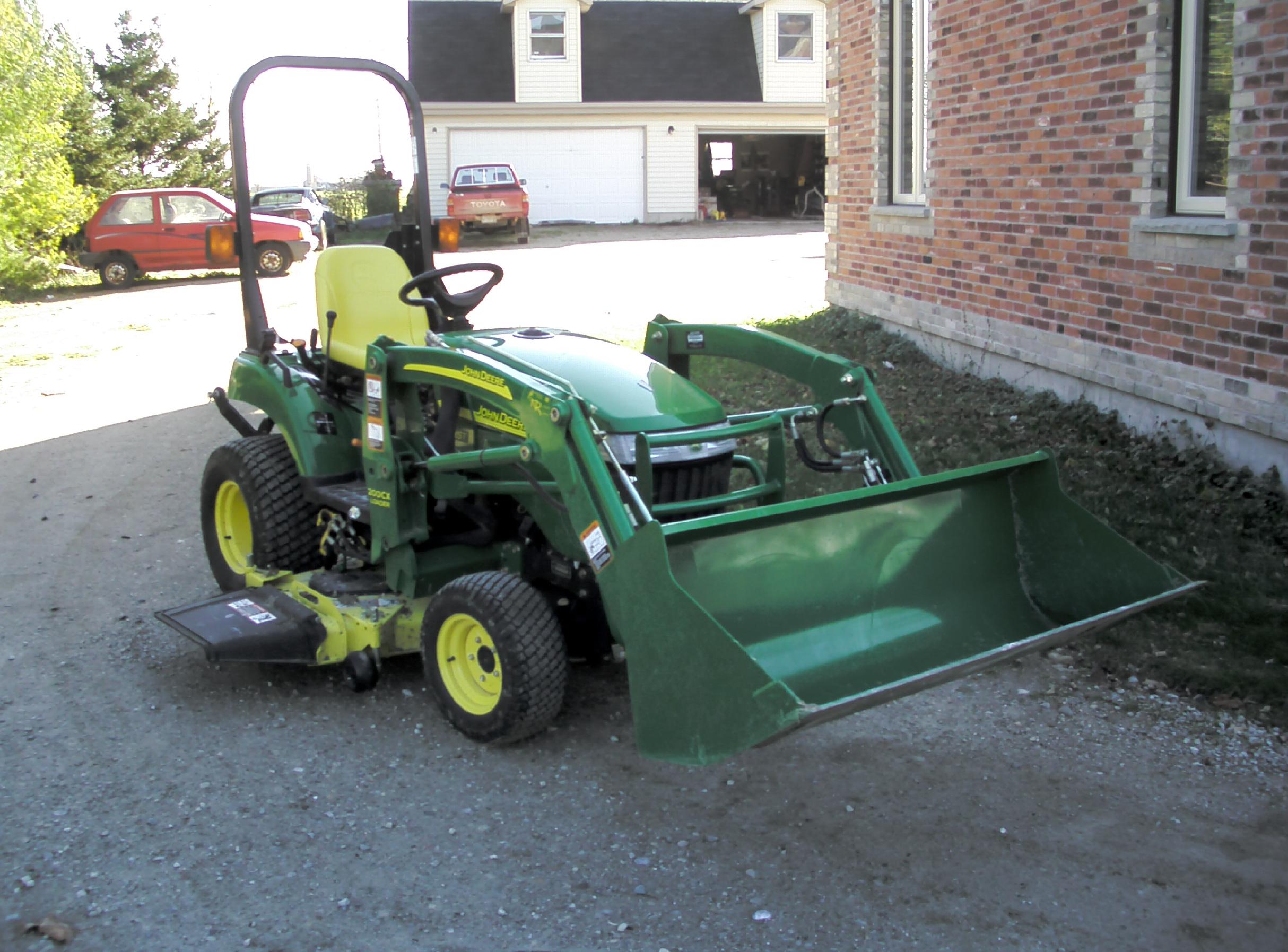

hello everyone thought id share with everyone that we just got our new 2305 and now im lookin at what to make for it. I was wondering what are some well needed attachments for it? looking for some projects over the winter
/ just got new toy!!
#2
here are some pics i had to resize them because they were to big or something i have no idea so here they are

Nice little tractor you got there. As far as attachments, I would go with a york rake with gauge wheels or a boxblade. The box blade seems to be more useful but both are very valuable. The box blade will be about half the price too! I don't have a york rake, but my box blade has been a pretty valuable tool.

It is not an attachment but you want to flip the lights in the ROP. They'll snag and break off pretty quick.
/ just got new toy!! #6
Yeah, I'd remove, flip, or build a shield/cage for the flashers on the ROPS. I have a 2320 Deere, didn't take much more than a couple months to find the wrong tree branch with one...
Deere sells a guard kit for them, not sure how much it is or how much it protects...

As for other attachments:
Lots of folks on here build grapples for their loader bucket. I haven't yet, but I've run into plenty of tasks just this past summer that could've used one. (moving downed branches/trees, etc)
I have a box blade for mine to grade the driveway. Didn't build it, bought a King Kutter 5' one at TSC, then painted it JD green and put a John Deere decal on the back. Did that partly to match the tractor, partly to clean up and cover all the paint chips and rust that it came witch. Seems pretty common for KK stuff.
I recently bought a KK middle buster to do primary tillage and fall tillage in our garden to help mellow out that soil. Works good. Would be easy to build a middle buster or subsoiler, not much too them. Biggest thing is having/getting the big chunk of steel for the backbone, I think the KK is 1" x 4" bar, was easier to buy the whole thing for me than tracking down a short chunk of big iron like that.

thanks for the sugestions, I didnt even think about the flashers il have to come up with an idea i might just flip them inside. and yes i do live in ontario and there already calling for snow :)))) but yeah we have a 5425 with a 7 foot blower on it that we use to blow our drive way. Were just going to use the FEL to do the areas where the blower cant fit. And a question about the grapple. i want to make one but there isnt any other hydralic hookups on that tractor beside the FEL ones. Has any one that ownes a 2305 put auxilary hydraulic outputs on these things?
/ just got new toy!! #10
Do a search on this forum for grapples. Lots of folks have built them, most had the same issue with needing a 3rd hydro function. The options seem to be:
1. Add a solenoid actuated splitter valve to allow a pushbutton switch on the joystick to divert the dump/curl function on your tractor to your grapple. Basically inserts a valve after the couplers on the tractor with one set of outlets on the valve going to the normal dump/curl hoses, the other set going to the grapple...
2. Add a third function valve. Basically have to tap into the hydraulic system like a power beyond kit would and put a valve there for a third set of couplers or something... Not sure if the 2305 is set up the same as the 2320/2520, but this thread had some good info on hydro mods:
http://www.tractorbynet.com/forums/hydraulics/100228-adding-power-beyond-3-spool.html

The grapple is a great work saver, but you gotta have the type of work for it to do. Do you have trees, brush, big rocks, or other type of things that need to be moved/grappled? Then I'd say get one! I use mine all the time.
Had a 16" diameter tree fall down last Friday. Sat morning I cut it into 5 or 6 foot lengths, grappled it away, and was done in record time.
A Carry-All rear forklift is a nice utility item to have and pretty easy to build.
OH...i got it.... Bucket Forks!! That's a good project!
Can you list some of the things you plan on doing, or need done?
Cutting firewood?
Grading your driveway?
Clearing brush?
Putting in a garden?
Landscaping?
Your hobbies and chores will lead you to the items you should consider building.
