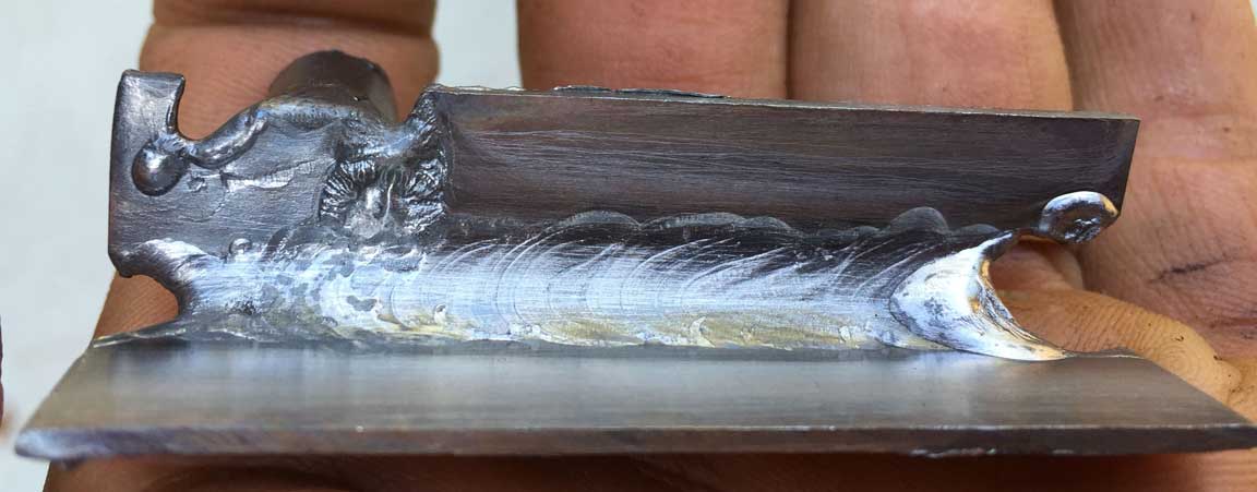

You're running to hot, (burn through at each end), and not adding enough filler. Hence the undercut. ;)
Oooops. I looked and it is undercut. :ashamed: I bought 1/16 filler, it goes in pretty fast, prob should try 3/32".

I think you're trying to make too big of a weld. TIG welds are generally much narrower and neater than any other welds. 1/8" material for example requires a 1/8" fillet weld. TIG makes a weld like that easy compared to anything else. If you need to weld 1/4" TIG probably isn't the best choice depending on what you're welding.
