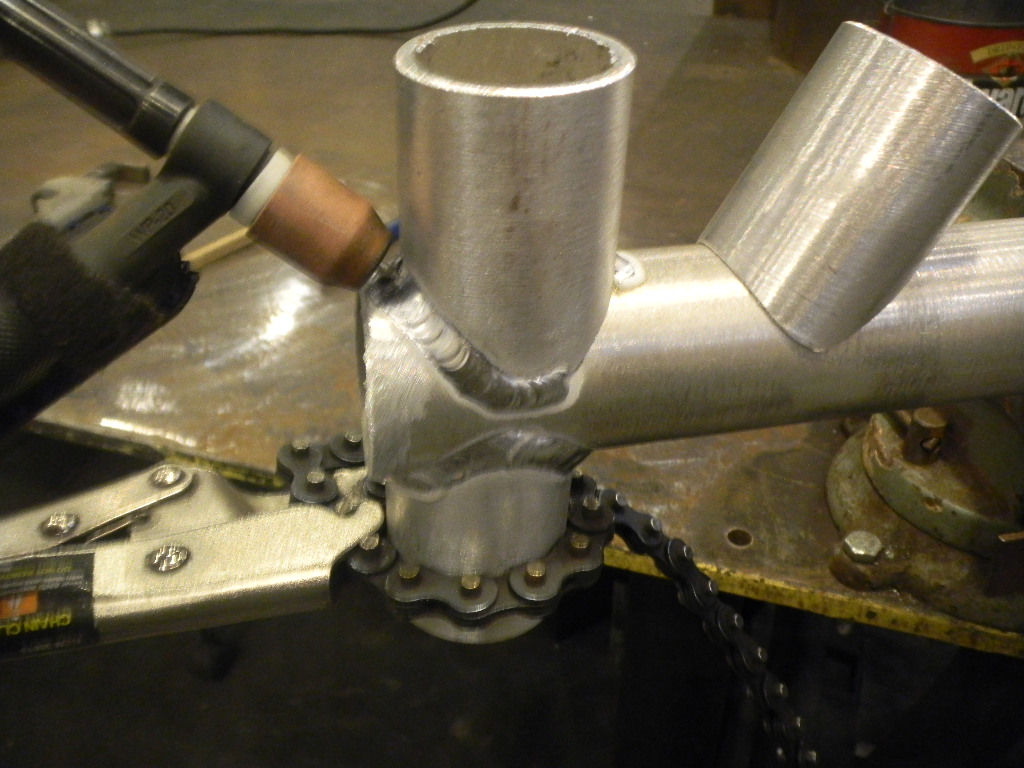

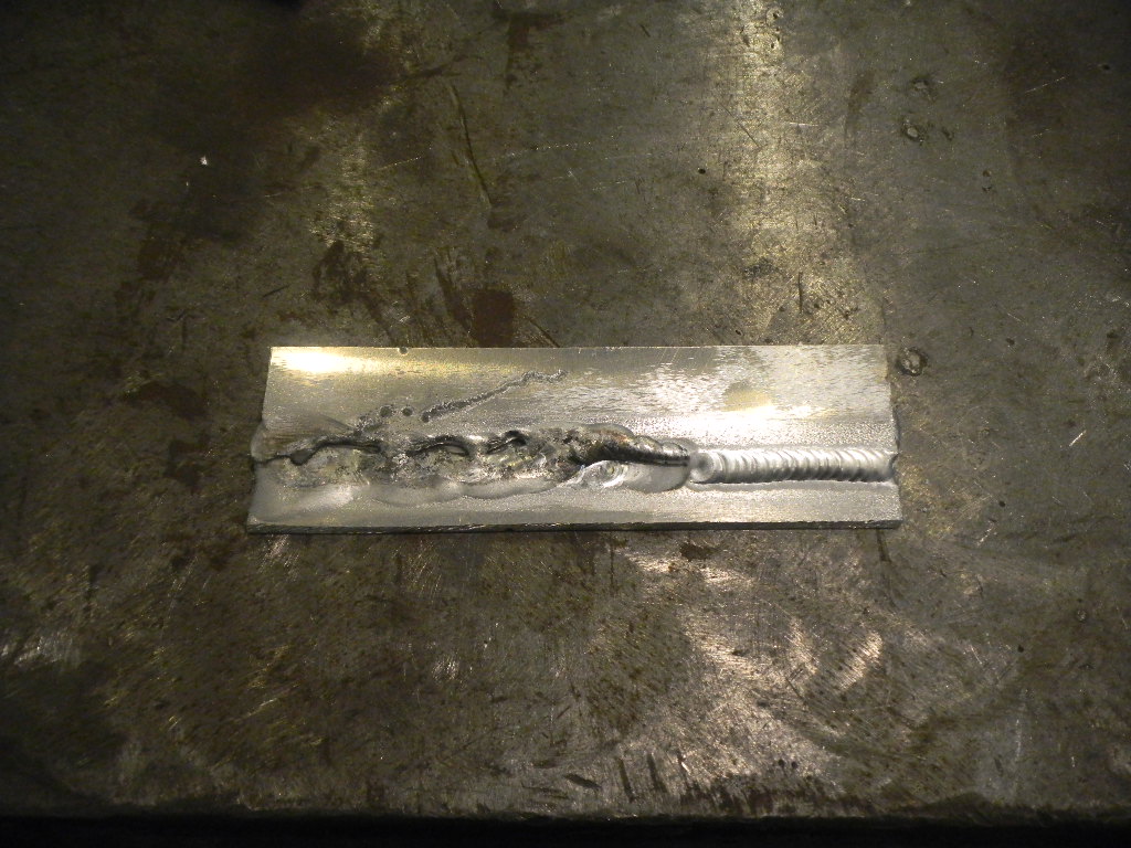

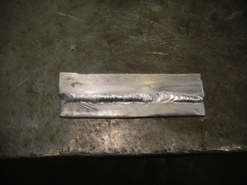

Remember that mechanical engineering student I helped with the aluminum bike frame?
He went from this first picture, to the second picture in about 2-hours.

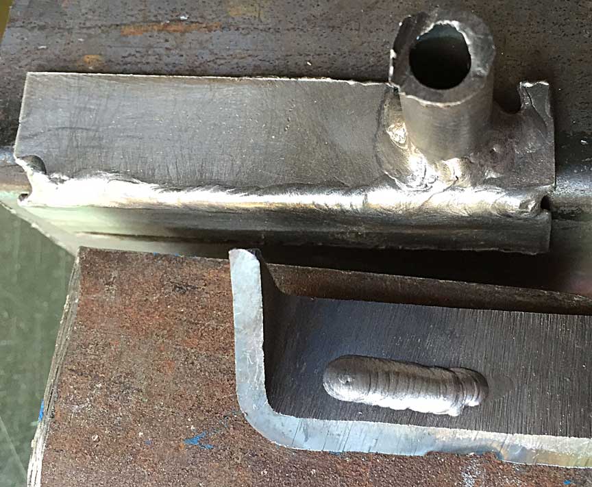

OK here's the 1st 3 TIG welds. This kind of welding is so "civilized". Similar to O/A but the flame doesn't blow the puddle around. And it's much more difficult to keep the arc lit than a flame, but you can reduce the heat. Neat stuff! Wish I had it years ago.
#1 First weld is just a bead on a flat 1/8" thick steel.
#2 weld on the outside corner of 18ga Stainless
#3 is a 3/8" pipe to the 18ga. The bead advances quicker than I expected, not easy to follow around the little 3/8 OD pipe.
I never did find a video showing how you start the arc. Can this be explained in words? Ended up just flooring the pedal, and lightly touch the point and lift off a tiny bit. Sometimes it sticks, and I do the stick-welding memory-motion and break it off like a dog with it's jaws on a gopher. I had to grind my tungsten sharp again 3 times. ,,,,,,need a better technique if I'm going to be a civilized man.

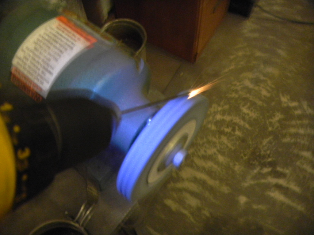

ZAP one of the moderators over on Welding Web has a great idea for sharpening tungsten.
Remove the wheel guard on your bench grinder, and stand behind the bench grinder. Use a drill motor to spin the tungsten. Now this grinding wheel should only be used for grinding tungsten.

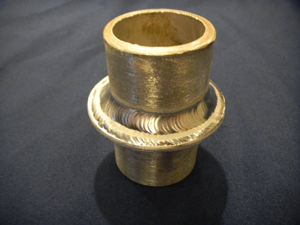

You are making me want to go out to the shop and melt something with the tig that I have never used.
   / Just got first TIG rig! #10

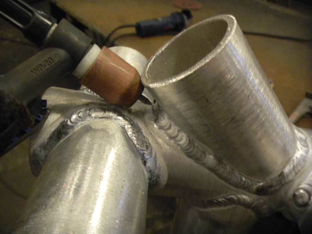

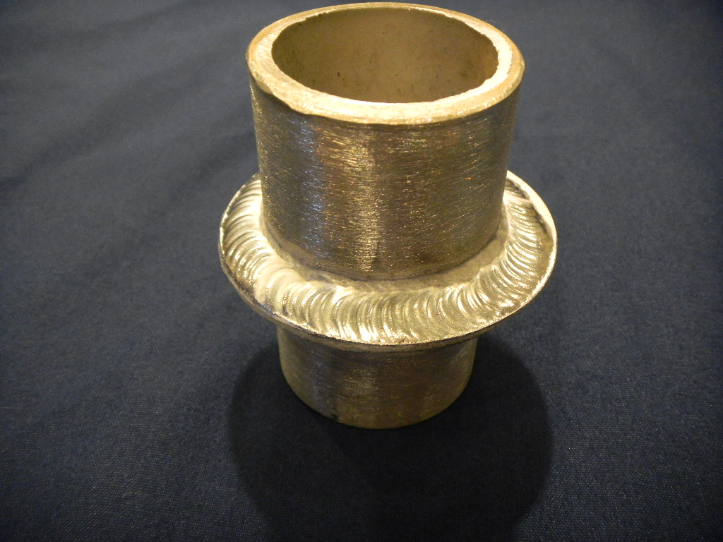

Tig welding can be very enjoyable!
