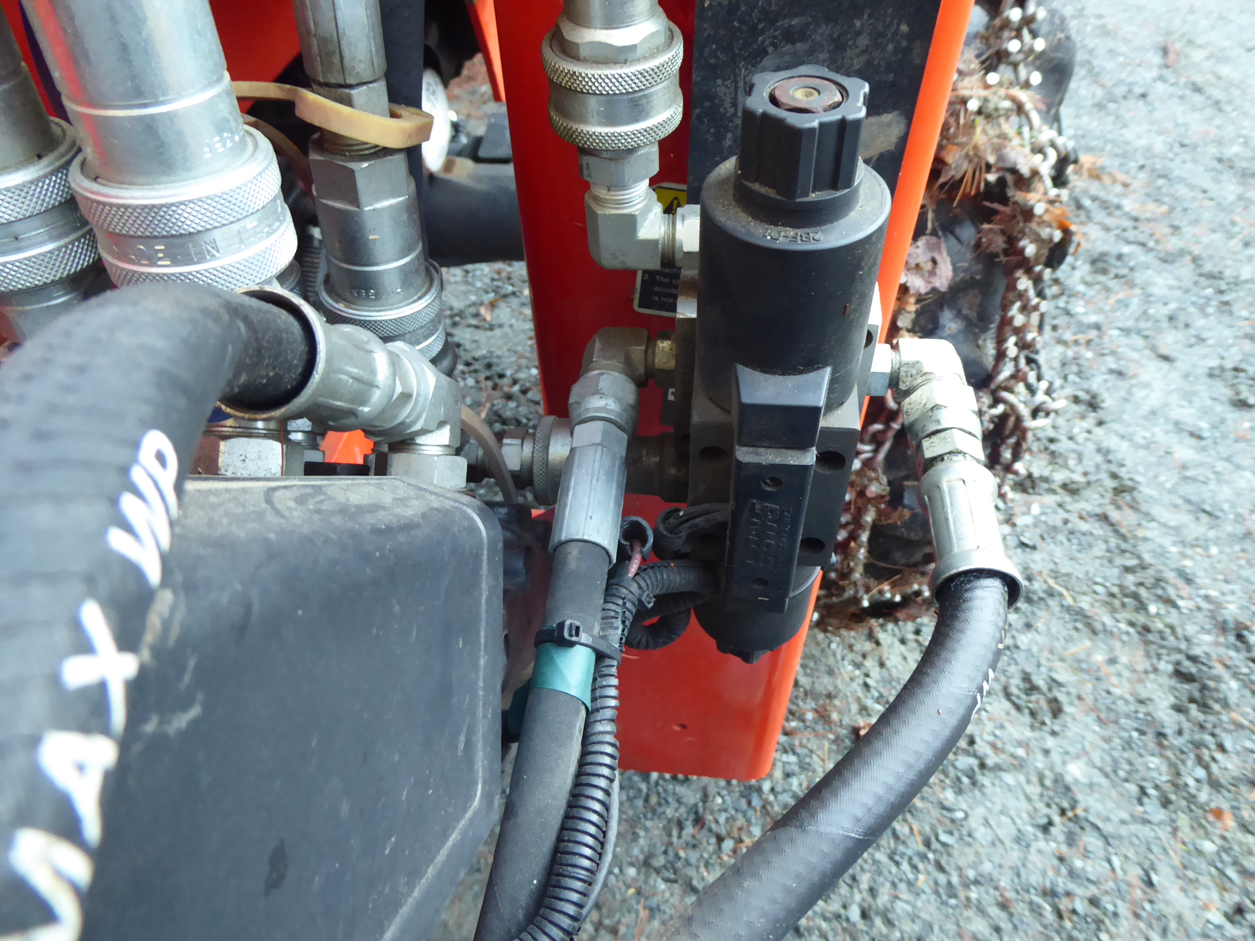

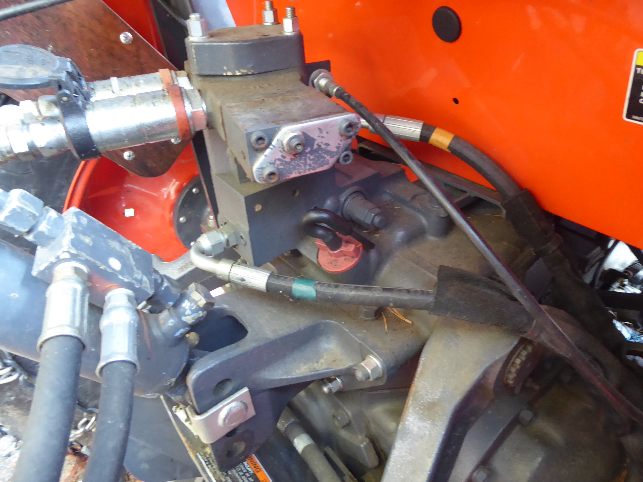

Here are some pics. Hydraulic Block - Green is pump out

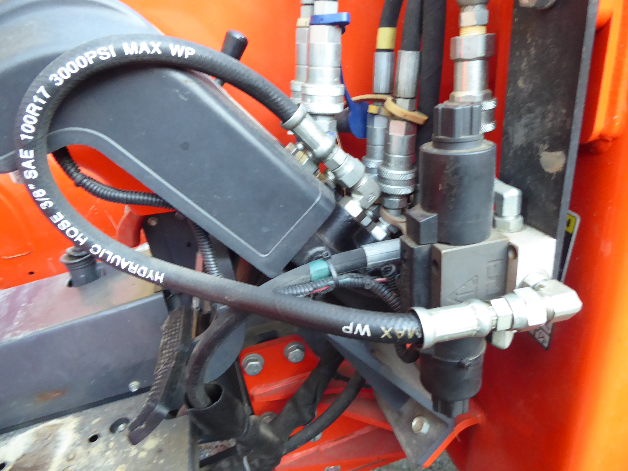

3rd Function valve - Green into Power Out

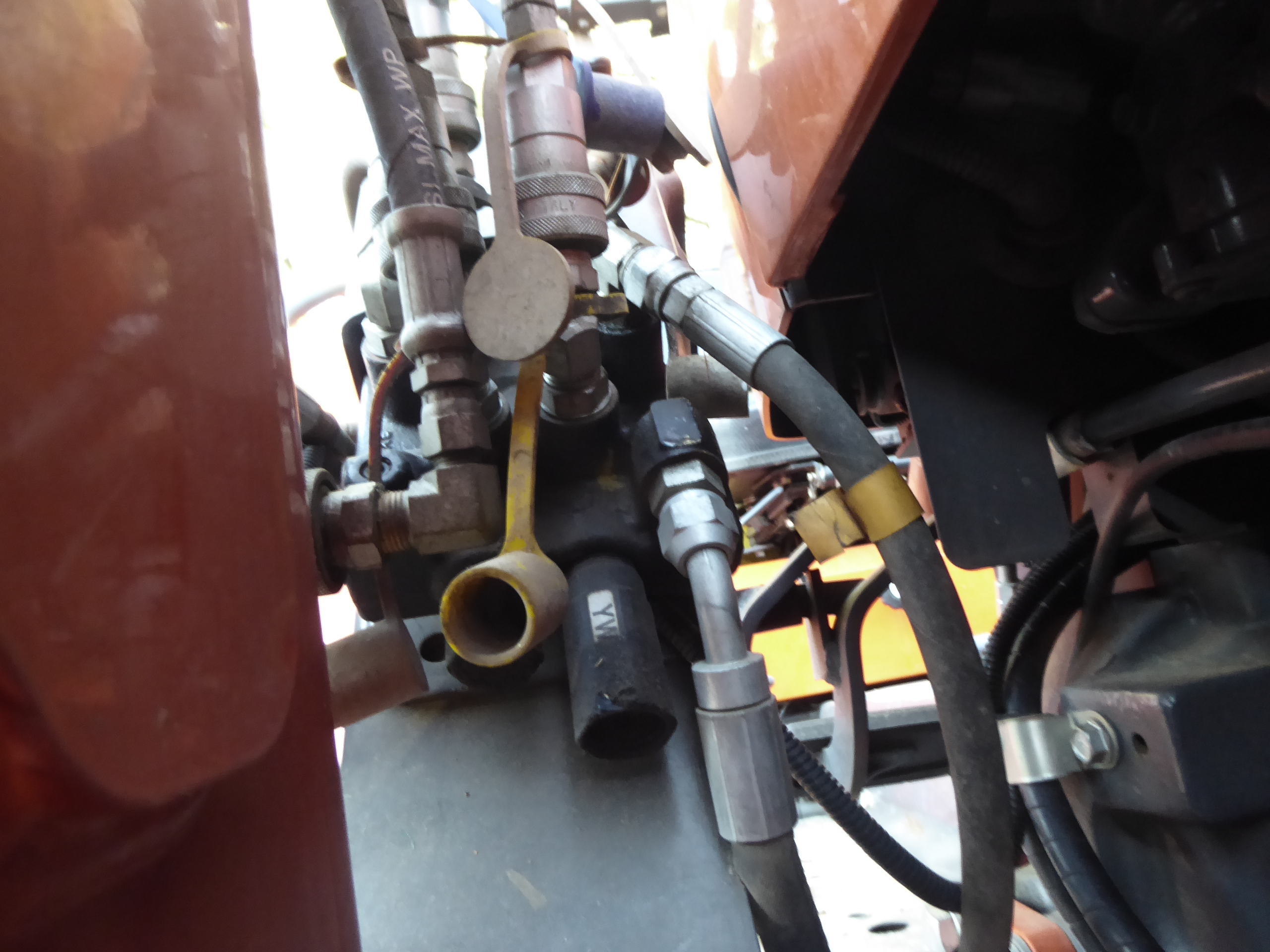

In front line goes from Power in marked P on 3rd Func to Loader Valve PB out
Yellow on Loader valve is Power In and goes back to The hydraulic block Power Beyond in (see pic 1)

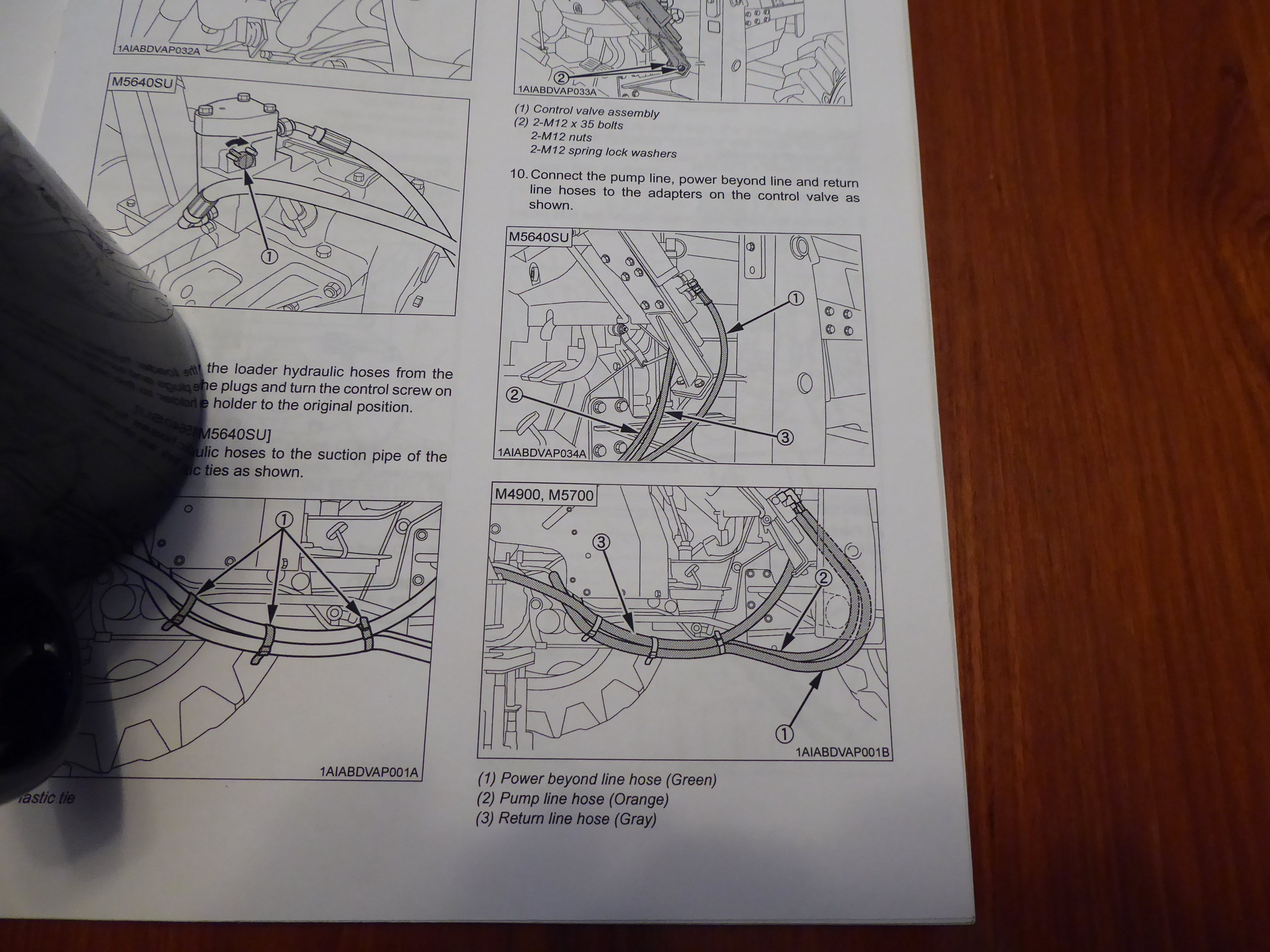

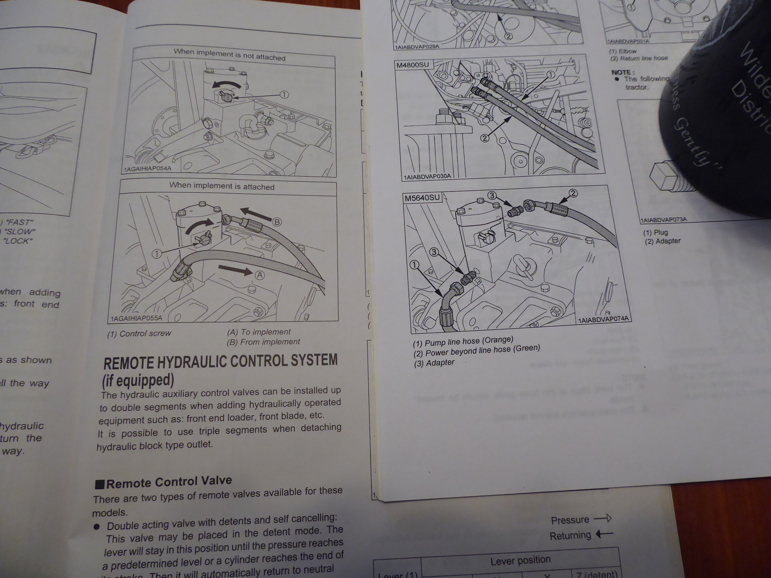

A couple from the two manuals

Great video describing all the routing Gordon. Along with the pictures, it helped tremendously figuring this out.
From your description and following the hoses, it does indeed look like the green and yellow are swapped. The good thing is that the loader valve is hooked properly, it's just not on the right order. Should be loader valve then 3rd function.
The green line should go on the In port of the loader valve. The PB line from the loader valve will feed the P port of the 3rd function. The T/Out port of the 3rd function will go back to the PB port of the hydraulic block.
Regarding the functionality of the system. I don't think you won't notice anything after the changes but the system will be better protected this way. If anything, the 3rd function won't get flow until you have the loader valve lever in Neutral.
On a side note, the Tank hose on the loader valve (4rd picture) is rubbing very hard on the mount. You may want to loosen the 45 degree fitting and rotate the hose slightly so the mount doesn't cut the hose open.

Well I solved the mystery. It turned out to be the only thing that would make all the info and knowledge from you guys correct and me looking foolish.
I took off my small belly pan and cut all the tie wraps securing the hoses inside their sheath to the tractor bottom. I removed the Green hose from the hydraulic block then loosened the green hose at the 3rd func valve so I could rotate 180 for it's new connection point on the block. It wouldn't rotate. Started pulling on hoses. What the flip - The Green hose has Yellow tape on the other end and the Yellow has Green. The joke is on me. All I need to do is swap the tape on one end.
Thanks for the support and sorry to be a bother. In hind sight I should have taken the bottom off first and removed a hose end so I would be sure.
