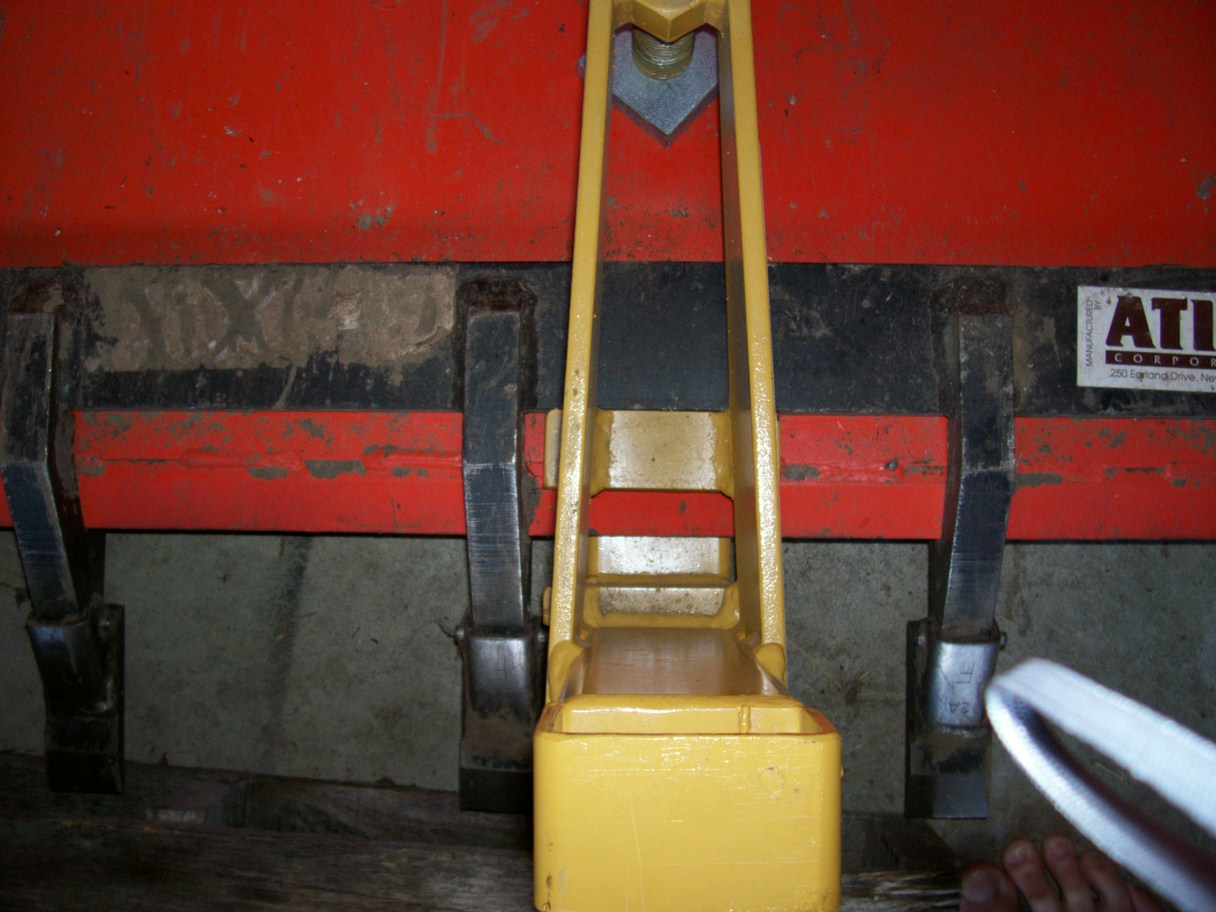

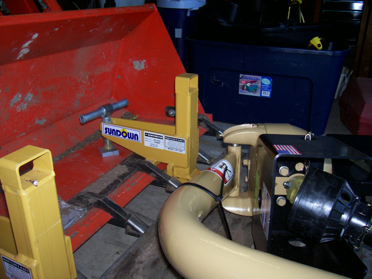

Timber, what brand are the clamp on forks you have. They look real heavy duty and I am in the market for some. Thanks.
I actually got these through my Kabota dealer. they were like $400 but I had a lot of concerns about damage to my bucket and bending and slipping. I am in the Trucking business so I do a lot of work with fork trucks so it was important to me to have fell forks. They sit real nice against the tooth bar. So far there great. I am going to make a 3 point fork lift frame as well for heaver lifting. as well as easy ballast wt

I posted pics of the forks with all the information on them for you. There is a phone number on them as well as the model #number and any other information you may need

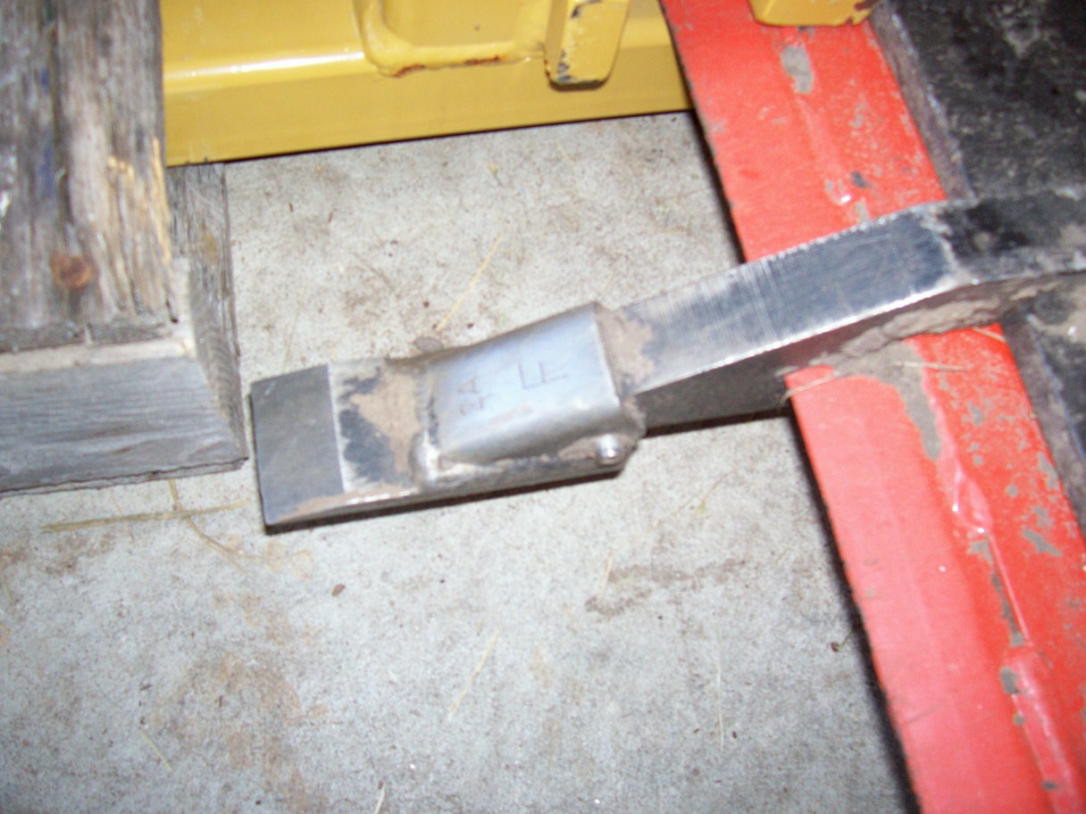

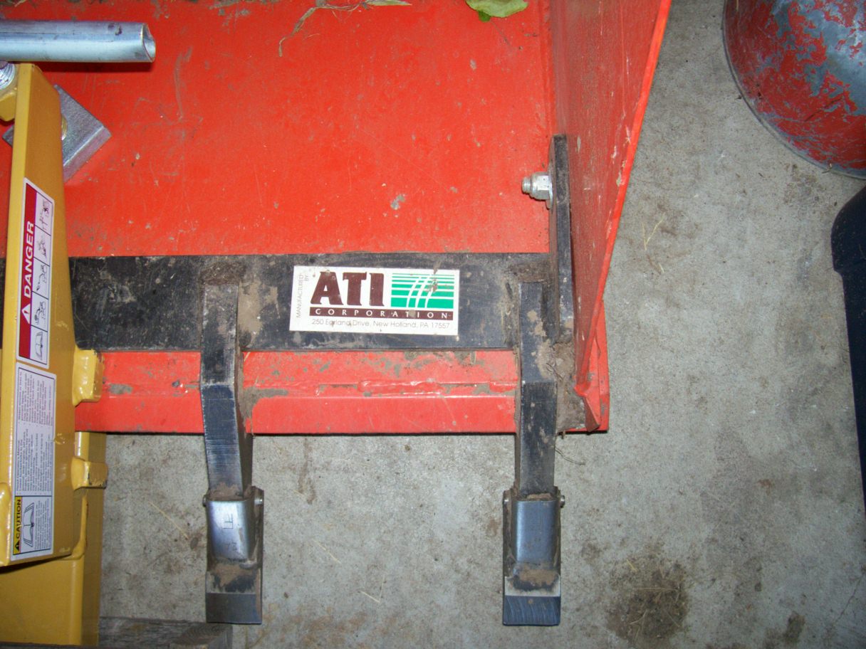

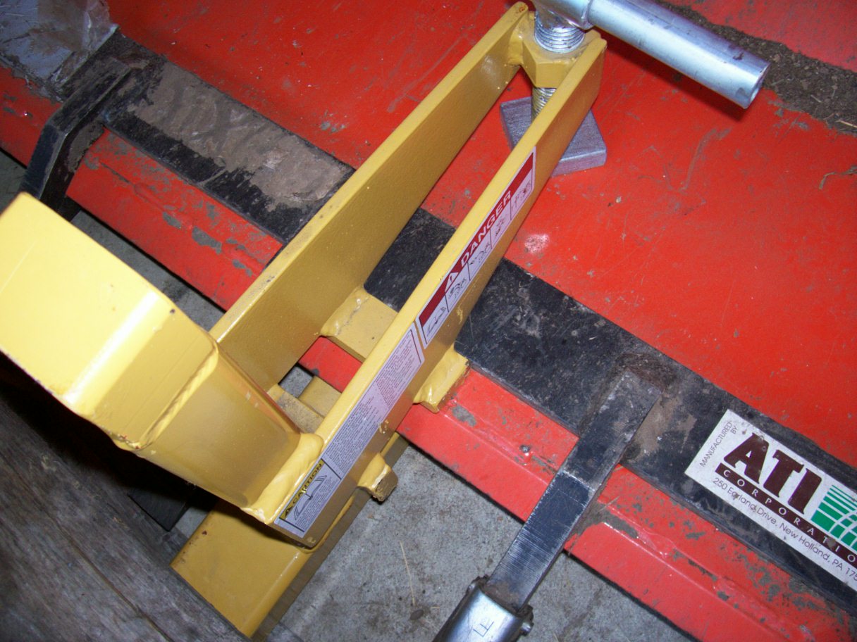

I went with the ATI with replaceable teeth. It was only another $50 for that feature. I also added some pics to show how the tooth bar stabilizes the forks as the fork rest sits against the the tooth bar

The only disadvantage to the tooth bar and the forks together is when using pallets the teeth steal 2 inches of the forks.
