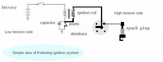

   / Just bought an 8N #18
xlr82v2 said:
I don't think it makes any difference to the coil what polarity is used...
Perhaps it's a good thing you aren't an electrical engineer perfroming a critical job.
Study the schematic i am attaching of a kettering ignition system.
At issue is whether you are discharging thru the secondary only.. or if the primary will be inline witht he secondary.. it's an issue of a large resistance coil, or a large resistance coil plus a low restance coil. Not a huge issue.. but electrically speaking.. it is significant.
On later 8n, you can swap wires on the round can style ignition coil primary connections. On the early 8n, the coil is a squarish block atop the distribuitor and you cannot reverse the wireing connections on the primary.
Soundguy

   / Just bought an 8N #19
Soundguy, why are you trolling for an arguement?
No, I'm not an electrical engineer, and never pretended to be one...
But since you are (either one, the other, or both,) maybe you would like to educate all of us on "thermionic discharge/edison effect" and their/it's applicability to breaker ignition systems (although I fail to see why this is relevant to the OT of this thread).
So, to get back on track, in the real world, 99.98% of all Ford 8N 12 Volt conversions using the Delco alternator that you will ever encounter will be Negative Ground. Except, perhaps, for Soundguy's.
I didn't come looking for an arguement, and I'm not going to participate in one.
   / Just bought an 8N #20
OK, I had to go back and re-read this thread to see where it fell off the cliff...
When I said
I don't think it makes any difference to the coil what polarity is used... the primary is still the primary and the secondary is still the secondary...
I said that in the context of "real world, home mechanic, do it yourself, will it run or not after I convert to 12V Negative" frame of mind. The answer to that is, "Yes". See the quote above.
I did not realize at the time that I would be jumped on by an EE with a chip on his shoulder and a point to prove... Yes, obviously, at the quantum physics level, there are certainly some differences. I'm not disputing that at all, one iota. All I'm saying is that it will still run, and run reliably for a long time. There are too many thousands of these frontmount tractors out there running everyday converted to 12V Negative systems with no problems to say otherwise.
However, since this particular tractor that we're talking about has the side mount distributor, and the automotive type coil, this whole thing is a MOOT POINT anyway, as it doesn't apply in this case unless the wires weren't swapped on the coil at the time the conversion was done.
So, to the Original Poster, as for myself, my apologies. I was in the garage with the toolbox, Soundguy, I think, was inside there with the electrons.
Soundguy's big post was excellent and had about all the info you need to run your 8N. Don't try to convert it back to Positive ground with the same alternator, or you'll fry the diodes inside.
