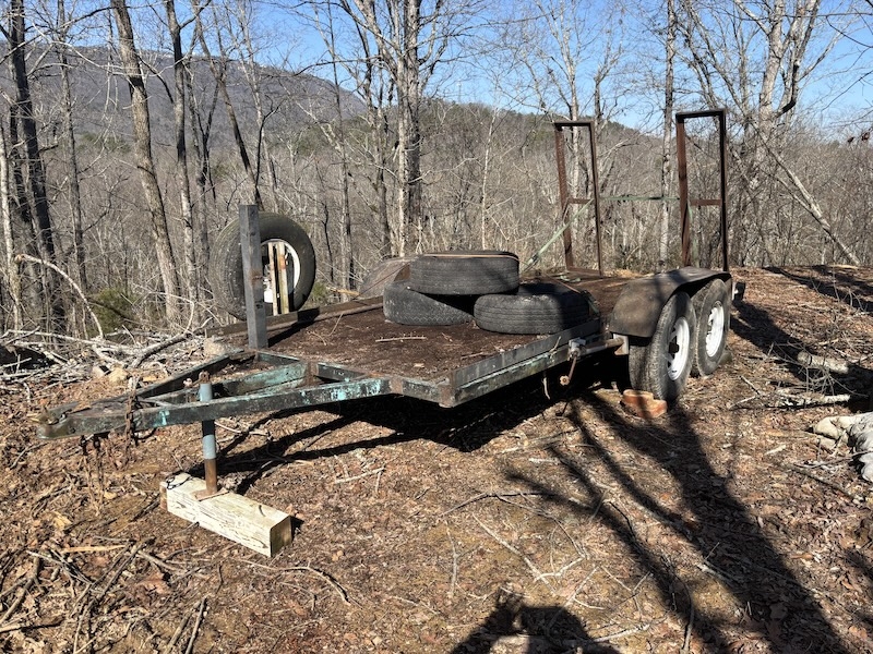

I have been wanting one for a while. WIth the mill I want a way to pickup logs when they come available. Been keep my eye on Marketplace and found this guy. Picked it up for $850, which isn't bad for a stoutly built tandem axle. Needs new wood, some rust remediation and a new coat of paint, some oiling and greasing of jacks but it seems very capable. Need to weld a plate on the front for a winch, box for the front to house batteries and towing gear. Overall pleased with my purchase.
I have access to a scale right next door so I will probably go over there this week to figure out how much it weighs, just so there is no mystery there. Could not find a plate with specs anywhere.
Other than the usual stuff (bearings, lights, etc) what things should I look over. Not much else to it. It does have drums for brakes. Not sure they work as the plug is the old style and I don't have an adapter for that kind yet. Need to see if I can get the brakes working. Any guidance there?

Assuming old style connector is 6 pin small round? If so I would replace it with 7 pin with flat so it can be used with multiple modern tow vehicles. Wife's first horse trailer had old style 6 pin round. Tried using 7 pin to six pin adapter. Due to length of both connectors had a hard time keeping brakes and lights functional on bumpy roads even with a bungee cord. Easy to convert by replacing trailer end. That way you'll also be able to be sure you have nice clean connections at plug end.

How many lugs? Wild guess it’s a 7k trailer, enough you want to get the brakes working. Seeing I paid almost triple that for a new one 15 years ago, and these days I’m sure a new one I closer to $4k than $3k I’d say it’s not a bad buy.

I thought it was a 4 pin round, but I just looked at it really quickly. 4 pins wouldn't make sense if it has brakes right? Yeah, I think I will change it to 7 pin. Need to do more digging on all that.
Good question, didn't look. I will have to take a look at that. But I am assuming a 7k trailer too. As long as I can tow the tractor, that is about the biggest thing I want to tow. Tractor is 5500 pounds with the 1200lb ballast so I think as long as I take that ballast off I will be good.

Keep in mind that 7k includes the weight of the trailer. If the trailer weights more than 1500lbs (which I suspect it does) and you load a 5500lb tractor on it, your overloaded.

I understand that. I said my tractor is 5500 lbs WITH the 1200 lb ballast. So it's actually 4300 lbs. I doubt that trailer is 2700 pounds. But I have a scale at my disposal so there will be no surprises.

My trailer is similar. It was 1600lbs bare. With winch, winch mounting, battery, spare tire, and chains it's probably 1800-1900.
